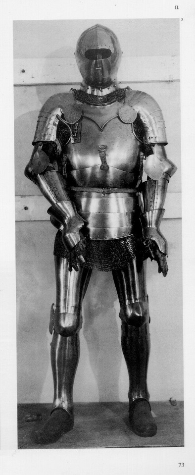

OI originally joined int a league to do full contact outfighting, ala IMCF. OI had very little knowledge of the historical backgrounds, I just knew that I wanted plate armor and a helmet that not commonly saw in the list. I ended up with kind of a hodge-podge suit of plate. OI have transitioned over moire towards HMB. I'm also starting to get interested into doing more historical accurate events.
I need some assistance in tracking down some historical references. I haven't been able to come up with any helpful ones on my own. With that said, I don't think I need to make any adjustments to my general harness (arms, legs, & cuirass). I have dated my pauldrons to 1450-ish and sallet to 1480-90. I'm positive the sallet is going to be too late for the rest my harness. I'm willing to get a new helm and pauldrons to make a historical, yet sport legal, full plate suit.
Don't beat me up over any nuances. I need to get where I want to be, that's why I'm asking for your help. My only request is that the helm NOT be a hounscull, pigface, etc. Grand bascinets are fine, but I'd like to have something that can maintain head movement.
Attachment: 85.71 KB
This is my sallet reference
Attachment: 221.77 KB
This is my current kit, sans helmet [ Download ]
Attachment: 127.65 KB
This is the Churburg reference (with now known later pauldrons) [ Download ]

To go down a more historic route though, I think you really need to pinpoint where you're going with this kit. What you've got is all typical italian, so that's a start, but I think you really need to narrow down the time period to a ten year window, eg 1430-1440 and stick to that quite tightly.
Before investing in any more plate I would suggest getting some new under garments. A thinner and more accurate arming doublet, and ditch the padded hose in favour of regular joined hose.
Next I'd be adding some mail. A skirt for sure, and there are various options for the upper body in the early 15th C, but at least some gussets for the armpits and inside elbows. Also a standard/collar.
For a helmet, an armet would be the obvious way to go. The Lionardo armet at the Met Museum is dated 1440. https://www.metmuseum.org/art/collection/search/24686

Roughly, I have been shooting for a 25 year window, but the more narrow the better. I have been shooting for 1410-1435. It is an Italian kit, but I need pauldrons and a helm to match.
I have plans to get maille voiders and a skirt. They won't be useful in buhurt, but I want the authenticity of the maille for faires and demos. I have been looking at going to a doublet and chosen. I think the chausses are restrictive.
I like the armet, but I have been looking at some grand bascinets for buhurt. Armets are built for mounted combat and the kit is used in foot combat.
