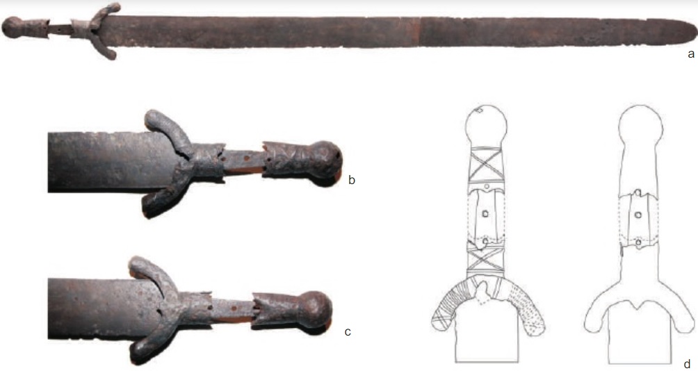

Since most of us are less familiar with Eastern medieval weapons, I thought I'd include a photo of a sword from Georgia. It's full length is 102.2 cm. The hilt is 14.3 cm. In its current condition, the weight of this sword is 969 grams. Tsurtsumia argues that the based upon the cross style, this sword is most likely from the end of the 11th century, and the beginning of the 12th century- quite possibly coinciding with the rule of Georgian hero, David IV "the Builder".
