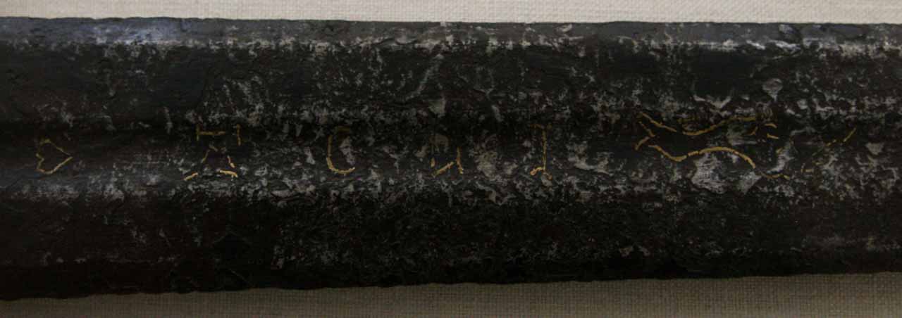

Ryan Renfro
Posted: Wed 27 Mar, 2019 10:10 pm Post subject: |
Here is the engraving on Records XIIIa. 9.
Attachment: 63.59 KB
