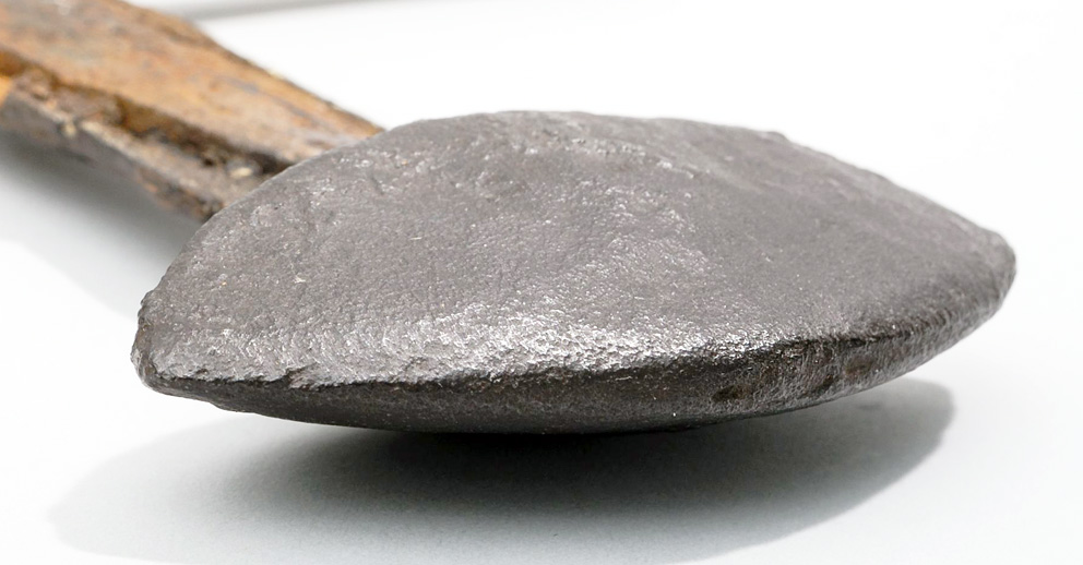

Maciej K.
Location: Poland
Joined: 06 Jul 2006
Posts: 242
PostPosted: Wed 27 Feb, 2019 9:14 am    Post subject:         Reply with quote
It is not a rule, but for the most of them we will not see it.
check attachment please. that one is from MAAS, Australia, ca. 1050.
... and they mostly look like this.
 Attachment: 135.35 KB
Medieval Swords - www.artofswordmaking.com
Kai Lawson
Joined: 26 Aug 2010
Posts: 589
PostPosted: Wed 27 Feb, 2019 8:09 pm    Post subject:         Reply with quote
That’s a lovely pommel! Thank you for sharing that.

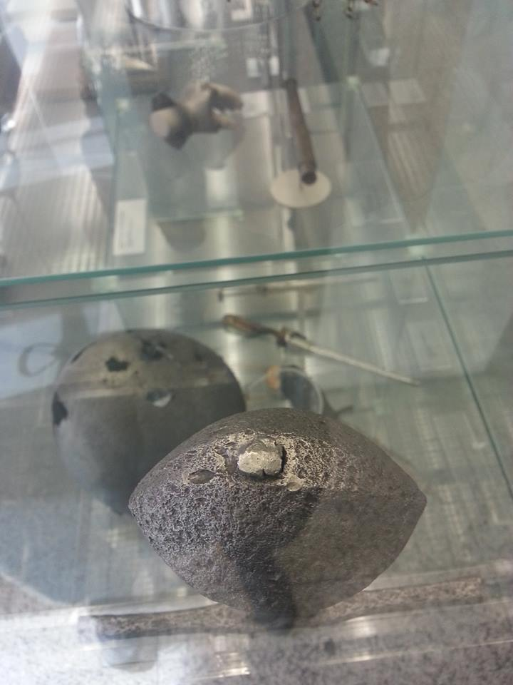

Craig Peters
PostPosted: Thu 28 Feb, 2019 11:13 pm    Post subject:         Reply with quote
Jeremy,
Here's a photo I took of a sword kept in the Germanisches Nationalmuseum in Nürnberg. You can see that the peen is not entirely flush, and the seam is visible.
 Attachment: 917.01 KB
Jeremy V. Krause
Location: Buffalo, NY.
Joined: 20 Oct 2003
Posts: 1,717
PostPosted: Fri 01 Mar, 2019 7:18 am    Post subject:         Reply with quote
Thanks Craig,
So on the photo we see an example with a more visible seem so the finishing to the point of near invisibility must not be the hard and fast rule.
Thanks!
