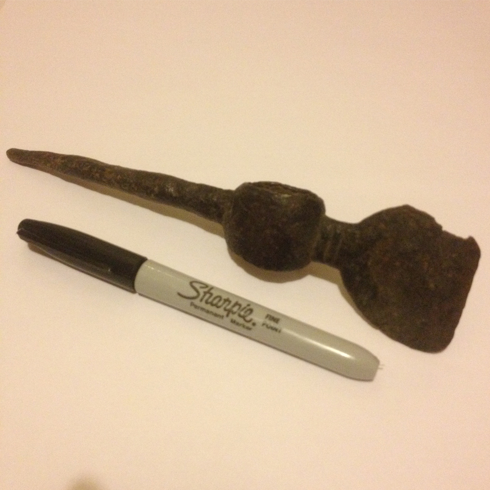

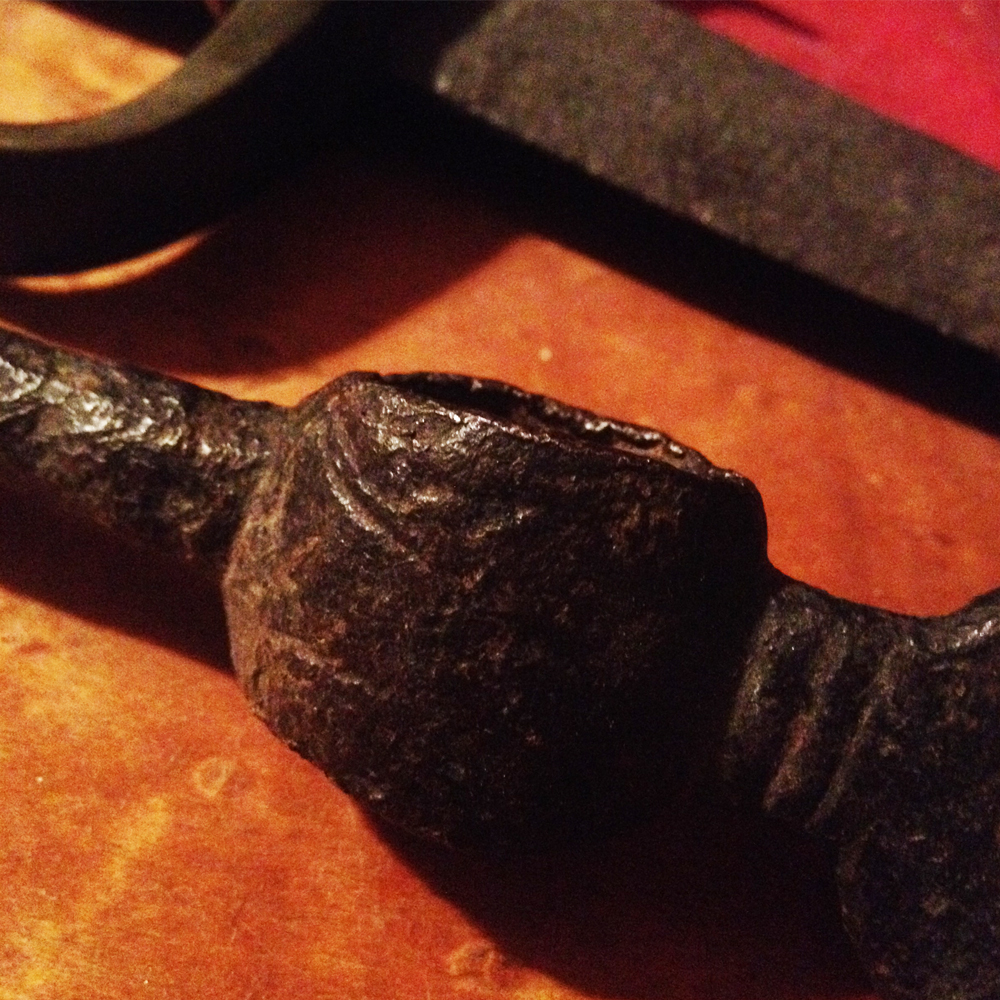

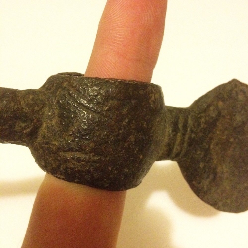

Purchased this one about 10 years ago and was told it was dug in the Balkans and is in the realm of 1000 years old... Similar to some shepherds axes from the region but have not seen one in this same configuration. Seems to me to be a weapon rather than a tool. One side is heavily pitted, and the other bears decorative engravings on the socket and cheek. Definitely a vicious little thing. Any ideas?

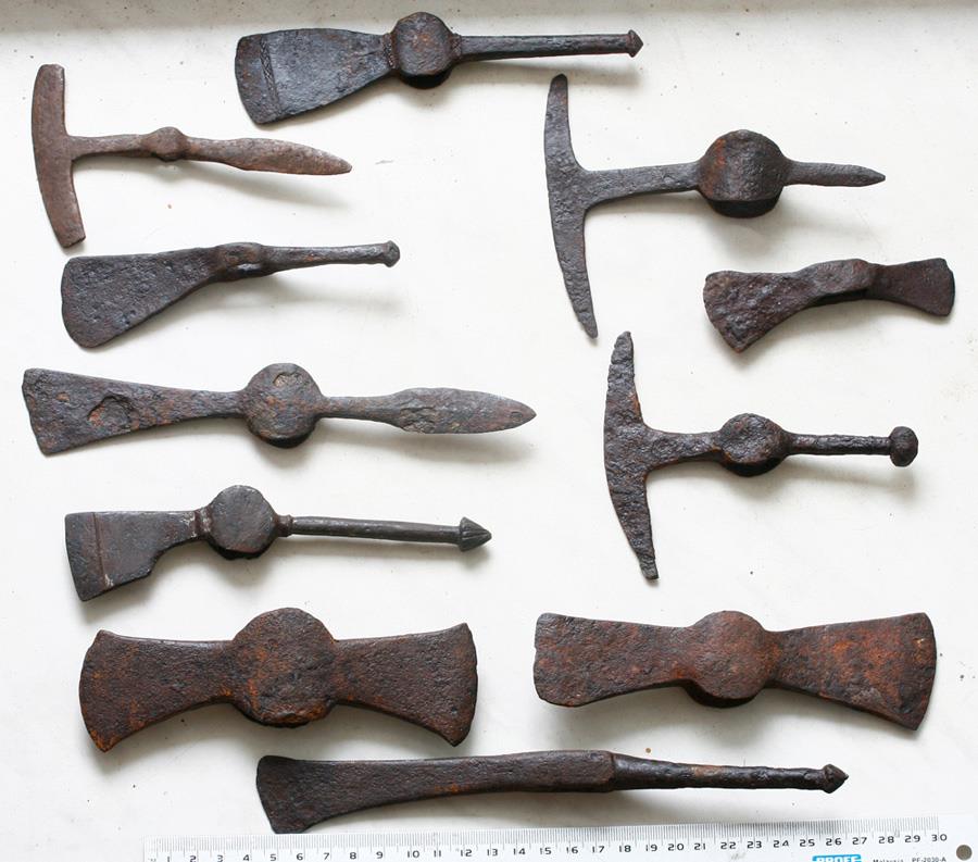

Hello. as ussual nothing that mysterious . Search for khazar axes and tzikourions(or russian translations of theese). if you are more to hammers than search for akufion (there is unsolved ambiguity with that word yet.). Theese nations use theese axes/hammers/whatever regulary. I have seen such examples, but i dont download and save everything i see-sorry.
 Attachment: 80 KB
Khazar ones not exactly the same but similar [ Download ]

Thanks a lot, guys! The axes you posted bear a close resemblance, any info on that particular group?

Theese exactly are from caucassus regions from detectorists. They are accepted as "Khazar" ones. If you want more info about this topic you need browse materials about Byzantine empire or Saltovo-Majack ("khazar") culture. Majority of theese soures are however in Russian language. One of few english sources is here. http://www.oocities.org/kaganate/axerus.html
and one picture from museum https://i.pinimg.com/originals/41/10/bd/4110bdc0ddea60bcb6a648035f20b4f4.jpg
