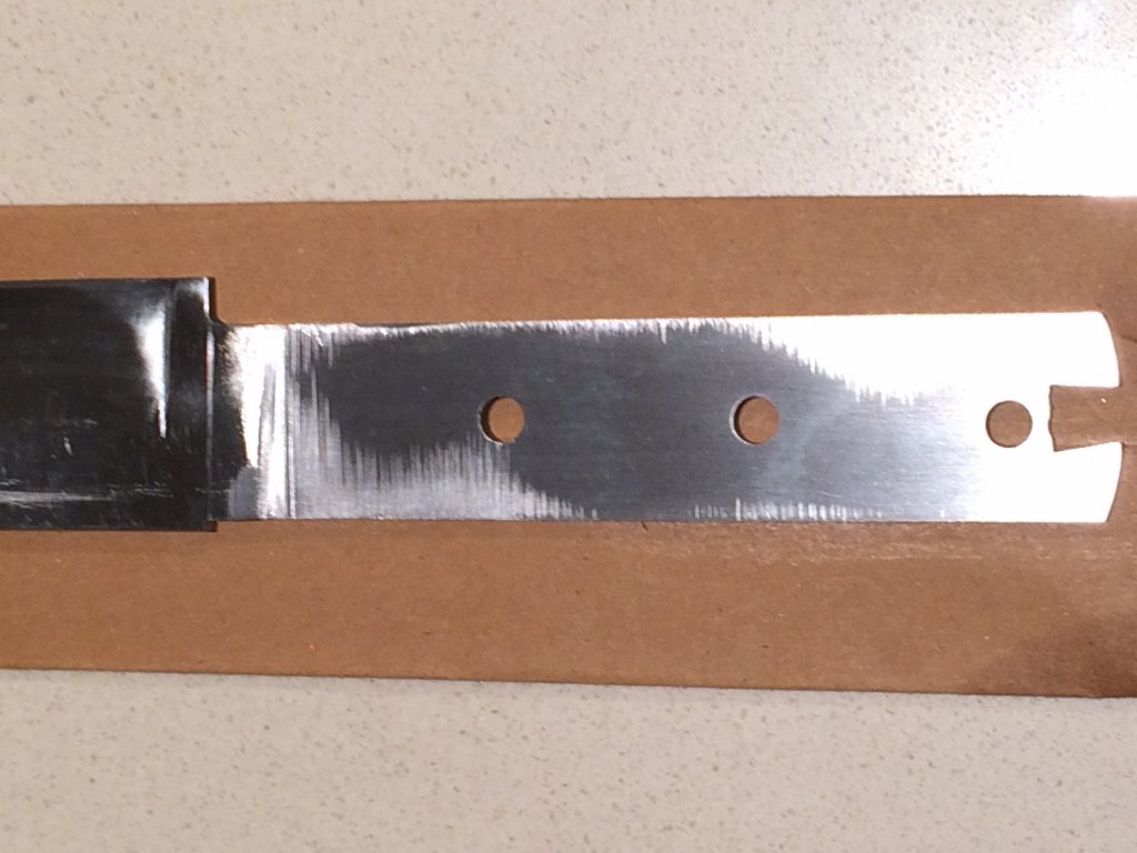

Tried the Cobalt bits in my drill press at lowest speed, and they cut both blades with no fuss. I also found that at least the Rifleman blade can be cut even with my Nicholson files. Not as easy as mild steel, but they do cut and don't get damaged. So these blades are not really "knife hard", they are apparently heat treated more like machete blades (springy but not too hard).
Which is a good thing because I was forced to rework this blade a lot. Maybe I got a lemon, but the way the tang was shaped was just horrible. The blade/tang junction area was both narrower and thinner than the rest of the tang, and what's even worse it is wedge shaped towards the edge. Which of course would make it impossible to fit a slip-on guard. Not to mention the tang wasn't close to true flat, and pin holes were drilled out of perpendicular and not all the way through (1/4" drill fixed that).
So I spent a good chunk of Sunday taking the tang down from about 3/16" to 1/8", while leaving the guard area intact. Which wasn't a trivial undertaking with my little 1" belt grinder, especially keeping it reasonably flat. Also took 1/16" off the back of the tang to create a second shoulder for the guard to sit against, and partially off the front to make it straight. I think what I have now (see attached picture) should allow for fitting a guard more or less tightly, but that will still be a tricky job.
BTW, the cut at the butt is for a short mild steel extension to be fitted and brazed in (to hold a buttcap).
Overall, this is turning into a kind of project my late grandfather used to call "let's make a piece of candy out of this piece of shit". He was of the opinion that any idiot can do a decent job given perfect materials, but making do with whatever crap you happened to be able to get your hands on - that takes real skill. This kind of thing gives you certain satisfaction IF you can pull it off. Will see how it works out with this one.
Alex.
Attachment: 276.51 KB
Alex.

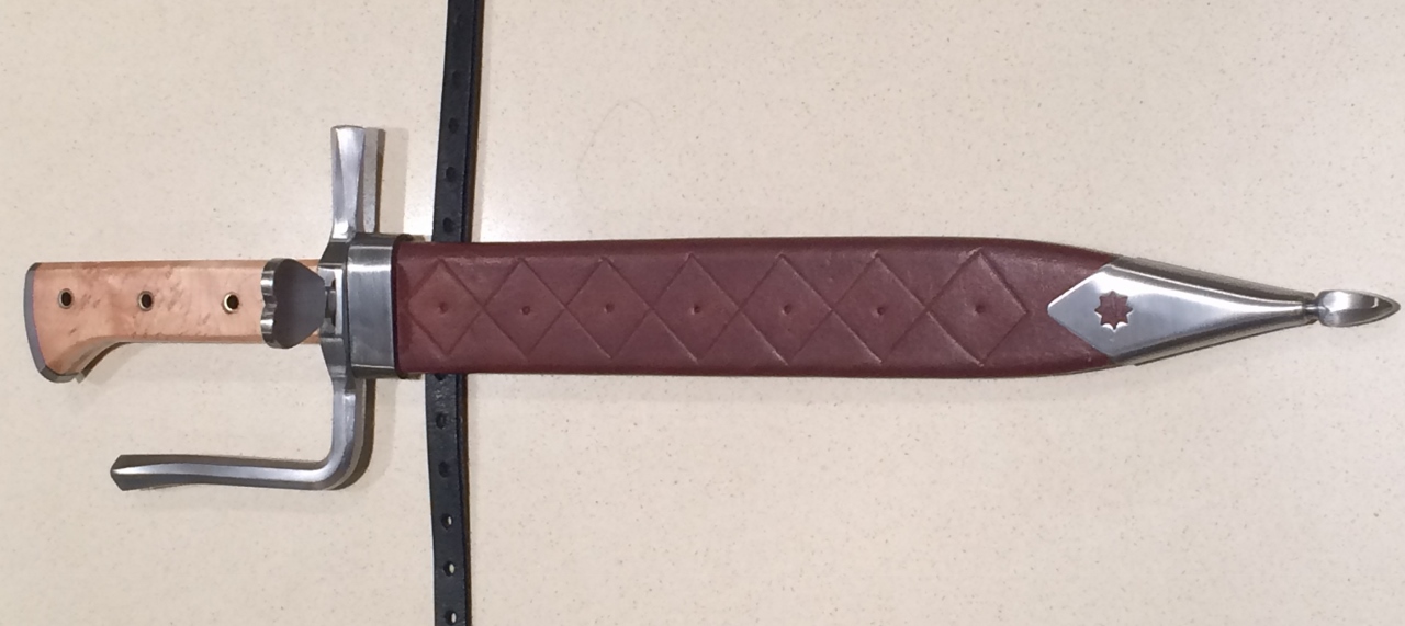

Just finished my project with the Rifleman blade discussed above, posted at http://myArmoury.com/talk/viewtopic.php?p=330194#330194
So, do you think I managed to pull off the "let's make a piece of candy out of this piece of shit" trick here?
Alex.
Attachment: 226.51 KB
Messer in scabbard [ Download ]
Alex.
