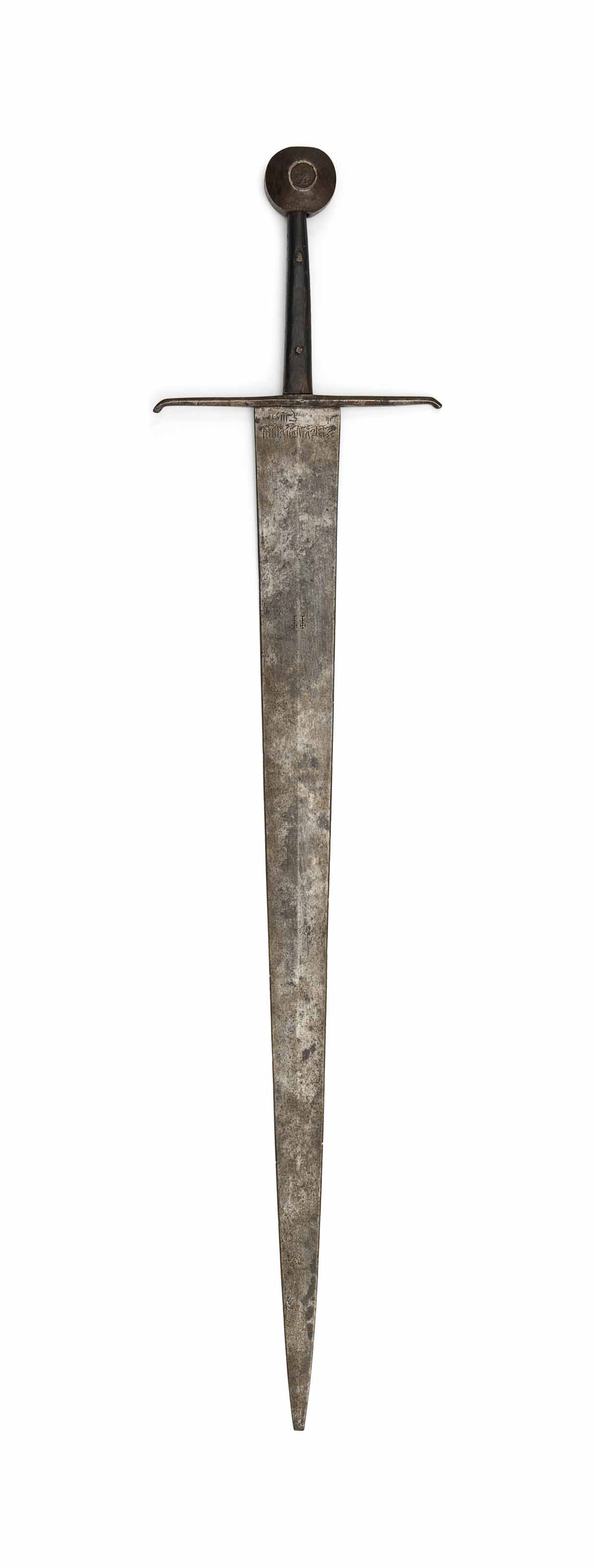

Another previously unlocated Alexandrian XVIIIc has resurfaced at auction! It shares the same maker's mark that appears on the XVIIIc in the Royal Armouries: the letter P surmounted by a cross potent, twice repeated. It looks like this is the sword shown in the lower left in the photo from the Ottoman armoury, distinguished for the maker's mark and the damaged tip of the blade by Clive Thomas in his 2003 article.
https://www.christies.com/lotfinder/lot_details.aspx?intObjectID=6153918&lid=1
Clive Thomas
Location: Warwickshire, United Kingdom Joined: 05 Oct 2006
Posts: 49
Posted: Thu 06 Sep, 2018 4:42 pm Post subject: |
Just to update everyone, I had a very close look at the sword in Mark's post above when it was in the storeroom at Christie's back in February of this year. While it is, without any doubts whatsoever, a superb example of this group, it is most definitely not the sword shown on the lower left in the old photo from the 1880s, even though it looks very similar.
It wasn't completely unknown either, although my attention was only drawn to it in mid-2017. It appeared at a Graf Klenau auction on 16th June 1973, Lot 5070, and had been in a private collection in Germany until recently.
Of course, this still means that the one in the old photograph is still 'out there' somewhere, along with several others that have not yet been fully accounted-for!
