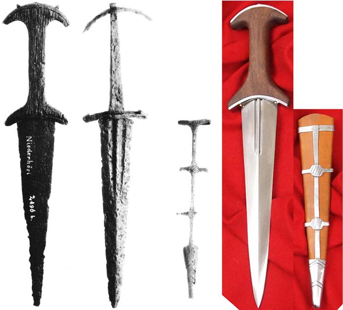

Posted: Mon 18 Dec, 2017 5:10 am Post subject: |
There are Swiss daggers from the late 13th century, they don't look much like the later Holbein daggers, though. They look more like this:
This is a composite image of pieces I used as inspiration for a custom commission from A&A. The pieces date from the late 13th-early14th centuries. The Swiss Landesmuseum has a bunch of these kind of daggers from this era.

Posted: Mon 18 Dec, 2017 12:18 pm Post subject: |
Thanks so much Chad. I’ve run across some similar to these that all seemed to be mid-14th century. Glad to know there are some that are indeed older.
