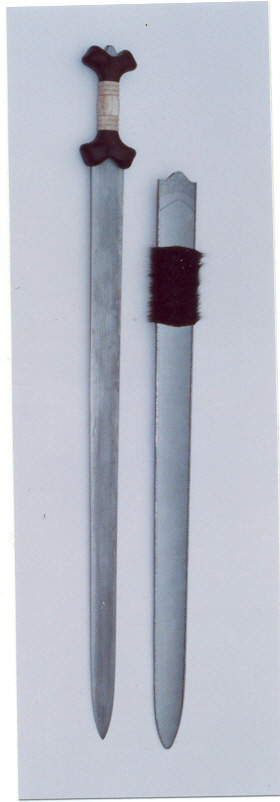

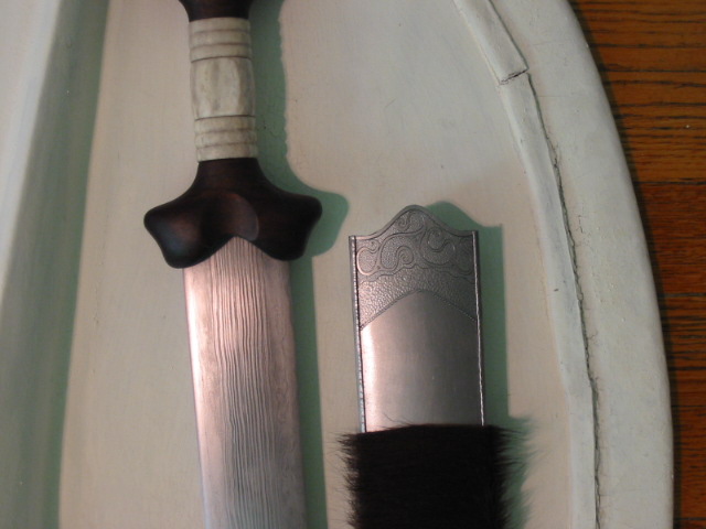

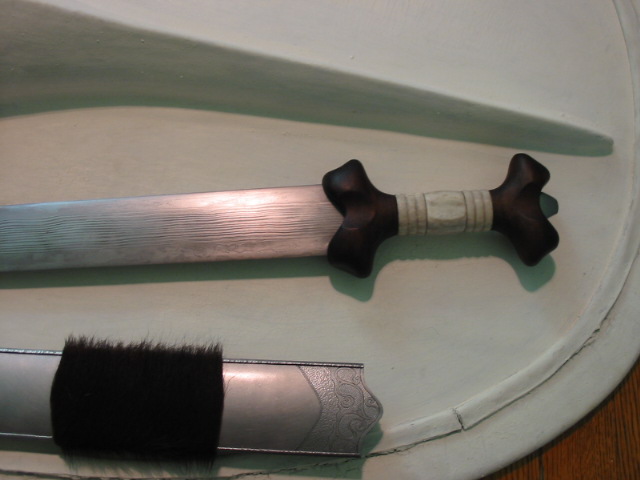

To add to Kirk's post and to fill in those who have not read Pleiner,
The incidence of having only 1 edge in steel appeared to Pleiner to occur mainly in the region of Czechoslovakia, with welded on steel edges on both sides being more common elsewhere. It also seems to Pleiner that sometimes the Celtic smiths did not appear to always know the effect of their blending, although at times they did have clear design and intent. AS Lang summarizes in her study of Roman sword mettallography, the "celtic" blades appear (generally) to increase in quality as one moves from earlier to later La Tene. The same did not seem to be a constant with Roamn swords, having good and poor examples both early and late.
Attached are pictures of my piled structure/proto patternwelded blade, showing the piled pattern that tended to appear in the Middle La Tene period. The piece is made by Patrick Barta.
 Attachment: 63.6 KB
 Attachment: 72.26 KB
 Attachment: 93.43 KB

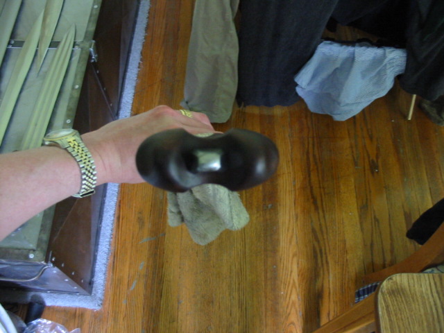

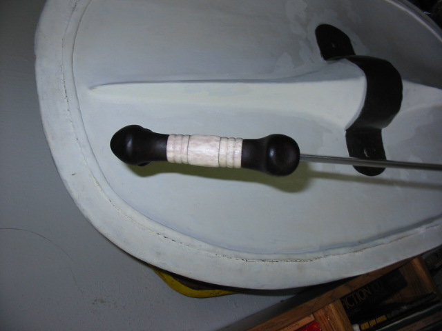

Is there any way I could see the geometry of the hilt from the side?
Thanks
ks
Hi Kirk,
I was actually quite pleased with how Barta interpreted the hilt, especially since I didn't really give him much guidance on the hiltwork shaping. There are a couple things I might have a stateside custom swordsmith tweak a bit, later, but right now it's really hard to let it leave my hands....
Here are the pics. Please ignore the detritus, drying clothes, etc. in the last picture!
Blush
 Attachment: 59.76 KB
side view
 Attachment: 96.79 KB
top view, and divers incidents of clutter within the frame

Thanks Nathan...
That helps me get an idea of the total hilt shape. These types of hilts are so hard to imagine just from a plan view.
Patrick seems to know his swords... I like his intrepretation--it is somewhere between the earlier Anthropoid hilts and the later more gladius/spatha like ones.
I just went through some of my stuff to find images of LaTene hilts that still have organic parts remaining. I will try to post it over on the Peter's "Celtic Swords" thread.
Thanks again for the new perspective.
