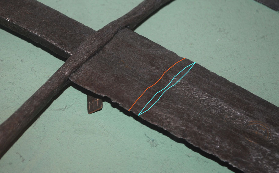

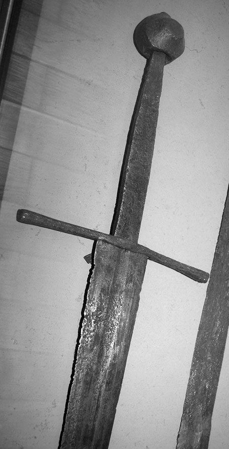

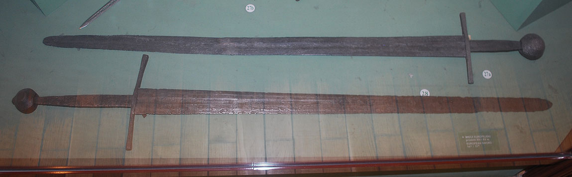

here, I want to show you what sword inspired me to make this one .
the most intereting is the cross-section of the blade - it seems to be related to Passau marked swords mostly and is very common style of profile.
what gives that kind of cross-section? well, as far as I was trying this sword and other similar profiled I can say it provides better stiffness and strength (durability) of the edges. the sharpening is made only on last 5-8mm from the edge. this gives us thicker area near the edge.
also - the flat area of the blade is actually (and should be) not flat ( sounds funny, I know Happy ) but slightly sloping, with gentle ridge on the center. so, it is not good to make it "just flat" on the whole area Happy this is important - and this is difficult - but provides better parameters.
second point is that this cross-section make the whole sword a bit heavier - and they originally were heavier (mostly between 1500-2200g with length between 113cm and 127cm mostly).
Original sword is 110,9cm long and I have added a few cm to the tip, which is missed in original one.
All other parameters are the same or very close to museum sword.

You are absolutely right Luka - there is a lot of swords with this an similar cross-section of the blade and actually it is normal geometry as best style of sharpening sword edges. even if the it is less visible on other blades - they are also sharpened similar way, I mean this what is on attached files...
Guillaume - thank you for your comment. I was also not convinced to this type of cross-section - but after some research I think they knew what they need - and that why designed this Happy From the first look it seems to be flat and easy to recreate... that is wrong judgment if you try to make it - everything is more clear and then the maker will appreciate more medieval craftsmenship. The point is they designed this for hard battle against armoured enemies, when edge must be durable and strong enough. Also these swords are heavier - and this is good featue, provides strong hit / cut / thrust.
I bet you`ll love it after a quick try Happy

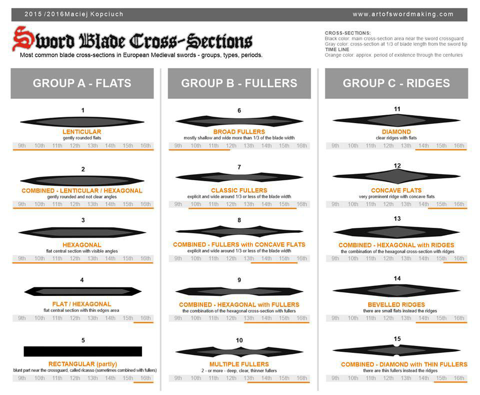

Thank you! it is important to know what we do - and WHY swords was made this way Happy
I believe that answer to "WHY?" is more important than answer to "HOW?" Important especially when we are talking about recreation of medieval swords and other historical objects.
that why the Research and Sources are so important - distinguishes the Artist from the ordinary businessman...
I`m always happy to draw your attention to some details which make medieval swords such sophisticated weapon.
In fact - every sword has it`s own specifications, worth a separate essay Happy
Here, I also attache my clasification of most important cross-sections of medieval swords... can be useful I hope.
