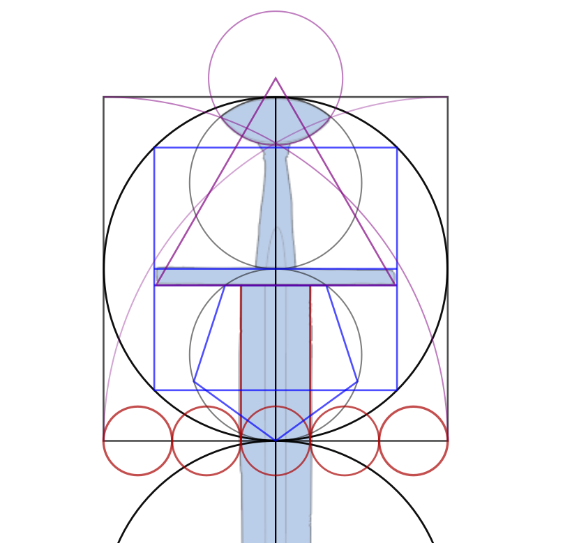

With rapiers we have a situation where many today are not mounted with their original blades.
I also have a suspicion that hilts may more often have been designed as a separate thing from the blade during this period. -Less a complete wholeness of things as was the case with high medieval swords.
However, I do find rapiers conforming to geometric structures in many cases. Again, it seems to be Italian weapons that do not as readily follow this rule. I post again an image showing two rapiers following similar geometries that was posted by me earlier on in this thread.
I have several more that are as of yet unpublished (hoping to do so in the future).
The geometry of rapier(-hilts) tend to be more complex tun that of simple cruciform swords. There are more parts involved... Therefore the geometry is by itself not as convincing. However, if you look closer you will see that it is the same strategies used for medieval cruciform swords, but repeated to define the greater number of elements.
The one written support I have for the use of geometry in the design of swords come from the year 1633 in the play "The Weeding of Covent Garden" by Richard Brome, where "the Father" tells "his Son" to get himself a proper sword (instead of the sorry excuse of a weapon he now as), saying: "buy you a good one, one with the mathematical hilt, as they term it."
This may be a late trace of a very old tradition....
Yes, to some extent or another that seems to have been the case pre-17th c. but the trend gets stronger as you move forward in time. The funny thing is there was still a sense of scaling the weapon to the wielder up until very recently. For instance a fencer's height would suggest a particular blade length and there was an ideal handle length based on the fencer's individual grip. This is probably a continuation of an ancient tradition as it appears to fit many Medieval swords, too.
I'd believe that. It's possible to divide the majority of Western swords into two big branches, double edged and single edged. At the risk of upsetting some enthusiasts we could call the first "swords" and the second "sabers." The small sword is at the very far end of the timeline and may not have a cutting edge at all but deep down in its core it's a sword, a descendant of the gaddhjalt, as such there's a cruciform sword in there somewhere... there's just a couple centuries of specialization and additional structures obscuring that fact from the casual observer. Moving even further forward on the timeline the same is true of its descendant, the epee du combat. When viewed from the side its deep cup guard becomes a thick cross and early versions with flatter guards bear an even stronger resemblance.
It's possible but there was a huge philosophical movement about swirling around math and numbers during this era that's separate from the proportional design we're talking about. This is also when they started abandoning the traditional colorful and descriptive nouns used to name techniques like "ochs" or pflug" with high tech numbers like 5 and 3.
As I said earlier I don't know circles and angles from anything and as you said it's much better to work with measurements directly from original swords than pictures so just for fun I'd like to encourage you to keep an eye out for longswords that are 3 parts blade, one part hilt with a cross 1/5 the length of the entire sword. Off the top of my head other numbers to watch for on 14th-16th c. central European swords would be 3,4,5,8,12, 17 as well as funny plays off these numbers like 3x8=24, etc.

Okay, I think I've got Inkscape under control enough... I have a submission for A457!
I went for the simplest shapes I could find. I'm spotting weaknesses in my interpretation already, but I'm going to call it done.
Blade/hilt divison 1:7 of the small circles
Blade width is 1/5th of the large circle
Guard width is *almost kind of, if you squint* a square inscribed in the large circle
Guard thickness comes from a pentagon inscribed in the second small circle
Centre of the pommel circle is the apex of equilateral triangle built from the lower guard line (this step I think is weak, being a "second-degree construction"?).
The radius of the pommel intersects the diagonal arcs of the large square, and the first small circle.
 Attachment: 116.69 KB
