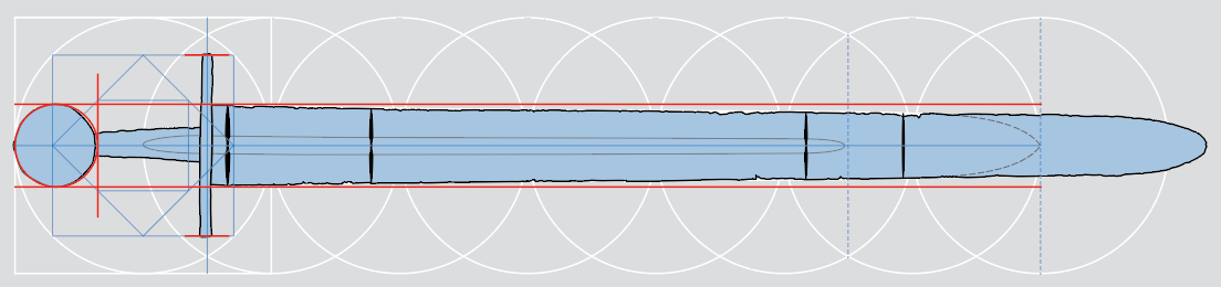

A possible example of the consequence of geometry deciding the proportions of the outline of a sword and how it has to be forged to meet those proportions can be seen in the well known Oakeshott XIII.4 sword.
This was a sword that Oakeshott published in his "Records" but that for a number of years disappeared into unknown location as part of one or several private collections.
It emerged again recently and was part of the exhibition "The Sword - Form & Thought" in Solingen that I helped curate.
When it came to light again, it had met a strange fate. Oakeshott gave an incorrect number for the length of the blade, but also make a drawing of what it looked like when he saw it.
It turns out that some collector saw fit to add a length to the blade to make it meet the dimension given by Oakeshott (some 14 cm longer than actual original length). This is clearly visible in x-ray, where the new tip has been welded on.
In the illustration you can see how the sword with its original length neatly fit a simple geometric structure, but also how it in its new lengthened form, fails to meet any geometry in a satisfying way.
If you just look at the sword it might come across as odd and perhaps even ungainly in its proportions, but knowing the underlying geometry you can appreciate that there is an original sense of beauty that defines it.
To make it possible for the pommel to be as large as the geometry sets out, it is made very thin. It is nearly 7 cm wide, but only 1 cm thick. If you take two digestive biscuits together they will be thicker in proportion to their diameter than this pommel is.
I think this may well be a result of a design defined by geometry that results in some creative and original solutions by the sword smith.

Guillaume Vauthier wrote:
Experimenting again on paper, with ruler and compass.
I like the second one in particular. Happy

Luka Borscak wrote:
I would love to see analysis of A.459. Happy
In the meantime I've gone back to look at A459 and here is the result. The hilt-blade ratio is very close to 1:5, but using a type 2 structure to derive this seemed to offer more than a simple type 1. The design came together with a pretty minimal number of needed constructions. The pommel is not defined in a really solid way, but it's a very irregular shape, so I don't feel like this is a serious shortcoming...
Luka Borscak
Location: Croatia
Joined: 11 Jun 2007
Posts: 2,307
PostPosted: Thu 12 Jan, 2017 1:40 pm    Post subject:         Reply with quote
Thank you! Elegant geometric solution...
