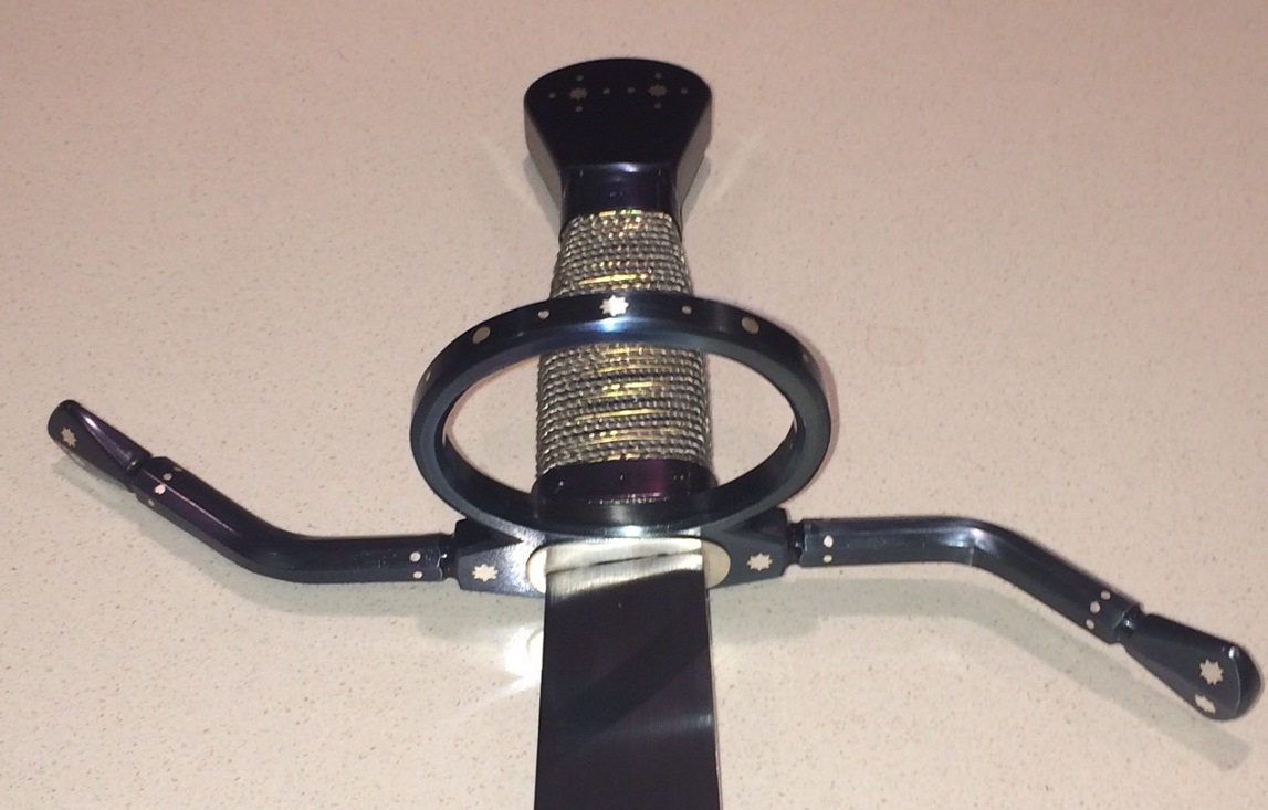

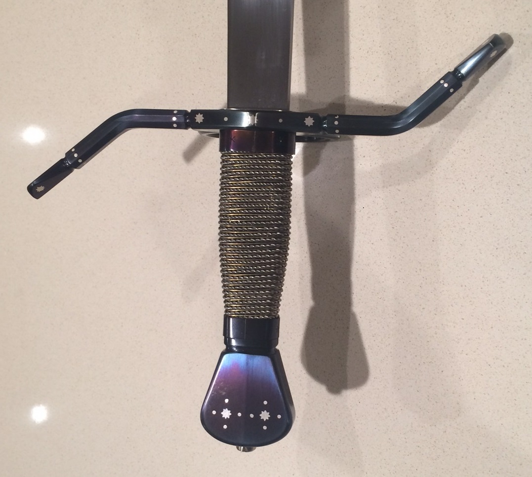

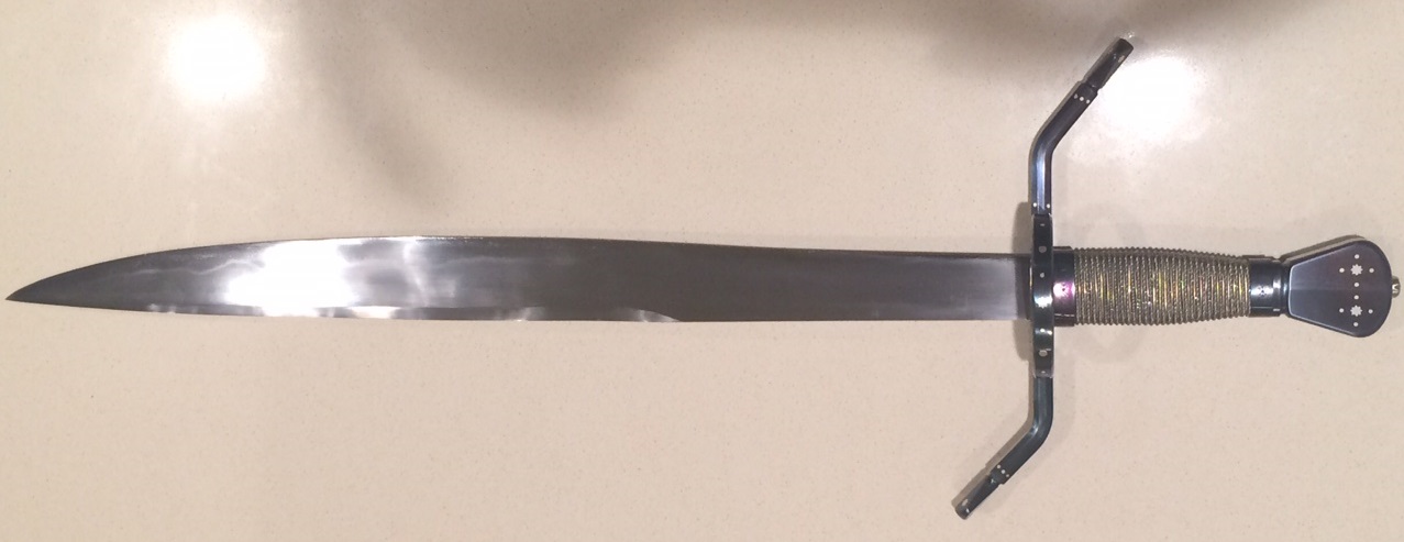

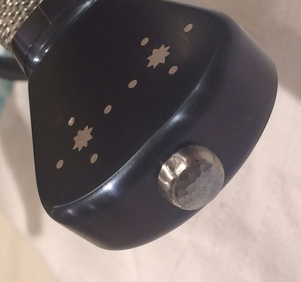

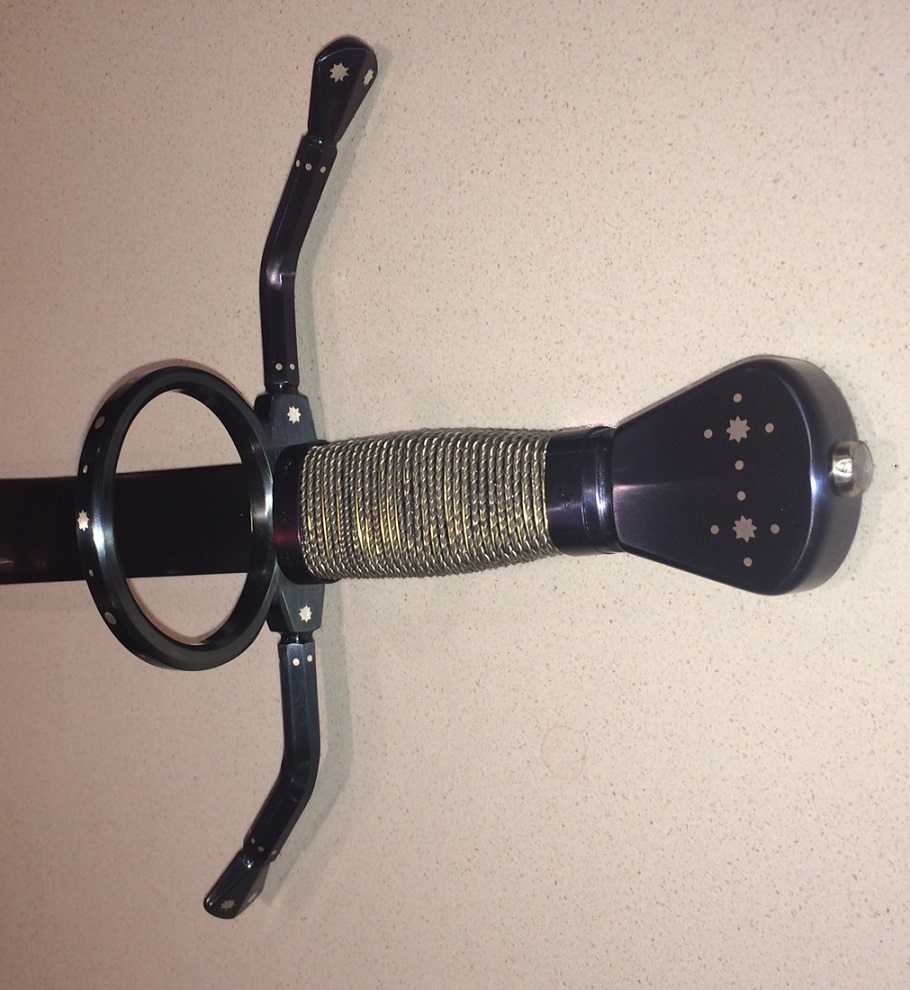

Hi guys,
Showing off my last hobby project, been in the works for a couple of year with interruptions. The sword is finally finished, just the scabbard left to be completed.
See the attached pictures.
The blade I used is Kris Cutlery’s Pinuti II (not produced anymore). I like KC blades in general and used them for many of my project over the years. They are affordable but perfectly functional, good well heat treated steel.
I consider Pinuti as just about the perfect blade shape/size for a short cut and thrust sword, so used it even though it isn’t exactly historically correct. I made an XVIIIc hanger/hunting sword with the original Pinuti blade about 5 years ago, and for this project got the next iteration of the blade, which actually has two advantages from my point of view: made of simple 1060 carbon steel (more period than the original’s 5160) and thicker blade.
The only problem with these blades is tang: it is relatively short, originally just epoxied into the wooden handle. So to use traditional peened handle/pommel construction, I had to extend it with a piece of mild steel. I did it with a very tight (hammered in) T shaped joint, and brass braised. No way it can be pulled out, and stood the stress of peening the tang just fine. The joint is under the handle, about an inch from pommel. So it can’t be laterally bent either, not without breaking the handle first.
The blade stats: 20” long, 5/16” thick at the guard (with strong distal taper), a little over 1 1/8” at the guard and 1 5/8” at the widest belly.
Balance point is about 2 ¾” in front of the guard, even with the solid steel guard/pommel. It is a pretty heavy little beast (unfortunately I don’t have suitable scale to weigh it). But still, very much maneuverable, thanks to just 20” of blade.
All fittings (guard, pommel, handle collars) are 1018 mild steel, heat blued, with fine silver inlays. Color and contrast came out better than I expected, much nicer than my pictures can show.
Handle is wood (poplar) core, wrapped with two wire strands (plain “gold” and twisted “silver”).
There is a nickel silver washer between guard and blade (couldn’t fit the guard without some unsightly gaps).
Peen block also of nickel silver, decorated with 4 round cuts on the sides.
Any thoughts/questions?
BTW, I am still researching design for the scabbard, going to start a separate topic on that.
Thanks.
Alex.
 Attachment: 139.61 KB
 Attachment: 106.74 KB
 Attachment: 239.7 KB
 Attachment: 180.8 KB
 Attachment: 123.91 KB

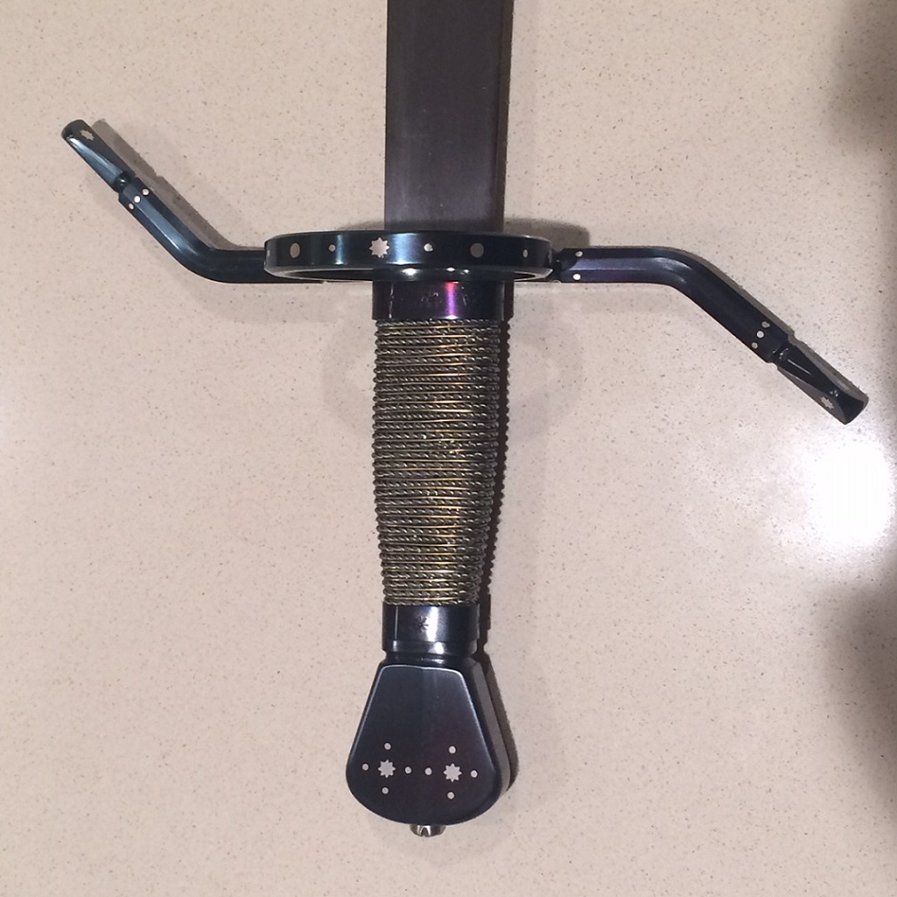

And a couple more pictures of the handle, front and back (can see hairline solder joints on the handle collars on the back side, can't figure out how to make them invisible).
Alex.
 Attachment: 234.47 KB
 Attachment: 234.37 KB

PostPosted: Thu 06 Oct, 2016 1:23 pm    Post subject:         Reply with quote
Lovely work!
The only criticism I have is that the bend in the quillons seems a bit mechanical. If it was a bit more curved along the length of the quillons, it would be more suitable.
Apart from that, wonderful job. Great idea on using the Pinuti blade.
Alex Indman
Location: NYC
Joined: 13 Sep 2012
Posts: 186
PostPosted: Thu 06 Oct, 2016 1:59 pm    Post subject:         Reply with quote
Jeffrey,
funny thing is that I actually planned to make the bend evenly curved, just as you said. However, when I finished filing and sanding the guard and tried to bend the quillons, I found that I just couldn't do it. Bending 3/8" octagonal steel rod within just 2.5" length required so much force that I wasn't able to do it in a controlled manner. The most I worked with before was 1/4" round steel quillons, and that I could slowly bend over rounded wooden pads while held in my vise. With this one, wood pads just disintegrated before any bending happened. And my vise/bench were not big and rigid enough anyway to stand to the kind of pounding needed. So I ended up cobbling together some steel and copper pads and positioning them in the vise to bend quillons by squeezing. And even then I barely managed to bend them in the middle at all, forget about any controlled curves!
I guess the only way to produce nice curves would be to heat it red hot and actually forge to shape. But that would of course destroy the octagonal cross section of the quillons, so I decided not to go that way.
Alex.

Hi Alex,
Nice project. A bright heat on the guard to bend it as described would not ruin the file work. You would have to use care not to twist it as you bent it. By using a flat faced wood mallet you could avoid marring the work. The heat would leave a little texture to the finished piece. That might be desireable, if not a quick sanding would eliminate it.
-Adair
Alex Indman
Location: NYC
Joined: 13 Sep 2012
Posts: 186
PostPosted: Fri 07 Oct, 2016 1:24 pm    Post subject:         Reply with quote
Adair,
this would be a tricky proposition, for me at least. I don't have a forge, just a little oxygen-MAPP torch, no anvil, not even a really rock solid vise, and no experience with hot working steel. Plus at the point I realized my problem, the silver inlay was already in. I imagine I would have to heat just the place of bend locally, try to bend a little while keeping it hot enough, then move the heated area just a bit and try to bend some more, and so on.
I may try this on a scrap piece for possible use in some later project, but this time I decided not to risk ruining an almost finished piece.
More likely in future projects I will just keep the thickness of my steel quillons under 1/4", if they are to be bent.
Thanks.
Alex.

Alex,
I did not intend to suggest that you revisit this. You've made a lovely piece. I just thought I would correct an assumption for future reference or for the benefit of others. Heat won't completely eliminate the challenges of varying cross-sections, but it will do wonders compared to cold working. Many often fail to consider that working hot steel over wood gives sufficient control to bend and shape while minimizing the risk of marring.
-Adair

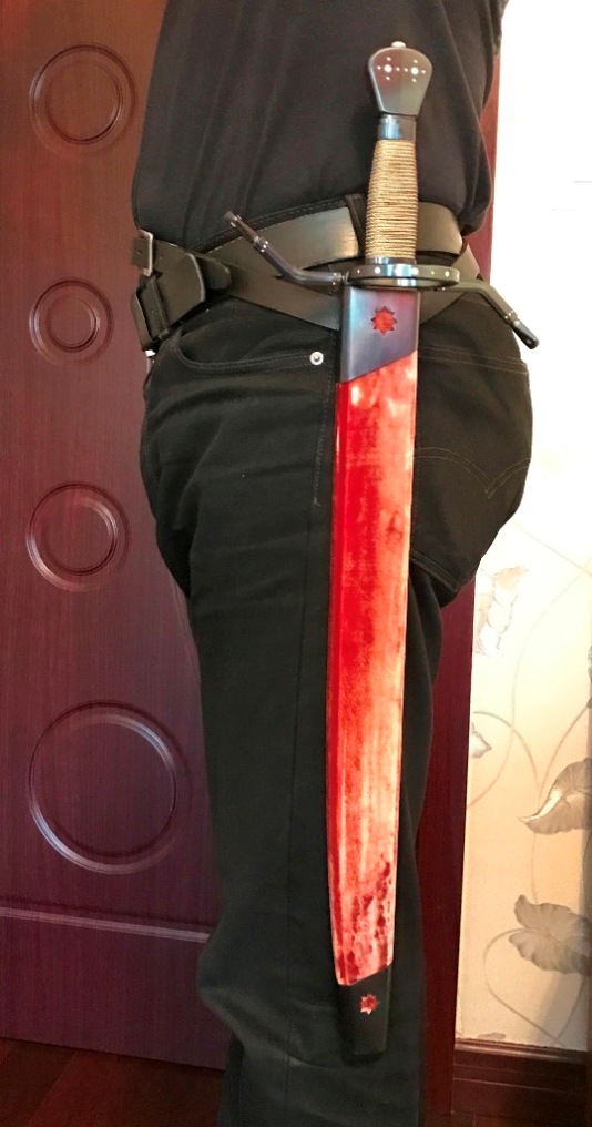

PostPosted: Tue 15 Nov, 2016 12:04 pm    Post subject:         Reply with quote
An update - I completed the scabbard, so the project is finally done!
See the attached picture for the whole package being worn.
And there is this thread with more pictures of the scabbard, and a little discussion of historical examples:
http://myArmoury.com/talk/viewtopic.php?p=316003#316003
Alex.
 Attachment: 128.13 KB

PostPosted: Fri 25 Nov, 2016 9:21 pm    Post subject:         Reply with quote
I'm curious about the inlays in the blackened steel. What material did you use?
K. Robert
Location: Poland
Joined: 06 Aug 2016
Posts: 56
PostPosted: Sat 26 Nov, 2016 4:00 am    Post subject: Re: XVI century Italian style falchion/storta – DIY project         Reply with quote
He mentioned silver Happy
Alex Indman
Location: NYC
Joined: 13 Sep 2012
Posts: 186
PostPosted: Mon 28 Nov, 2016 5:44 am    Post subject:         Reply with quote
Yes, I used fine silver. Very soft and malleable material, easy to hammer into inlays. And surprisingly not too expensive, I estimate this project took only about $10 worth of it.
Alex.
