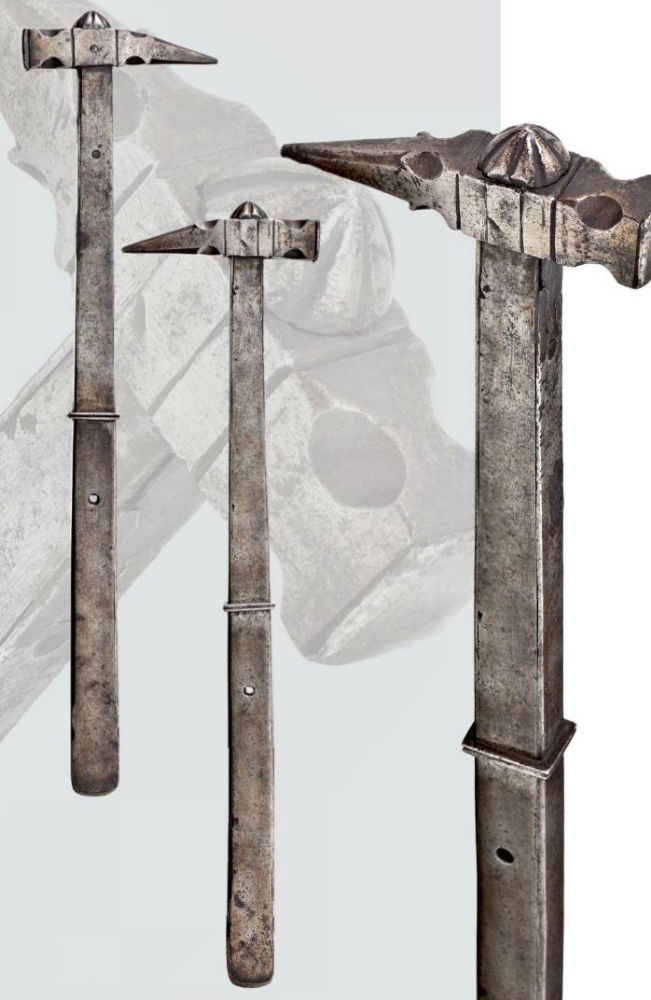

I have found what is alleged to be a 15th-17th century Bec de Corbin for sale. From what I have seen in the pictures, I have my doubts about its age, and I have a feeling it's a 19th or 20th century piece. I'm curious as to what others think.

Couldn't comment on age, but the angle of the claws looks like they would spread if they hit a helm, and so this to me looks suspect.

Yep. Teeth of the hammer head look all wrong. Too long and thin. And like said, the angle looks bad too.

Looks like it's modeled after this, then buried in the back yard or left on the patio for a couple of years. No side spike - can't really call it a belt hook, given the angle. This one purports to be 19th century or earlier - maybe a Victorian fantasy piece?

A very expensive fake in my opinion.

It is probably a modern repro made in India, not even 10 years old. I see lots of similar arms posted on ebay firsthand by suppliers from India, not claiming them to be old, but the description is vague. Once it changes hands, everything is possible.

I'm not prepared to speak as to the origin or age of anything I stumble across in a photograph (here or anywhere else), and I realize that caution and suspicion are excellent policies when in the market for antiquities of any sort. Caveat emptor &cetera. And yet, dismissing it as an outright forgery feels like rushing to judgment.
Some of the details, like the hole in the handle (for securing the warhammer to one's wrist via cord) and what looks like it might be a belt hook (hard to tell through the patina, but the side of the haft shown in close-up presents an edge whereas the other side presents flat--or I could be imagining it; wouldn't be the first time), are uncommon even on good reproductions. A forger would have to really know their stuff and then, for some reason, decide to make an oddball warhammer rather than something more recognizable--and desirable to collectors--such as a sword.
I'm not saying it's not a forgery. It would not be surprising; fakes are common. But if it is, the forger pays enough attention to detail to replicate a peculiar feature or two, but somehow not enough to realize that artifacts from the 15th to 17th century don't have to be thoroughly patinated to pass for the real thing. So I would also not be surprised if it is exactly what it is represented to be.
Just, you know, to take the Devil's side in the matter.
 Attachment: 18.68 KB
From Hermann Historica, not described as historismus.
 Attachment: 24.98 KB
From Hermann Historica, identified as German, 15th century.
 Attachment: 9.06 KB
From Hermann Historica, identified as early 17th century; an example of the type of tongue belt hook that I might--might--be seeing on the wide shot of the patinated hammer in question.
 Attachment: 11.55 KB
From Hermann Historica (I'm assuming based on the background--I can only cram so much information into these file names), with a fancy belt clip and a hole for securing the hammer to the wrist.
 Attachment: 86.2 KB
No idea where this came from, but provides a good view of the hole in the haft. [ Download ]

15th C Horseman's Hammers have a much more robust and compact head (see attached). The one pictured appears to be of a much later style. However, as somone observed, the hammer looks far too weak to be a genuine, practical piece. The fluke is also very slim but might be compared with 17th C Eastern European.
Hope that helps?
