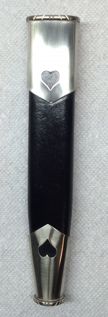

PostPosted: Mon 04 Jan, 2016 3:05 pm    Post subject: Scabbard Done!         Reply with quote
Posting the just finished scabbard.
Not all metal covered like it historically should be, with just a touch of landsknecht styling in the wider fileworked plates top and bottom. Heart cutouts to match the heart shaped guard.
A pic from the back to show how it is set up for almost horizontal (slightly handle up) carry on a belt.
The front picture got displayed as a download link for some reason, just click "download" to see it.
