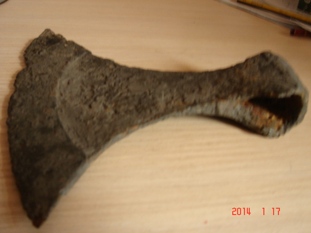

sorry - I meant Birka axe photo. Harby - its like this my replica.

Some viking axes from Kurische Nehrung (now Latvia)

Niels Just Rasmussen
Joined: 03 Sep 2014
Spotlight topics: 15
Posts: 828
PostPosted: Sat 21 Feb, 2015 9:37 am    Post subject: Re: Different types of Viking Axes.         Reply with quote
Thanks for providing the pictures.
Hårby axe is really interesting as transitional axe between Viking and Middle Age time (if it is dated correctly).
Your replica looks really massive (the problem is that we apparently don't have a view of the axe where we can see the thickness of the axe - Dane Axes for instance were very thin, so even with the big axe-blade, the axe would not be very heavy).
If it were this thick I wonder whether it was a development for combat with mail hauberks as more common on the battlefield.
The Latvian axe on the right is really special as being extremely narrow, yet having a very pronounced beard.
You would think the narrowness would almost compromise the strength of the weapon on impacts with harder objects, but perhaps hooking was the main issue and less weight of the axe would make for faster hooks?
We find it intact so it looks to have worked and be useful.
