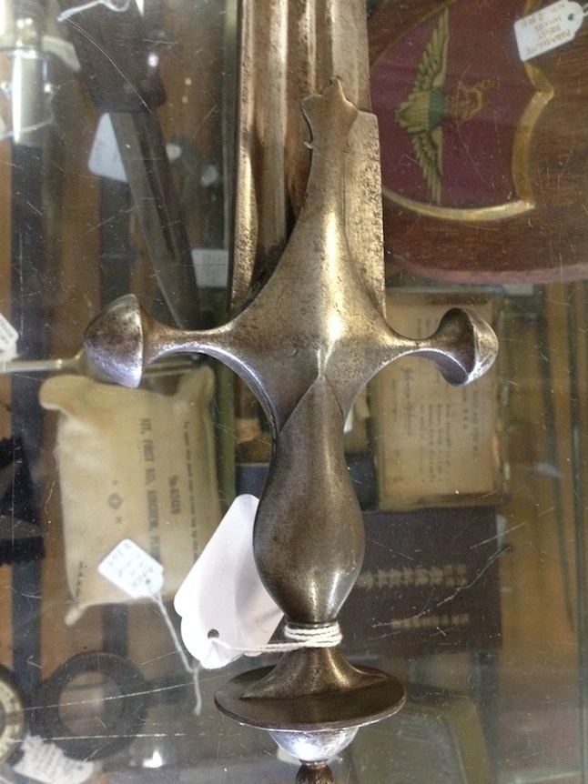

Greetings,
I have an opportunity to purchase what is described as a Persian Blade, antique hand forged c1700.
I would very much appreciate any assistance in authenticating this sword, authenticating its age and possible value.
Look forward to your response and regards
Cliff
 Attachment: 209.4 KB
 Attachment: 218.03 KB
 Attachment: 240.61 KB
 Attachment: 181.85 KB
 Attachment: 219.54 KB

Cliff, the sword looks like an Indian tulwar, you would need to post better images of the blade to see it it is anything other than an ordinary Indian sword blade, does it come with a scabbard?

Thank you for the prompt response, unfortunately, no scabbard and best photos I have for now. What does it mean if it is an Indian Tulwar?

Basically, it just means that it's likely Indian rather than Persian. Different style, different history and place of origin. Functionally all but identical (for what that matters with antiques). Happy
At least based on the photos it doesn't scream modern tourist replica to me, so I'd say tentatively it looks good on a first glance.

Cliff, the hilt is certainly not Persian, the blade could be as Indian swords do use blades from other cultures, it would take a closer examination by someone who has some knowledge of Indian and Persian blades to tell. Since it has the hilt of an Indian tulwar it would be considered to be a tulwar by collectors. It does look like an authentic antique.

Possibly Indian, possibly Afghanistan, It looks like mine that I have bought in Afghanistan. I have owned about 10 of these, I am down to seven now,

I would also say 1800s rather than 1700s,

There's really a lot of old tulwars floating around. Most aren't terribly old either, but there's honestly no way of telling unless they're assessed by a professional or there's a date (that hasn't been added after the fact to give it "authenticity") on it. Really, unless it's coming from a creditable auction site or retailer like Oriental Arms, just consider it "probably antique". Most of these are 1800's or so. The fancier, more decorated ones tend to be older (and more expensive).
For example if you get on Ebay you can find tulwars looking about like yours for as low as $200... even bundles of them.
Best advice? If you like it and can get it for a fair price-- go for it and enjoy Happy

I was under the impression that one of the defining characteristics of the Afghanistan pulwar was downturned quillons on the hilt.

not always, I have couple of these too, they are fairly rare in Afghanistan.
You also have to keep in mind that Afghanistan, Pakistan and western India as political regions or States are a fairly new concept, culturally the lines are very blurred

Yeah, given the crossroads that was the general area of Afghanistan/Pakistan/Western India, it would be absolutely no wonder to find plenty of variety in the blades carried there. However, the pulwar is definitely a 'trademark' of warriors from Afghanistan and Pakistan in any number of photos.

Thankyou everyone for your very informative responses, this is much appreciated. We also have traveled India and have seen many such swords, so it both intrigues and frustrates me when the term "Persian" is so loosely used.

Cliff, perhaps he meant "Indo-Persian", that term would apply.

The tulwar is often designated as an Indo-Persian sword rather than Persian. When kings ruled Persia the only sword they carry was the shamshir, not the tulwar.

But Persian made blades were exported to other countries, the seller specifically has it tagged as a "antique handforged Persian blade c 1700" and not a "Persian sword" which is confusing. I would guess that the blade may actually be an old European blade which were used quite often in Indian swords.

It has been my experience that most antique dealers do not know anything about swords, probably just a miss labeling based on a quick google search
