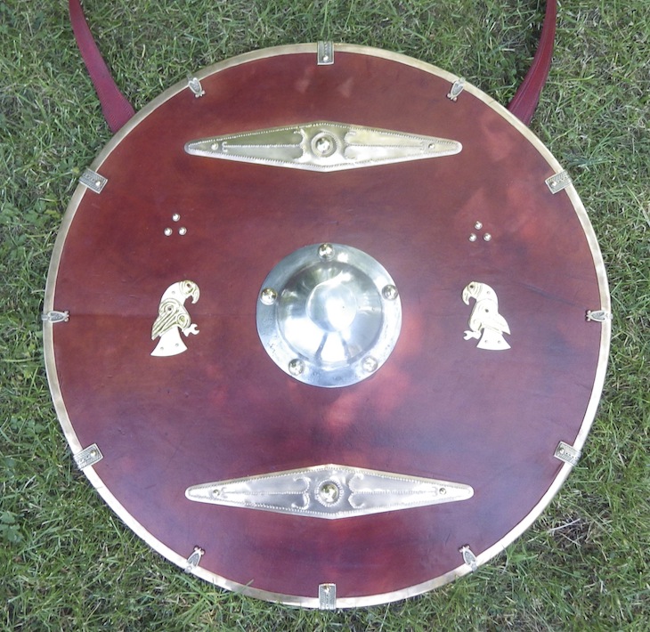

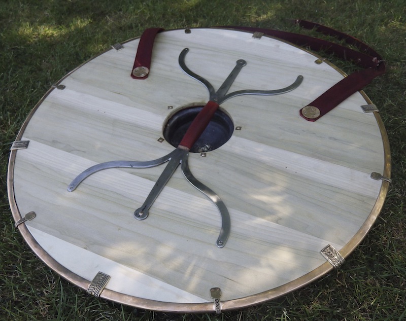

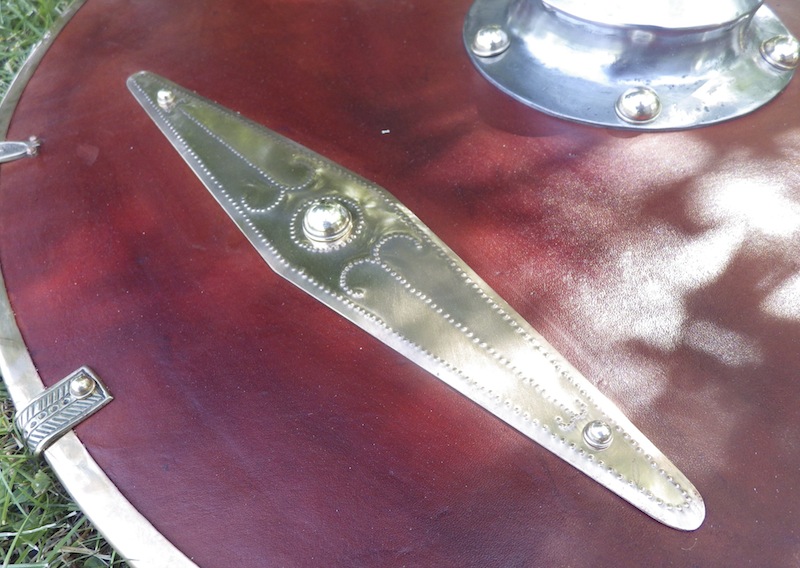

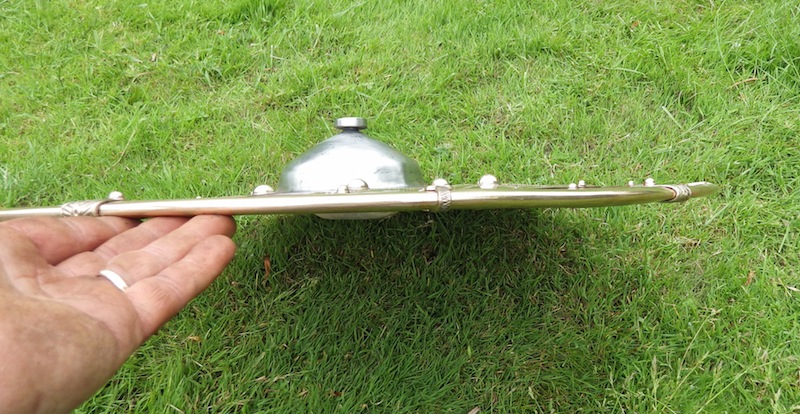

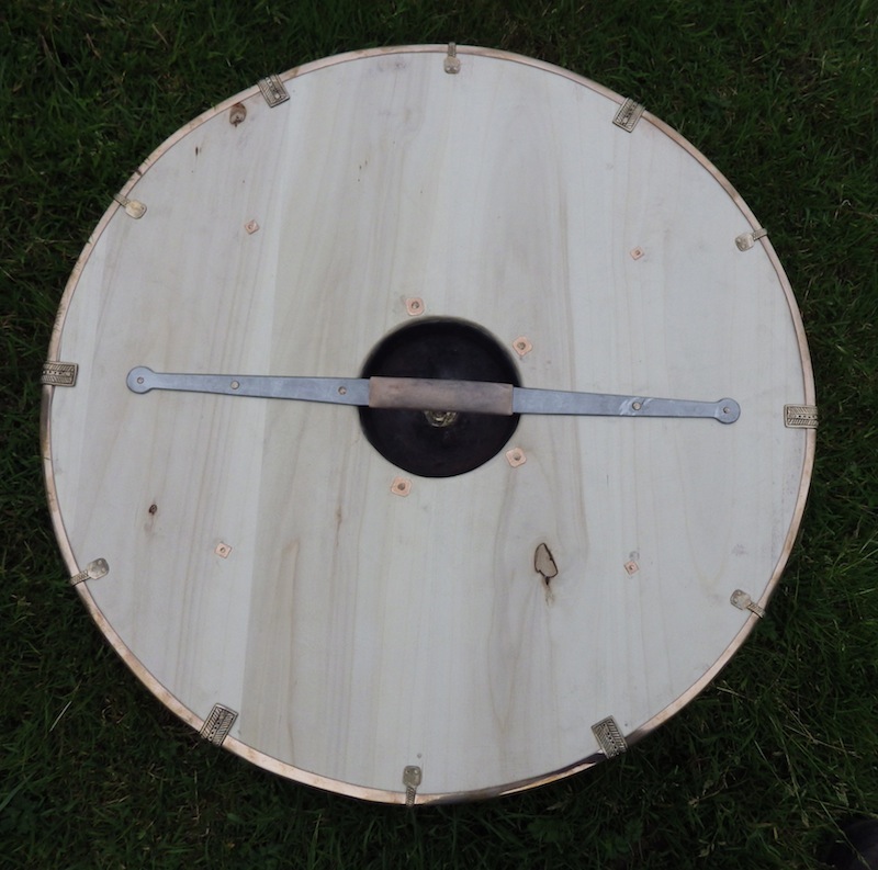

This is a Migration era shield based on elements from Sutton Hoo and a composite of other sources.
It is made from 10mm poplar, tapered to 6mm at the edge and the front face of veg tanned leather is bonded on; edging is bronze sheet with bronze clips and rivets as are the lozenges on the front face.
The handle spar is mild steel and the handle grip is leather over ash. The boss is hand raised from 2mm mild.
Overall the shield is 28" diameter and as yet I have not weighed it, but it is pretty light.
On a general note, there are very few finds of shields that are not associated with burials and there is speculation that the shields we do have are some sort of burial goods or votive offering and so were made thin as a result. This shield is very thin (to modern minds) but is comparable to those finds that we do have. I don't actually want to smash this up to find out how tough it is, but my observations are that when the board is glued, but un-assembled it seems incredibly flimsy. When the rim is fitted it starts to feel tougher and with the spar on, it now seems much tougher, but really still very light.
Anyway, I hope you like it.

PostPosted: Thu 20 Jun, 2013 12:43 pm    Post subject:         Reply with quote
Hi Tod,
Really like it. Very well done. Like all the bronze. Might consider offering the clips on your foundry site.
Did you do anything to enhance the (very nice) pattern on the leather?
Dumb question... the boss tip is historical? Is there a function? As decoration seems a bit plain compared to the rest.
This was a surprise & thank you for sharing.

Thanks guys.

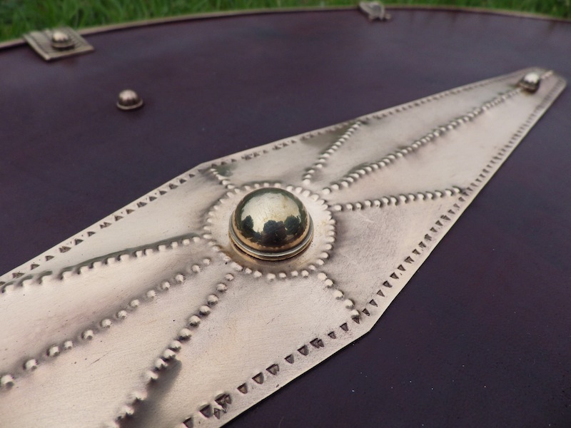

The leather was dyed to create a mottled effect, just by wetting the leather prior to dyeing to varying amounts. I am sure they will get onto the site eventually, but mail me in the meantime if you would like a set.
The customer received it on Friday and was delighted, but before I could weigh it. However, we both estimated it at 2-3Kg.

Viktor Abrahamson
Location: Sweden
Joined: 07 Aug 2008
Posts: 74
PostPosted: Tue 25 Jun, 2013 3:10 am    Post subject:         Reply with quote
That is a very good looking shield!
So the leather is not glued on? I usually use glue when facing my shields, resulting in a lot of trouble with the boards bending as it dries.
Is the leather sewn on around the edge and held in place with the fittings and boss?

The leather was bonded on and was kept clamped flat as it dried and that minimises the warpage and what is left is taken out when the rim goes on.

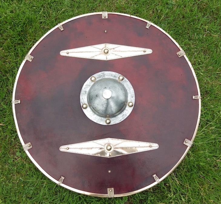

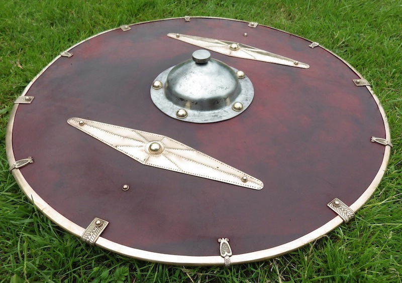

PostPosted: Tue 23 Jul, 2013 12:04 am    Post subject: second Migration era shield         Reply with quote

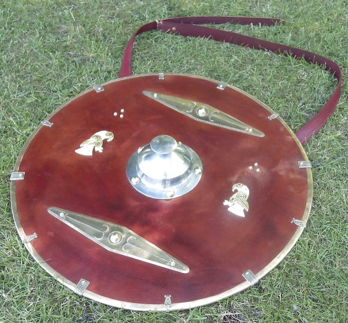

I have made a second shield with similar stats.
The boards are 10mm poplar, tapered to around 6mm at the edge. The front hide is bonded on and the rear has been left with no covering to allow the planking to be seen.

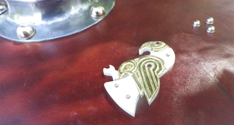

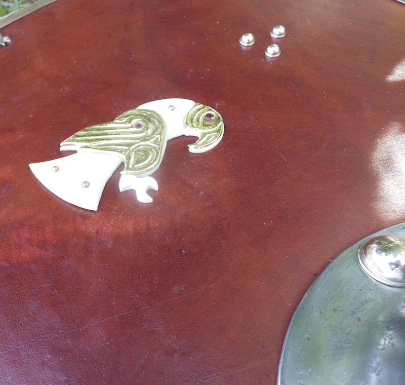

The boss was hand raised (by others) in steel. All the fittings except the ravens, are in bronze and riveted on with Bronze.
The ravens are copied from an original pair belonging to the shield owner and are bone with gold plated copper repousse elements and garnet eyes.
The grip support on the rear is in steel with a wood and leather cord bound grip.
I handed this over before I could get a weight, but I will ask if the new owner can weigh it.
I hope you like it
Tod

Really, really beautiful piece. Leather face on shields are rare to see, and go extremely well with the bronze bits.
Btw, Is the combined bone-bronze bird ornaments conjectural or documented? There are these kind of bird ornaments in copper alloy only from Valsgarde, right? Either way they are gorgeous!
Matthew Bunker
Location: Somerset UK
Joined: 02 Apr 2009
Posts: 483
PostPosted: Tue 23 Jul, 2013 11:50 am    Post subject:         Reply with quote
You do find examples in both English and Scandinavian finds where part of the copper alloy bird is gilded or tinned to give a contrasting colour effect.

The Ravens are copied from an original pair that are owned by the man who commissioned this shied.
I wil try to get a weight for it and post it up, as and when .
