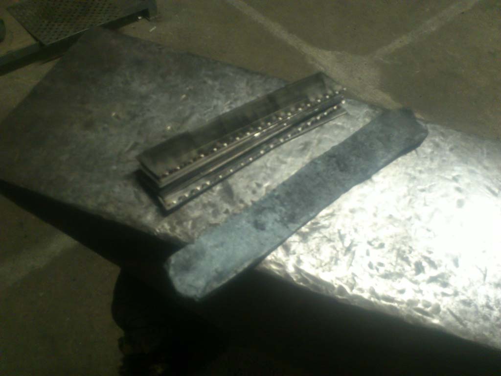

I have taken four pieces of saw and one of mild steel, since the previous was much thinner, so like this the layers had approximately the same thickness. a little bit of cleaning with the grinder, and I started the forge welding. I am not an experienced blacksmith, later due to this I have lost a lot of material, but in the beginning everything went quite well!
The first problem I encountered was that the blades of the saw was on the outside, and I welded the pieces together only on the end... The results? The thinner blades heated up more quickly, they became longer, and thus they formed beautiful arches next to the ticker mild steel. A bit of hammering and some more welding in the middle did the trick.
After using "some" coal and flux (the workbench was like the ending scene of Scarface Big Grin) I managed to make a nice bar of forge welded steel of two layers of saws with mild steel in the middle. I made another bar, but now of four layers. After it was finished, I forge welded the two pieces together. I had to repeat this seven times, to achieve the desired number of layers.

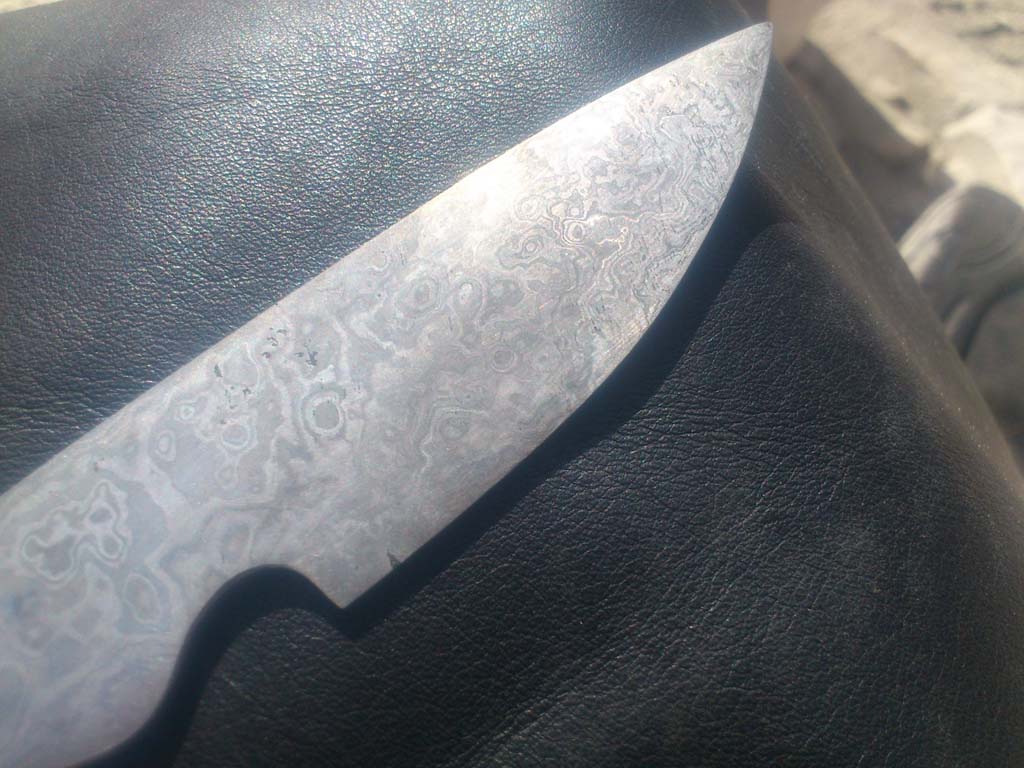

I heat treated the blade, altough I have heard that it is not completely necessary in the case of a damascus blade. For the first time, it was not quite fine, but for the second I was satisfied, and after some more work with the sandpaper the piece was ready for the acid.
The pattern was much more beautiful than I have imagined, I was satisfied with it. it was not too strong, but I wanted to make something less... Less outgoing, and the 10% mixture of HNO3 was great for this! (It is a cruel material, but for this purpose it is perfect.) I just stained the blade using a rag, submerging it in the acid would have meant way too much exposure.
The sharpening took several days... Normally I can sharpen a knife easily, but this little piece did not give itself easily! finally it was done, I have attached the vegetable tanned leather pieces using Palmatex. The knife was looking just as I have imagined. I was really happy with it, and so was my friend too! Happy

THe finished bar and the materials [ Download ]

After the acid [ Download ]
 Attachment: 102.72 KB
The finished piece [ Download ]
