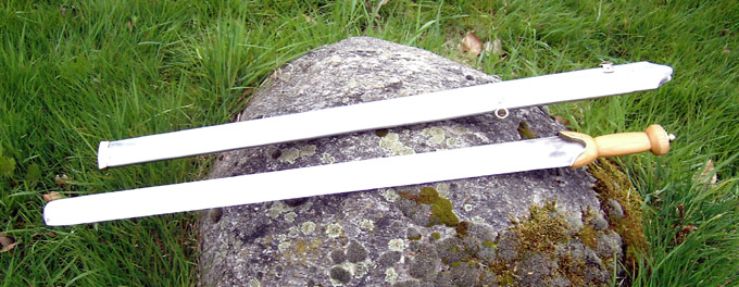

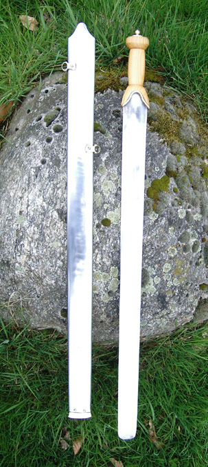

PostPosted: Sat 01 May, 2010 5:18 am    Post subject: Next La Tene         Reply with quote

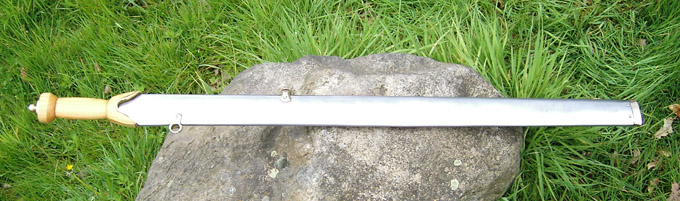

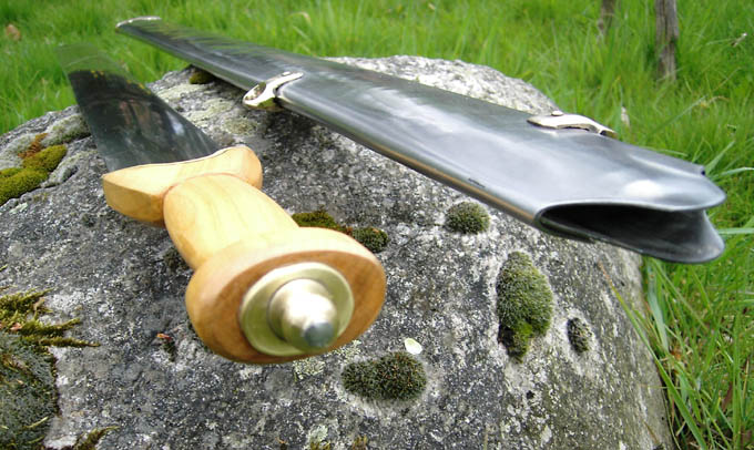

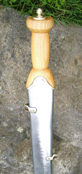

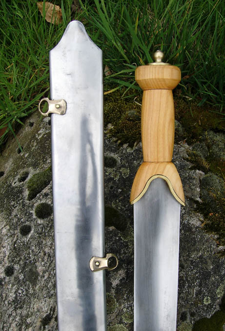

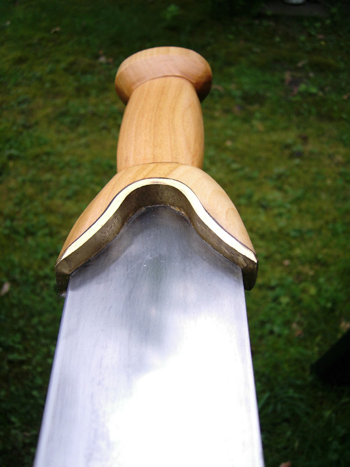

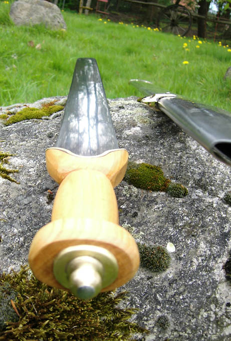

Hi, this is the next one of the germanic late La Tene Swords SIIa from the Nienbüttel Type:
This one has a bronze guard instead of the iron guard of the last one. Also the wooden hilt is a little bit different to the other one. Also the steel scabbard is polished. Also the bronze knob on the pommel is smaller but has a bronze plate under it.....
This was my work for the last two weeks...
What do you say?
Chris

The guard has to fit exactly to the lenticular shape of the blade

we will not let it die!
i like the first one, but i like the second even better!
I must get to powerhammer to break some material i have here and make some of this goodness too!

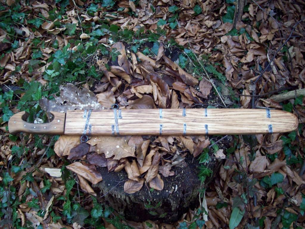

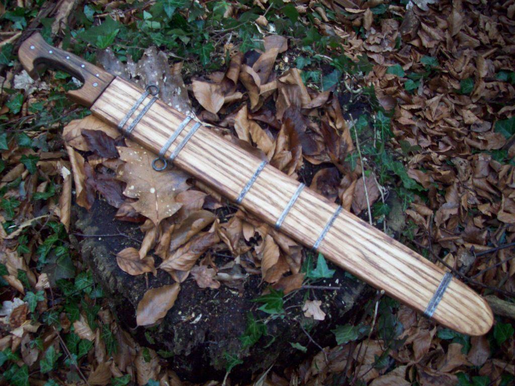

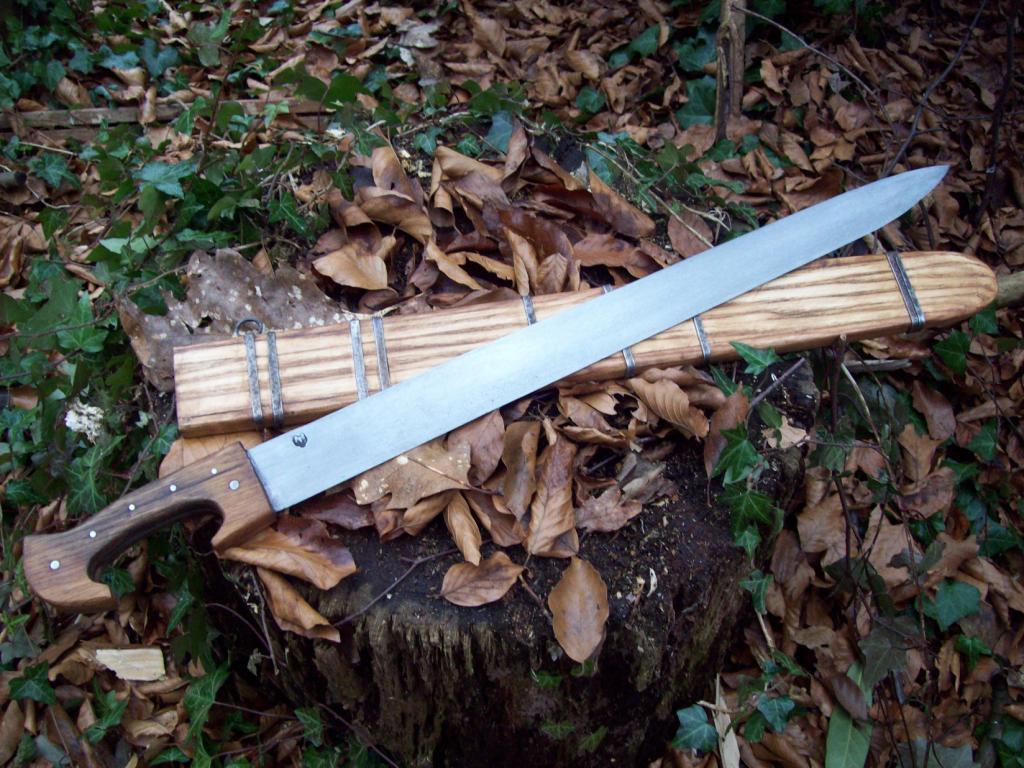

PostPosted: Tue 19 Mar, 2013 9:30 am    Post subject:         Reply with quote

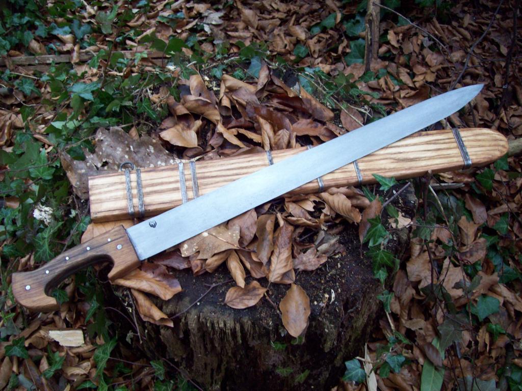

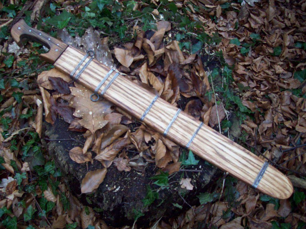

This topic has been a great inspiration and help to me!! Thank you so much, guys! Here is the result, scabbard fiitings based on Harsfelt, scabbard makeup (glued ash slats) Vimose:

Very nice Robert. I like it. Happy

Looks bloody great Robert.. Big Grin PLease do more -never enuff out there...
Besides that is one of my favor style of blades...... Big Grin

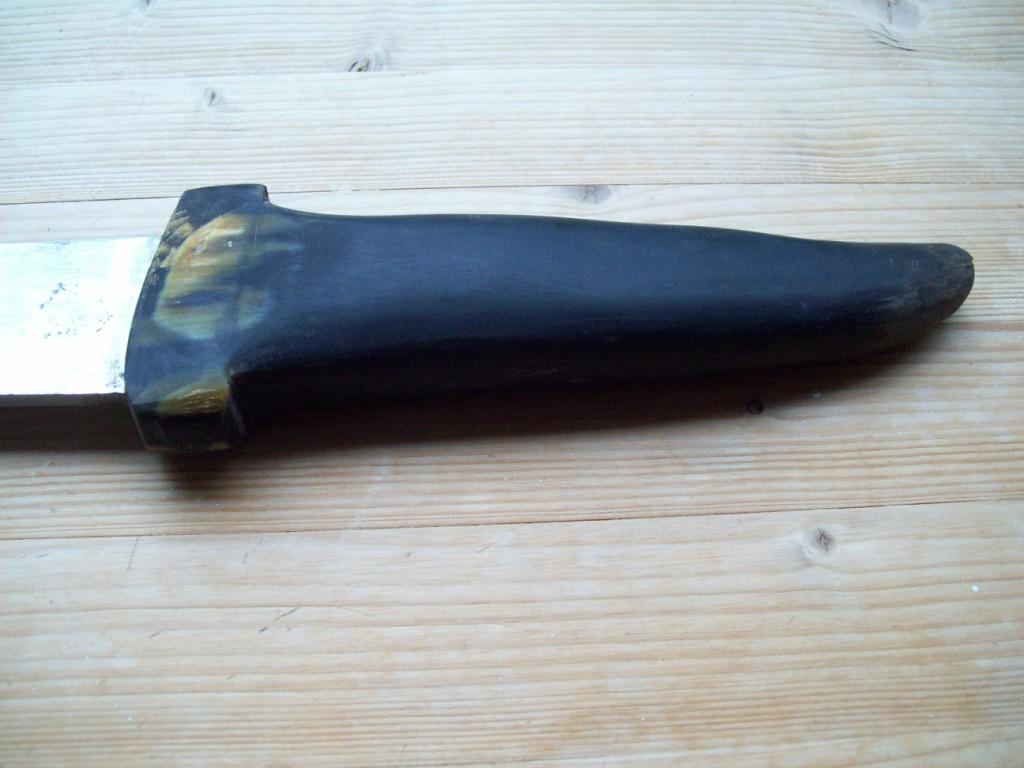

PostPosted: Thu 21 Mar, 2013 2:41 am    Post subject: Horn handled Langsax         Reply with quote

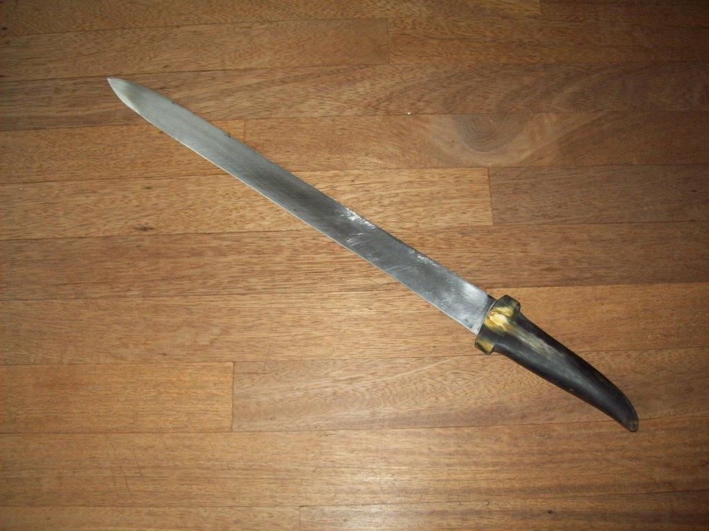

Thanks guys!
Here is a langsax I made for an archeologist for his PhD, as he wanted to show different ways of reproduction of a piece he had done the conservation of. The handle is of a single piece of horn and extends over the blade, as the original data suggests. The horn was deformed to shape using heat, as horn when heated to over 180 degrees celcius loses its "shape-memory" and will remain in the shape it was formed into. I used a vice to crimp the hot horn over the blade, setting the whole thing with boneglue. Then I shaped the handle with file and sandpaper.

PostPosted: Mon 29 Sep, 2014 10:09 am    Post subject: Germanic Iron Age Weapons         Reply with quote
Christian, this La Tène sword of yours looks a bit strange because its blade is square-pointed just like its scabbard.
