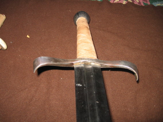

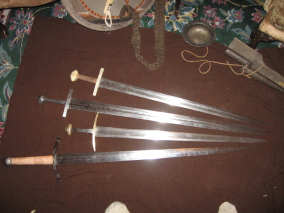

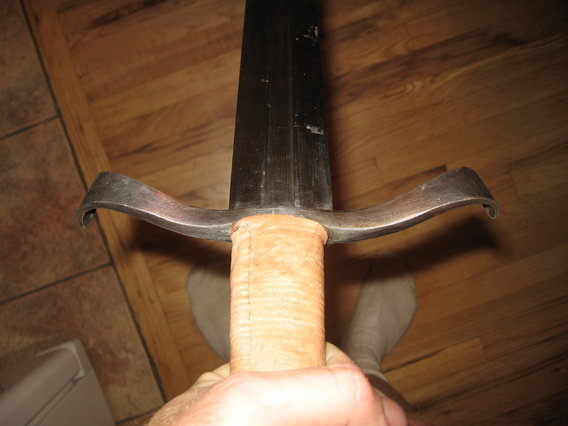

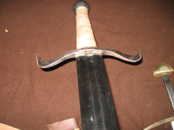

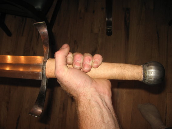

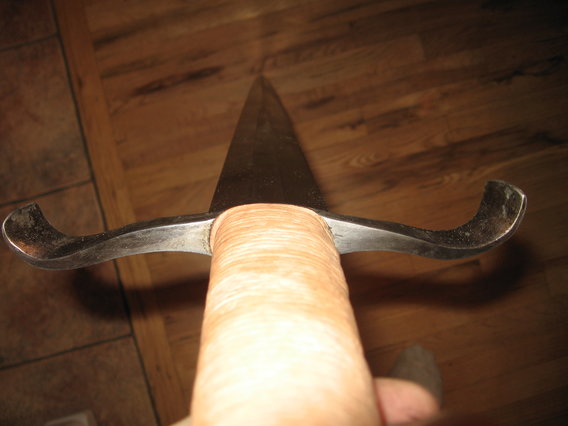

A few long overdue pics of very poor quality. This is a fairly loose interpretation, the grip just isn't long enough to really fit the type. I just wanted to practice forging hilt components. Albion type XVI blade, 36", 7.6" cross, 7.5" grip. Since I took these pictures, I stripped the grip to the wooden core and am refinishing the hilt components. I'll post some better pics of the refitted sword when I can. I am thinking maybe a bare birch grip with bands of wire wrap.
 Attachment: 54.95 KB

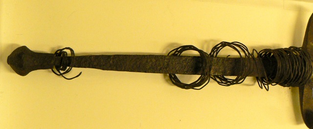

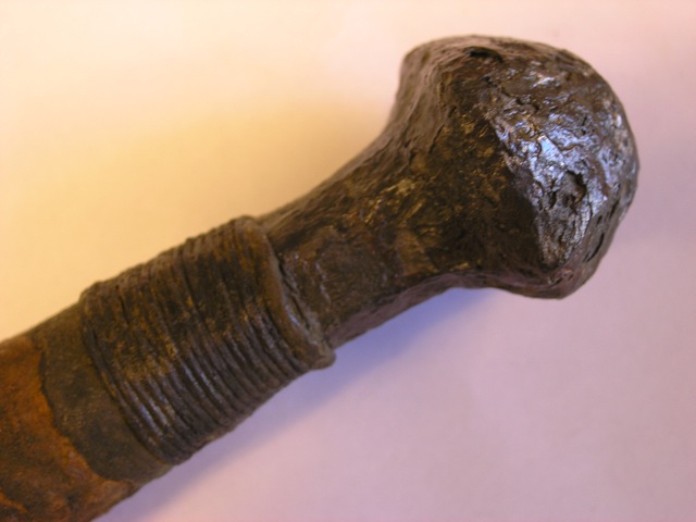

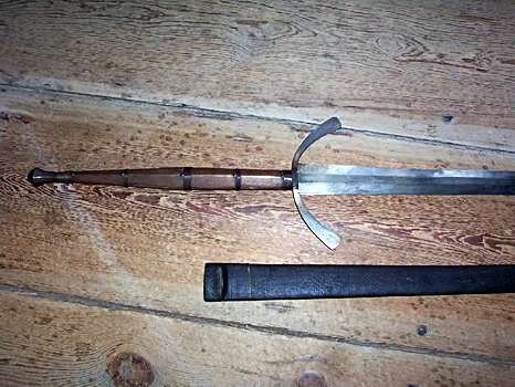

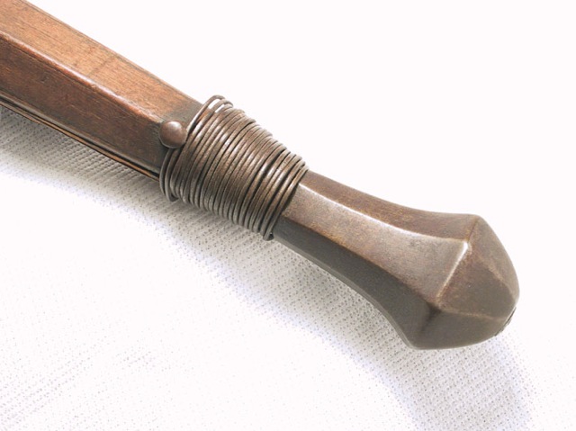

A few more pics of Scandinavian longswords from other threads, just to have them all in one place. These were originally posted by Peter Johnsson:
 Attachment: 97.99 KB
 Attachment: 63.88 KB
 Attachment: 43.07 KB
 Attachment: 57.02 KB

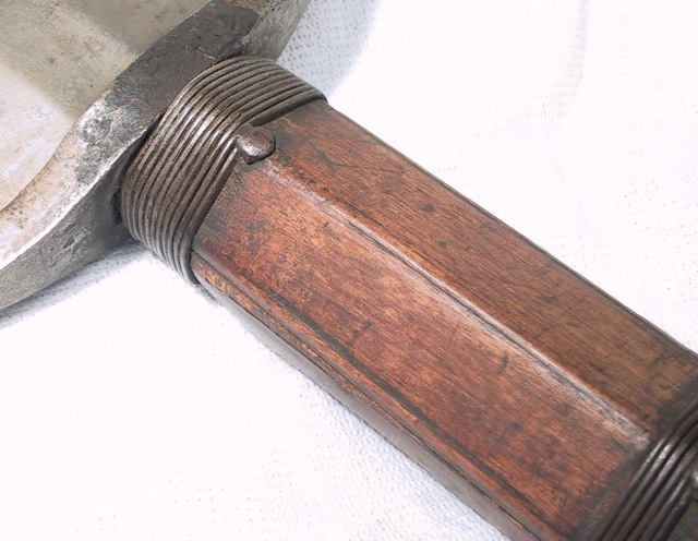

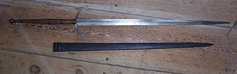

And these posted by Björn Hellqvist. Check out the condition of that original scabbard, amazing! It is difficult to tell if the blade is a fullered XVIIIb or more of a hexagonal section. Also, notice the lack of chape on the scabbard. Also, check out Mr. Hellqvists sword site, in the Virtual Museum section, under the title "warsword." He shows a nice one with more of a cutting blade. http://www.foxtail.nu/bjorn/swords.htm
 Attachment: 37.65 KB
 Attachment: 34.36 KB
