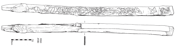

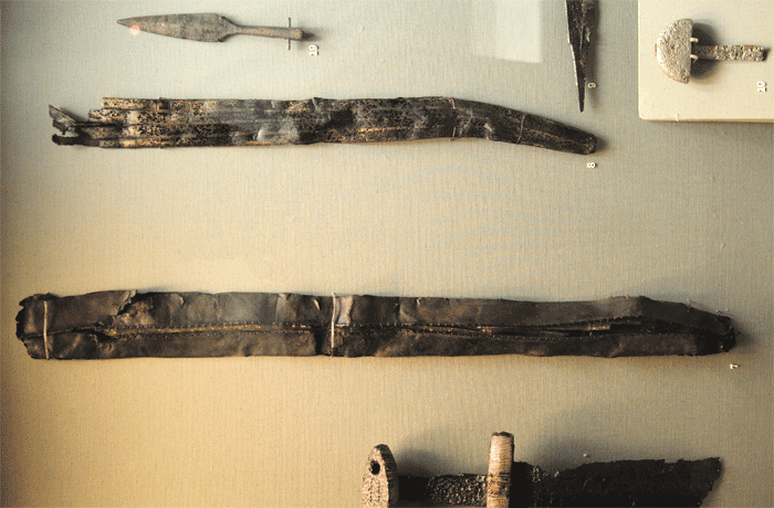

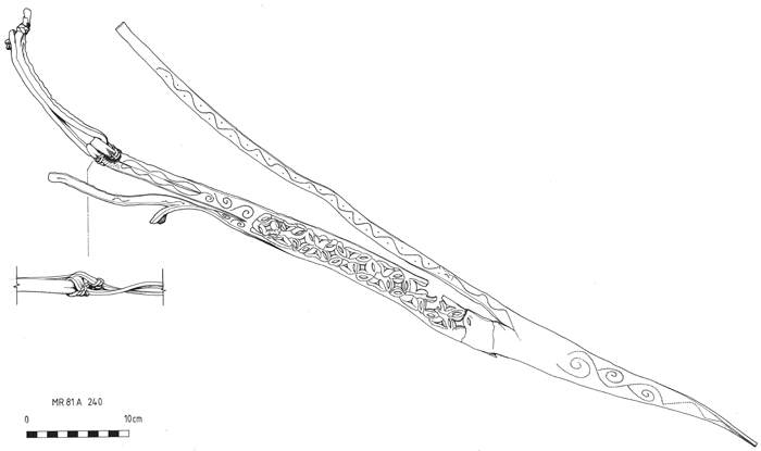

Posted: Fri 09 Nov, 2012 8:22 am Post subject: |
Mary Rose scabbards and belt. These are on the + side of your dates, Chad, being second quarter of the 16th c., but these are very useful drawings. They show relatively crude decoration. The scabbard with the star at top might even have been decorated/personalized by its owner as a pastime, as soldiers have often done over the centuries (my observation, not the Mary Rose Trust's).
