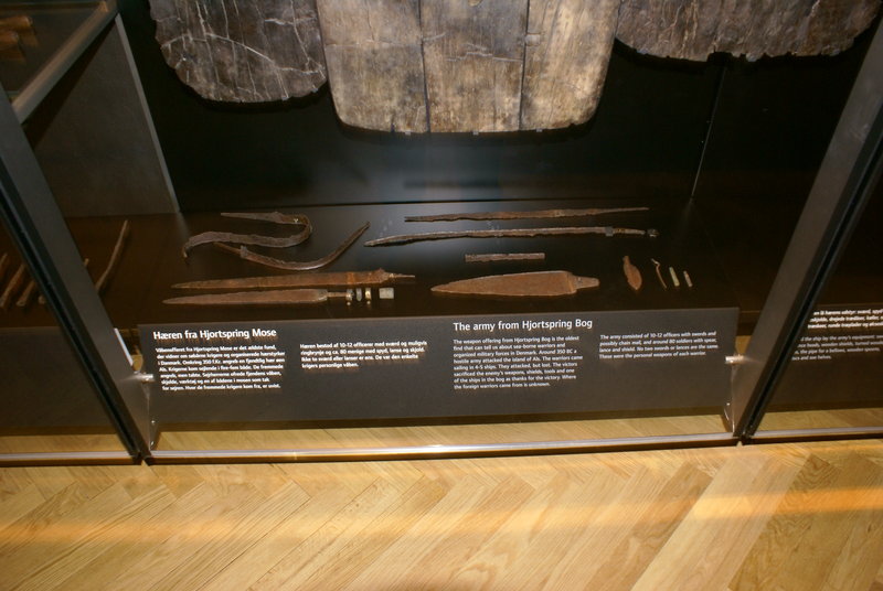

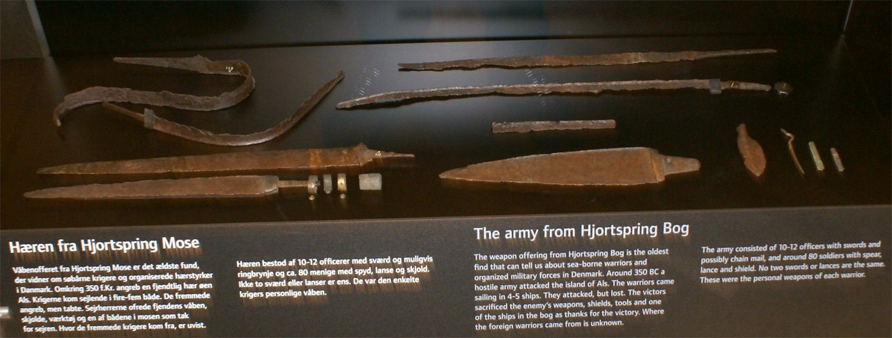

Paul Hansen
Posted: Sun 26 Aug, 2012 12:42 am Post subject: |
Here´s what I have from the National museum in Copenhagen.
Not the greatest pics, I´m afraid...

Scott Woodruff
Posted: Sun 26 Aug, 2012 1:55 am Post subject: |
Thank you soooo much Paul, that makes a world of difference. Now I have a much better idea of cross-sectional geometry and can estimate thickness. I can now see that the reinforcing band has the typical seax teardrop section and appears to be forged from welded tubes. Now I feel like I am on much more solid ground to proceed.

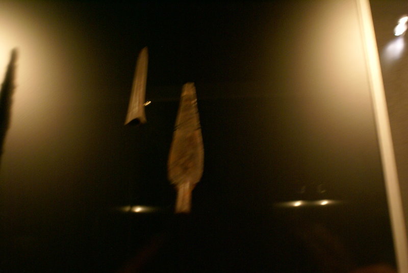

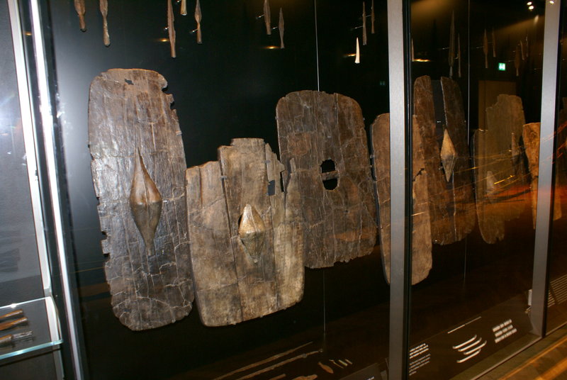

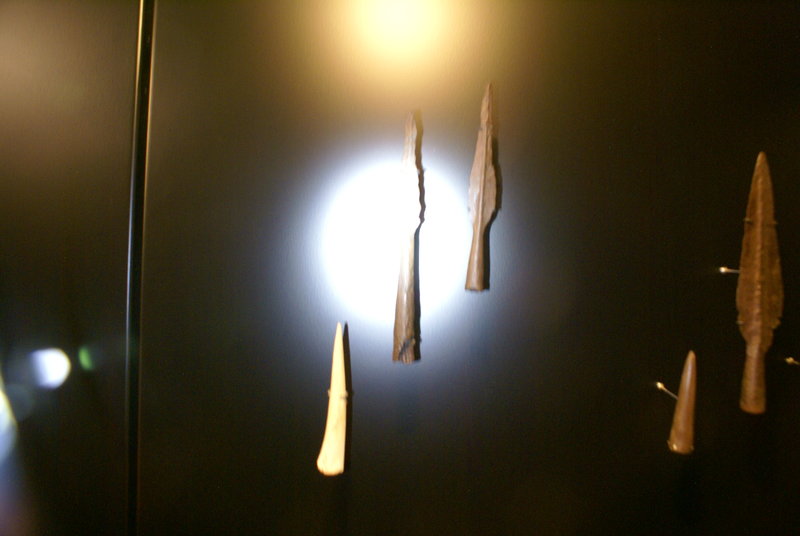

Posted: Sun 23 Sep, 2012 7:28 am Post subject: |
Here are some pics from the National Museum in Copenhagen, kindly provided by Paul Hansen.
