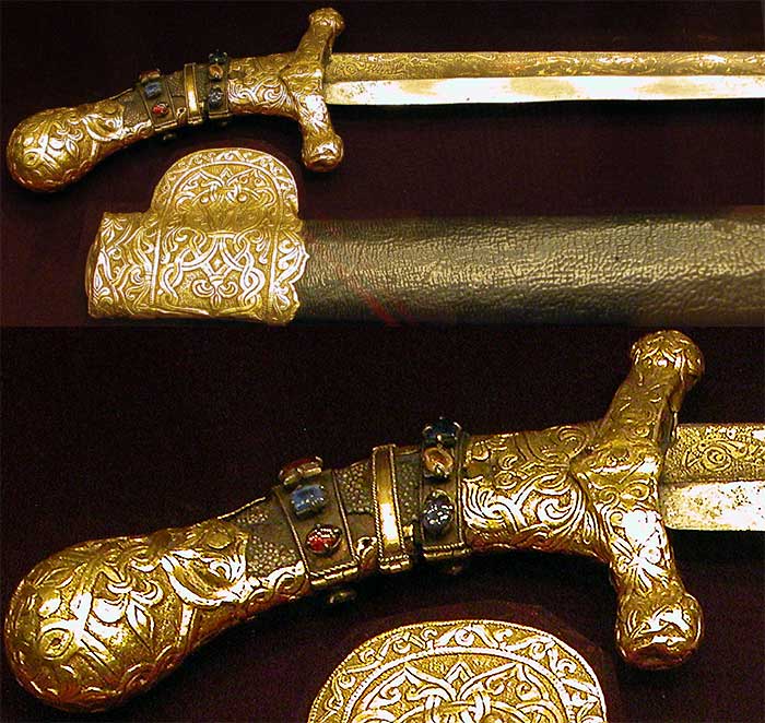

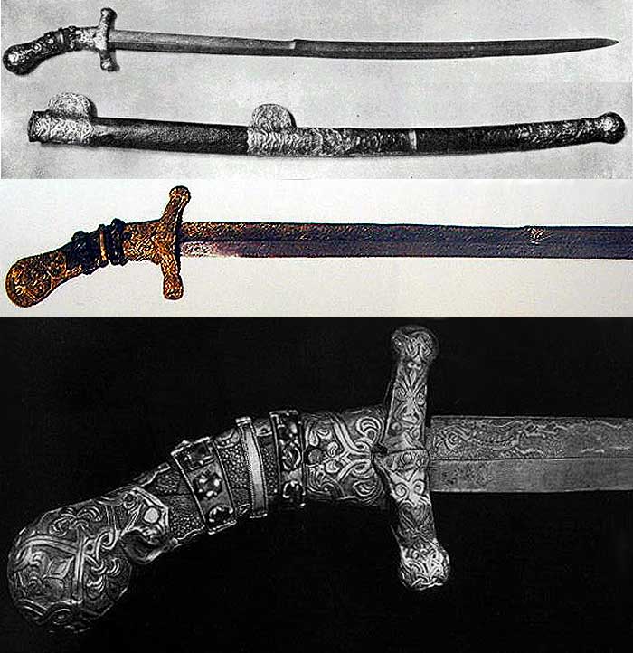

Here are a few pics of the Saber of Charlemagne...

Thanks Kirk. That is the first oppertunity I have had to see the blade of the Charlemagne sabre. It kind of looks like there are two transverse ridges dividing the fuller into three. Is this the case?
Hi Allen...
I believe there is only one transverse ridge just to the hilt side of the center of the blade. It appears that the backedge is thicker on the tip side of this ridge (like a reverse false edge). This would give more weight to the slashing end of the blade (like a very early falchion design). Here is another early saber...
