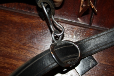

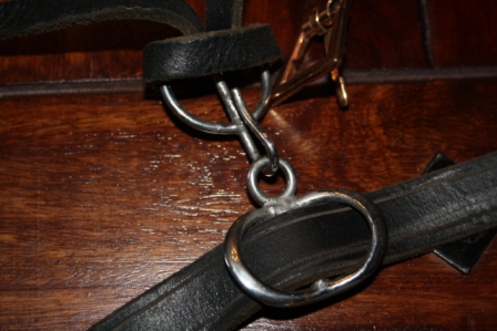

PostPosted: Sat 12 Dec, 2009 1:58 am    Post subject:         Reply with quote

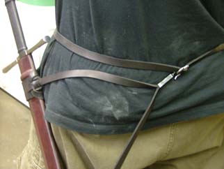

It depends on the style of the hook, I think. I have a hook for attachment to the belt on the back strap. Due to the shape it won´t come undone. See the picture.
 Attachment: 93.45 KB
 Attachment: 88.47 KB
Bryce Felperin
Location: San Jose, CA
Joined: 16 Feb 2006
Posts: 552
PostPosted: Mon 14 Dec, 2009 9:53 am    Post subject:         Reply with quote
That looks to be a good rig, thanks for the pictures.

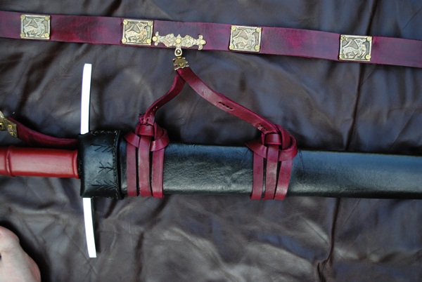

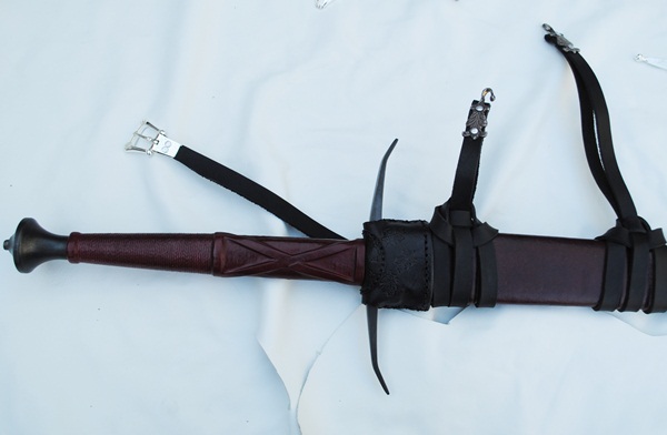

PostPosted: Mon 19 Dec, 2011 1:07 am    Post subject:         Reply with quote
Re hooks:

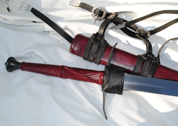

Here are some pics of the suspension Russ Ellis did for me a while ago as a 'test' piece on an ATrim, using a single hook:
 Attachment: 82.44 KB
 Attachment: 80.92 KB

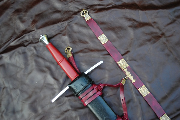

The above used the following images for inspiration - from Revival Clothing and Albion's sites, respectively:
 Attachment: 32.8 KB
 Attachment: 34.05 KB

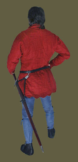

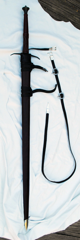

PostPosted: Mon 19 Dec, 2011 1:22 am    Post subject: And two hooks ...         Reply with quote
And here's a two-hook suspension Russ completed more recently. Interestingly, I recently came across a period image that shows a suspension with what looks like a moveable mount / in-line buckle on the belt ... will try to upload here if I remember. These allow for good weight distribution and carry.
(Apologies about image quality, and some covering-up of hooks/buckles ... these images are either quick work-in-progress pics or designed to focus on the 'raingard' / chappe, rather than the suspension.)
 Attachment: 48.08 KB
 Attachment: 80.5 KB
 Attachment: 158.87 KB
Schallern sind sehr sexy!
