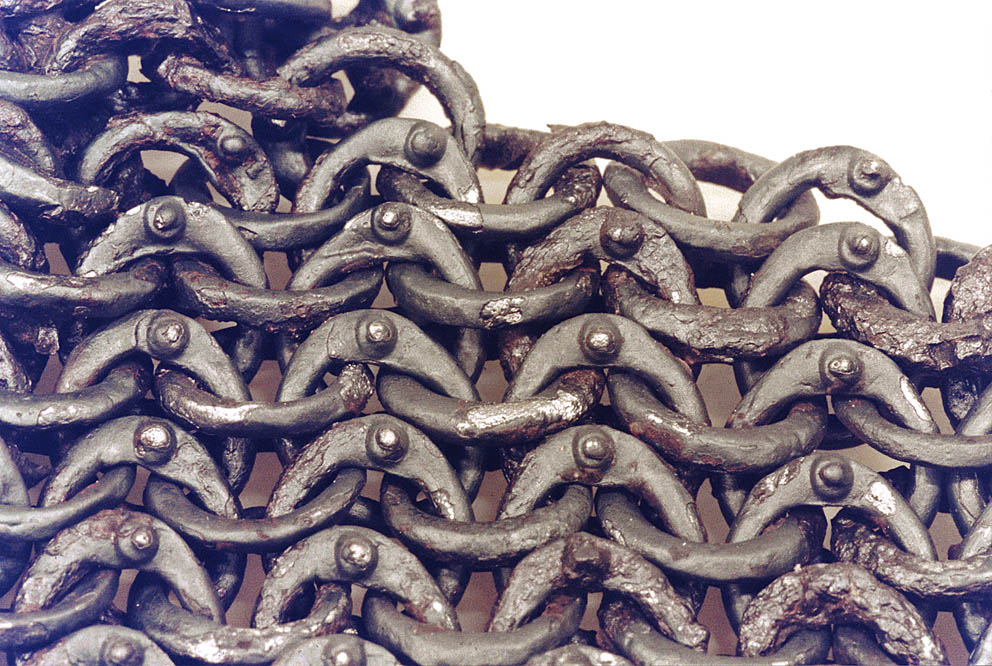

PostPosted: Sun 28 Aug, 2011 1:28 pm    Post subject:         Reply with quote
You have done good work developing the punched ring prosess for the gjermundbu mail Johan. Interesting to see the presentation here. There is one detail of the process that I was not aware of when i wrote my little paper "Brynjevev/Ring weave". I discovered it during later studies. I will share it with you here shortly so that you have the opportunety to perfect the prosess.
Andris Auzins wrote:
Johan Gemvik wrote:
One new detail Niclas got from Vegard was that the rivet dome has a double bulb, one on top of the other......
.....Incidentally I found several of my own riveted links have the same shape. I've been trying to work that off them, but clearly I shouldn't. In fact when I make my next riveting plier set I'll make two, one with a large dome for first stage crimping and another second one with a smaller recess for second stage to shape the top bulb.
I don't get it - what is so special about the double bulb? I believe it happens when the dome created by piercing the ring differs from the depression in the rivet setting pliers. I also get this effect constantly when I use my older pliers that have some wear in them.
I agree with you Andris, there may have been a misunderstanding. The double dome is not the result of setting the rivet twice with two different sized peening depressions. It is the result of the hole for punching/drifting beeing slightly larger in diameter than the depression for the peening of the rivet. The rivets used for the gjermundbu mail is almost round in cross section (and somewhat conical in shape). The hole for punching/drifting has therefore also been round.
There are also other interesting toolmarks on the rings. They are not present on all the rings (that includes the double dome), and are not equally common, but they can be found frequently on the best preserved riveted rings from the gjermundbu grave find. (By the way. Notice the backside of the rivet area. The rivet is flush with the ring material, and there is no visible transition between the metal of the ring and the rivet. This quality is quite common on period mail as I can remember, but few are able to reproduce this today, so we are doing something wrong).
 Attachment: 133.38 KB
Toolmarks on riveted mail rings from the gjermundbu mail [ Download ]
 Attachment: 207.55 KB
Riveted rings, gjermundbu mail [ Download ]

I'm so sorry we passed each other on Wisby as I've been a great fan of your maille research ever since I first read the Brynjevev paper many years ago. But now you found the thread here instead.
Your shared insights and deailed photos are invaluable for making the rings accurately. I simply can't thank you enough! Happy
I'll construct tools for drop forging the solids as soon as I'm able and I'll make sure to make some few that are misaligned even. When one has that tool it should save even more time and effort on manufacturing.
Also, funny enough I did use conical rivets first, but switched to slightly flattened very pointy triangles. I can just switch back to my frist rivet type, they were actually easier to work with.
I'll also try to make a plier or similar tool that actually gives the #5 mark at the rivet overlap. I have a leatherworkers plier that I can easily adapt as it has a removable joint screw. Much easier to get at those inner surfaces that way and it's hand forged so it looks nice already. I'm also thinking the plier jaw surfaces may need to be flat bottom and slightly concave top to get the right look as seen in the photos.
I'll give it a try and see how that turns out.
Could the #4 mark be from the rivet pressing tool? I don't see it on all riveted rings just some and so I'm guessing it could be the second pressing that sometimes does it if it's a little misaligned and the edge of it touches the ring.
