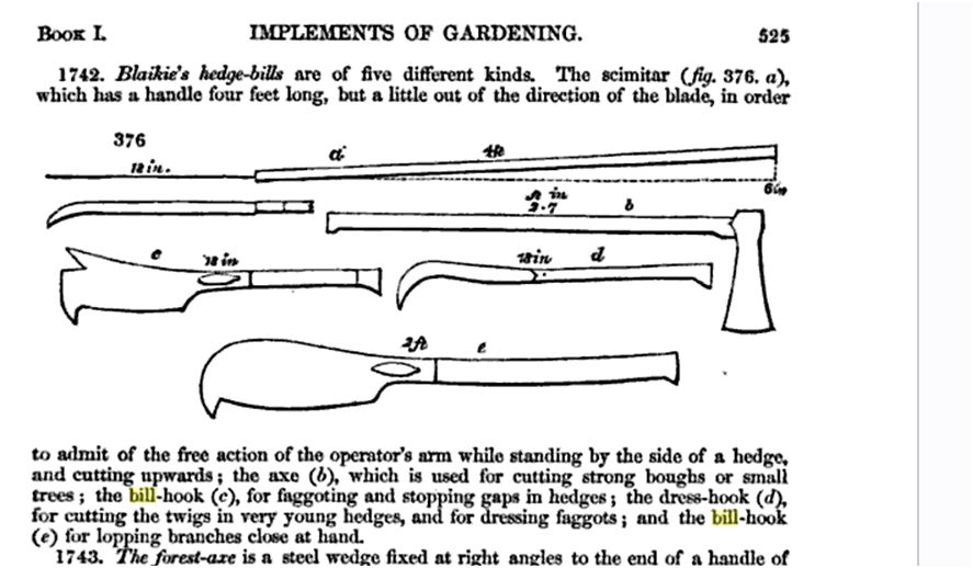

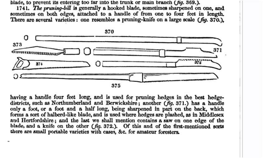

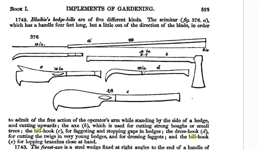

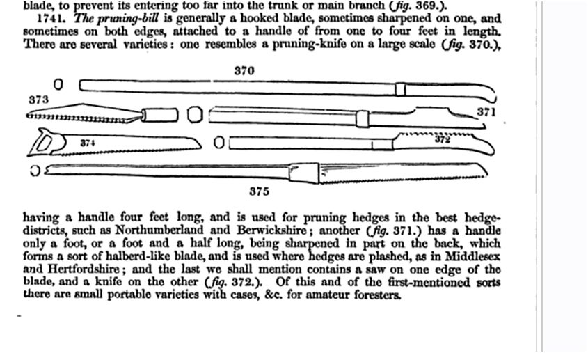

PostPosted: Tue 31 May, 2011 1:00 am    Post subject: Billhooks and edge tools         Reply with quote
Hi
Just joined the forum, so a little late in contributing to this thread... One tool almost all peasants would have and know how to use was the billhook - this has been common in all European countries since the Iron Age and was ceratinly being made and use in Britain prior ro the Roman invasions... Short versions, known as handbills (the use of the word billhook did not become common in the UK until the early 19th century) and longer handled versions, the hedging bill, or modern day slasher were easlily converted to a pole arm by the addition of a back hook Indeed many regional variations do still have a back hook for pushing branches back ointo the hedge), or a spike and by fitting to a longer handle...
There are also a multitude of other tools that would easily make weapons - the marc knife or vinyeard axe, used in cider and wine regions for chopping uo the residue from the press, coupe prés, used for cutting through turf (common in France), ditching and hay knives etc.... There is cetainly no need to fit a scuthe balde to a long handle - that tool already existed in the thatcher's eaves knives - those from Norfolk having up to a 3 ft long blade on a 4 ft handle...
Many tools are erroneoulsy classified as weapons , even by the experts and the msueums, because they are unfamiliar with the tools of the farmers etc...
See also: http://www.livinghistory.co.uk/forums/viewtop...p;start=30 and http://outils-anciens.xooit.fr/t2510-Outil-ou...htm?q=marc
 Attachment: 78.1 KB
Hedging tools 2 [ Download ]
 Attachment: 87.05 KB
Hedging tools 1 - An Encylopaedia of Gardening by John Clauius Louoen [ Download ]
Edge tool collector and historian, with a special interest in the billhook...
