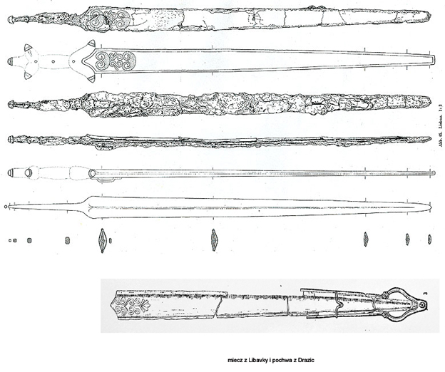

I found an interesting analogy related to Liebau sword. It is Drazice near Tabor, Czech Republic, scabbard, the same construction ( bronze front over back iron) and similar type of decoration (nr 3 on drawing). It is possible both swords were forged in the same place. The most interesting part is a big bronze (?) chape, early A type, missing in Liebau sword . By the way, there is a several places in La Tene culture range called "Liebau" : some in Czech, Germany, one in Poland. I still have no idea which one place is correct, Lubava, Czech Republic may be my favorite but maybe I'm wrong.
 Attachment: 5.65 KB
 Attachment: 149.92 KB

I found in old Jan Filip's book some more pics of Drazice scabbard and grave goods as a context
