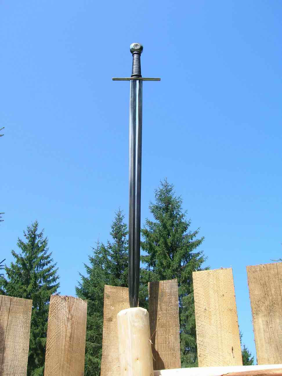

PostPosted: Mon 23 Aug, 2010 11:42 pm    Post subject:         Reply with quote
Here's my "Raven":
Total length 97 cm
Blade length 80 cm
Grip length 11,5 cm
Blade with at base 44 mm
Blade thickness 7 mm tapering to 3.5 mm
CoG 12 cm from guard
CoP 54 cm from guaRD
Weight 1,2 kg
It needs some finishing touches, but I couldn't wait...

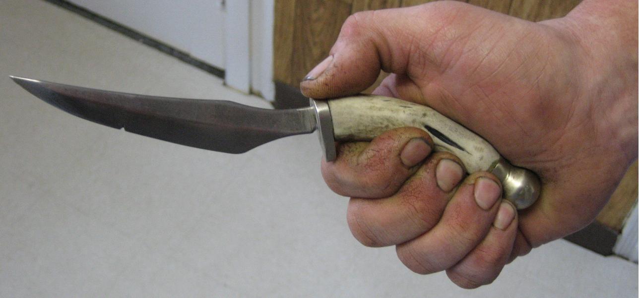

the first knife I ever completed [ Download ]

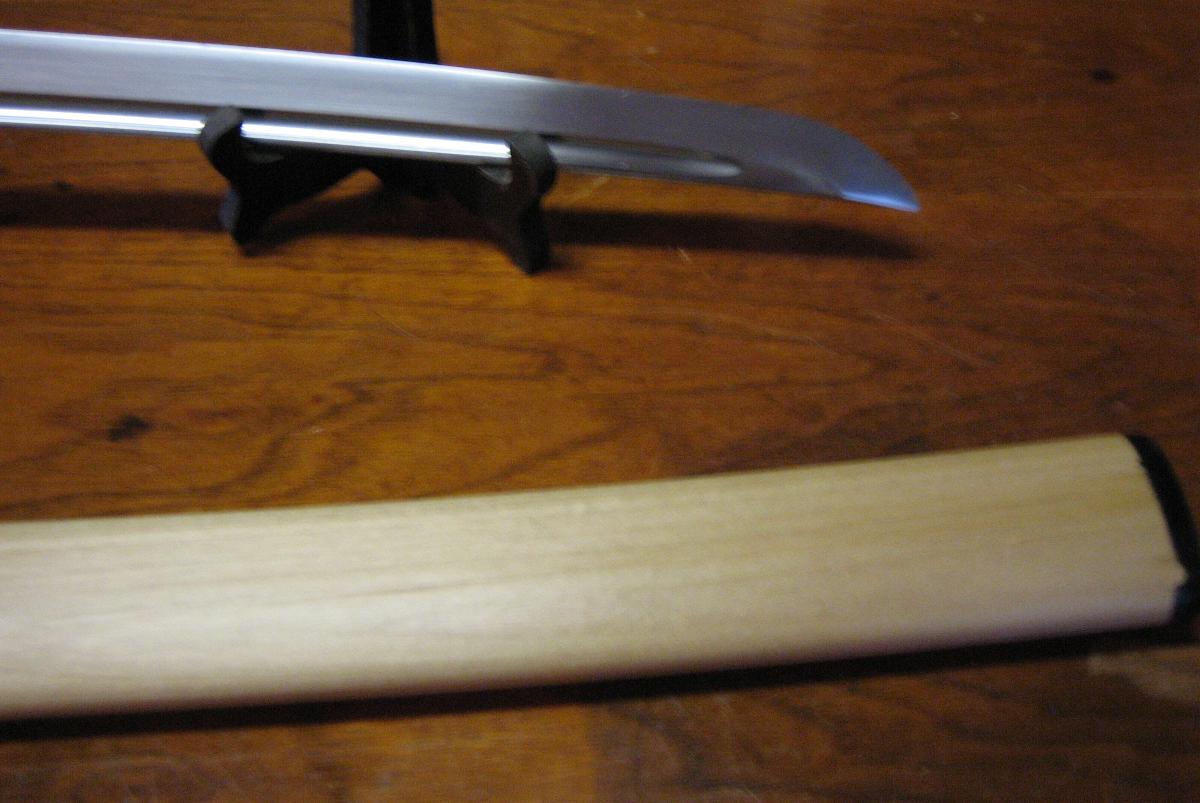

tsuba and habaki of the katana I did [ Download ]
 Attachment: 102.93 KB
the kissaki [ Download ]
 Attachment: 52.03 KB
the whole thing [ Download ]
