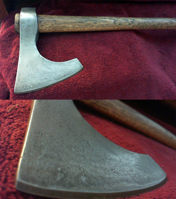

Cole B
Joined: 05 Mar 2008
Posts: 44
PostPosted: Thu 31 Mar, 2011 3:52 pm    Post subject:         Reply with quote
Sorry for the slow update!
I took the head off with some taps from a hammer, sanded down the handle and sanded off the paint on the head.
For the head, I did a mix of vinegar and salt overnight sprayed on like in the antiquing article, then sanded it off with sandpaper and then ultrafine steel wool.
For the handle, I stained it and then did coats of linseed oil, which I continue to do once in a while. I think of it like wood lotion.
Sorry for the crappy picture, I don't have a digital camera at the moment.
 Attachment: 228.52 KB

PostPosted: Thu 31 Mar, 2011 5:48 pm    Post subject:         Reply with quote
I am certainly no expert, but that looks pretty good to me!
