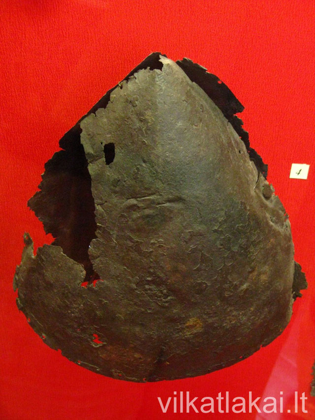

Yes,I know about this title "Lithuanian(or Prussian) shield" amed to "pavese"shields. In late 13th century Prussian and Lithuanian archeological stuff is almost similar.Even helmets,in that Mareinverder bas-relief,crusader's enemies(Prussian or Lithuanian) wear a conical helmets with central crest (look at bas-relief,central "killed" warrior),such similar conical helm with central crest is founded near South Lithuanian present frontier in Belarus(Hrodna city) and dated to 13th century.With no doubt in that bas-relief are portrayed lately conquered Prussians,or main 13th-14th crusader enemies Lithuanians.
But it doesn't matter.I just want to know about earlest "paveses"in Europe and I hope it could be a key to answer about Lithuanian shields in 13th century.
 Attachment: 118.06 KB
 Attachment: 126.94 KB
