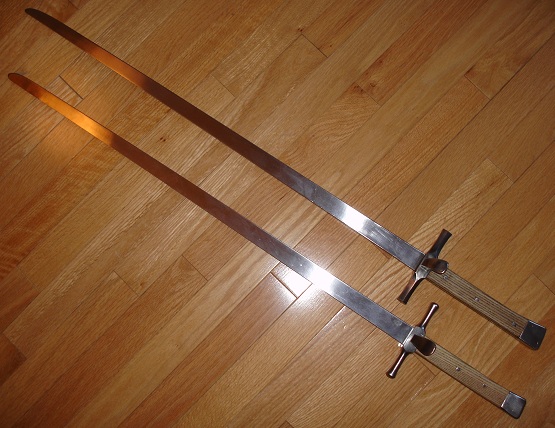

A little while back I called Arms and Armor up to discuss a project. I wanted a steel messer for training purposes on the market that was in the price range of the Arms and Armor Scholar Sword. And I didn't just want -my- ideal messer; rather, I wanted something that would be available on the market to everyone, so that when students of mine say that they want a trainer in the $400 range, I would have an answer for them. I had several ideas, and talked it over with Craig Johnson on how we could keep the quality and functionality up but still keep the price down. Craig succeeded with flying colors.
Pictured are the two prototypes. I've had them for a couple of months now and have put them to use. Also, people who were at the recent event Longpoint in Maryland got a chance to check them out and use them. There are a few tweaks Craig is going to do to the final model, but this is basically what you're going to get. (Most people have commented that they like the looks of the guard with the diamond cross section, so I suspect that is the guard that will go on the final version, but I don't know for certain.)
I don't want to publish official stats, since these are only the prototypes and the final version will have some minor changes that will alter the stats, but all in all these are quality trainers. They handle very well, they move easily, and they are tough as nails. In fact, after a couple of months of use they still look surprisingly new, with only some minor scrapes in the finish.
Bottom line: If you are looking for a high quality steel messer trainer that is in the mid-range price of the market, you finally have an option, and it's a damn good option.
 Attachment: 103.78 KB

I am not familiar with Messers, but they seem a wee bit too long for me? I always thought the Messer were shorter, more lika a one handed Sword or a long Bauernwehr?
Well, it depends on the messer, as some are quite long. You see the exact same range as you do with any single hand sword.
Despite that, I did actually suggest to Craig that he make these a couple of inches shorter. The length now is perfect for me, but I'm also 6' 2", so I recommended he make the standard model slightly shorter so as to make a wider range of people happier.

Hello Everyone,
While we have not got the final form of these set as yet, part of how we go about developing training weapons, I can add a few things to Bill's description to let folks know where we are focused on these.
As with all of our training pieces we want to be in the historic design envelope of period examples at a price that was attainable for the mainline practitioners. This all needs to be done with a sword that will give a long and solid service to its owner. Probably much like the makers of the period would have approached the issue Happy
Our length will probably end up in the 35 to 36 inch range, the items pictured are a bit longer. Its always easier to knock a bitoff than try to add something Eek! Weight will probably be 2.5 lbs or under. It will be affected by final guard design size of nagel and such.
The center of gravity is not set as yet as some of the changes we plan will probably affect this but I would think we are in a 3 plus inch range?
Our process for developing the training items is a bit different than our replica process. After some intense research we discuss with Those teaching and practicing the style of combat the sword will be used for. Then prototypes are put through extensive use and practice with these Western Martial Artists and their feed back and needs are incorporated into the final products. This, we think, produces a better product and one that is user friendly than just trying to create a piece in the style. It also allows use to get something that meets a larger percentage of the people interested in the piece with a sword they feel good about.
If there is one aspect to building training items for the WMA community has taught us is there is no one sword that will satisfy everyone. This is one aspect of why we design to modes in which some variability is possible down the road to meet the needs of as many as we can.
We like to think of it as we do not make swords for everyone but we do make swords for people who love swords Happy
As this process has gone quite well for these items and the need seems strong, already had someone put a deposit down on the first one off the line Happy we will be fast tracking some of our production on this so I hope others will be interested and it will full fill a need for all that feel it!

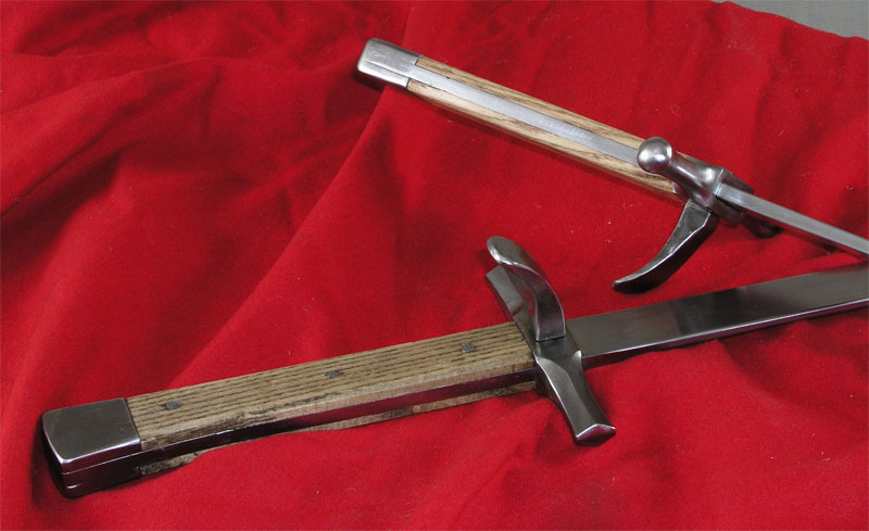

PostPosted: Tue 25 Jan, 2011 7:31 am    Post subject: Hilt Pic         Reply with quote
Here is a snap shot of the hilts to show a bit more detail of what these will look like.
 Attachment: 67 KB

These look very intriguing. I love the diamond cross-sectioned guard. Very, very sharp.
