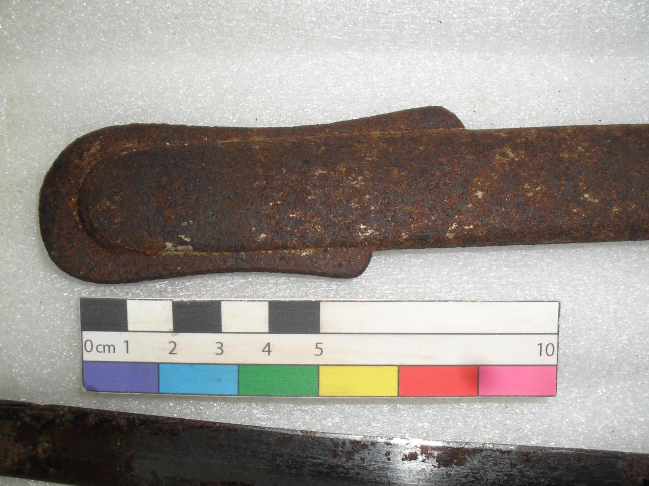

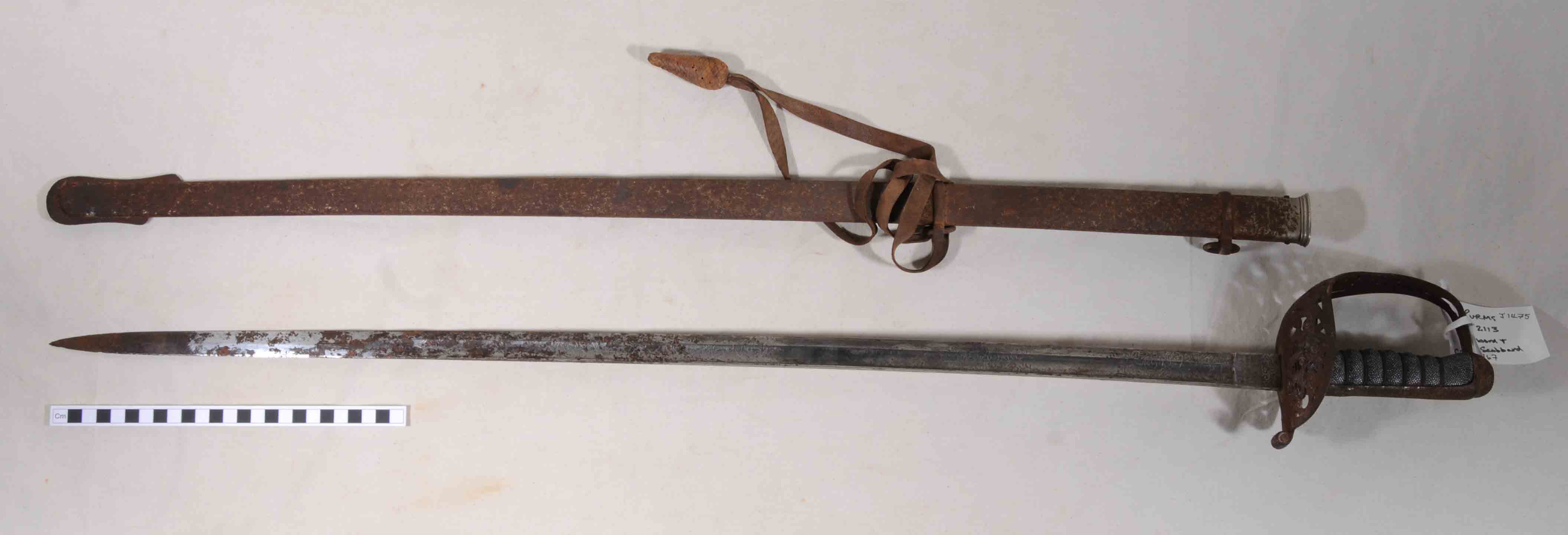

I am doing some conservation and research on this sword and I was wondering if anyone could tell me what kind of sword it is please? Please see attachment for photo of the sword and scabbard.
 Attachment: 117 KB
Jonathan Hopkins
PostPosted: Wed 01 Dec, 2010 3:56 pm    Post subject:         Reply with quote

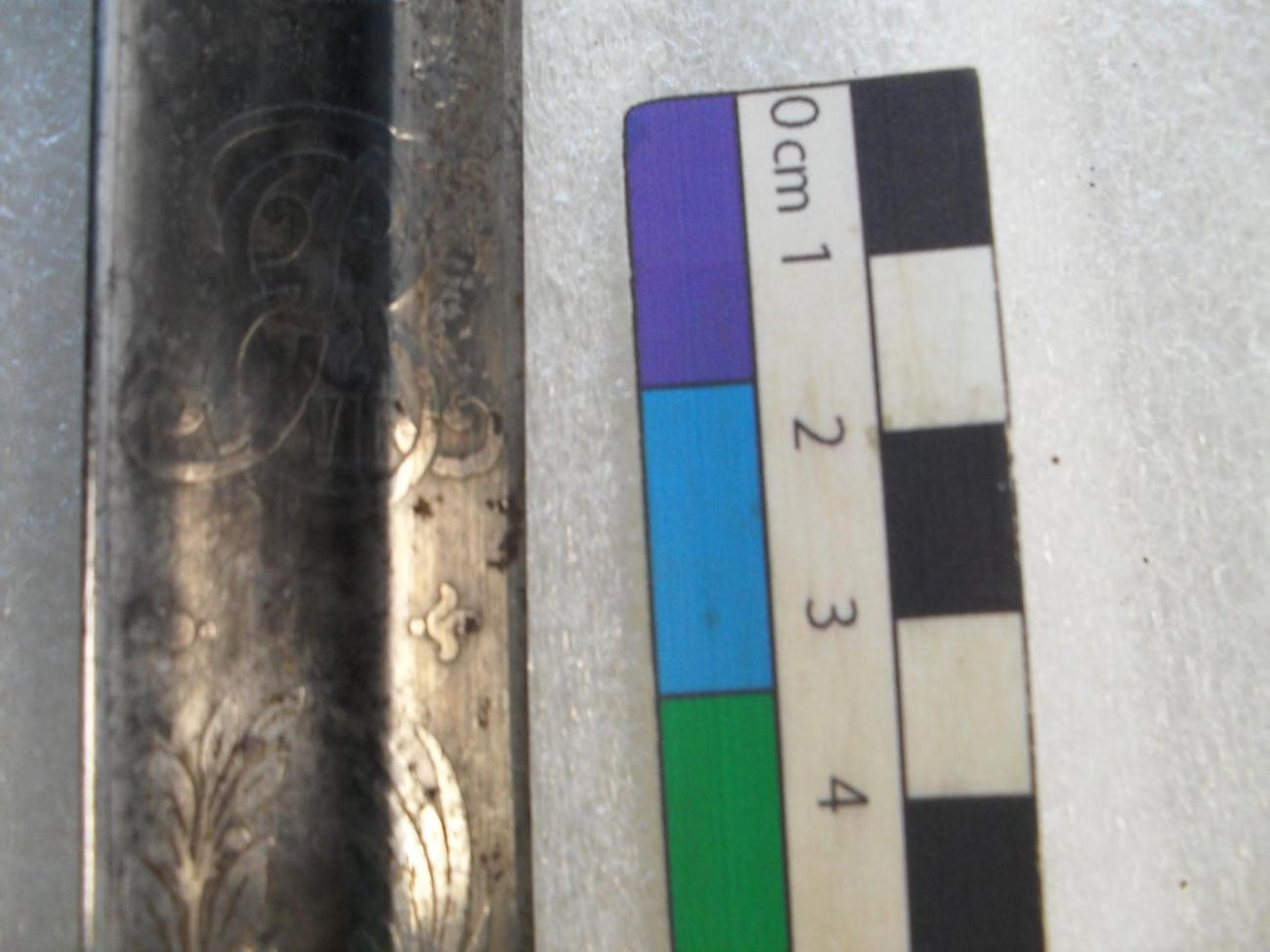

It is a British Pattern 1821 Heavy Cavalry Officer's Sword. Based on the grip shape, I believe it dates no earlier than the 1890s. In 1896 this became the standard pattern for all cavalry officers regardless of cavalry type (heavy or light). The blade should have the cypher of the monarch of the period it was made. If VR (Victoria Regina) then it is Victorian, if ERVII (Edwardus Rex VII) then it is Edwardian, and if GRV (Georgius Rex V) then it dates to the early years of George V. Please post some additional photos if possible. Is there a maker or retailer's name on the blade? Perhaps the name or monogram of the original owner?
As far as conservation, I recommend reading this article before beginning: http://swordforum.com/articles/ams/conservation.php

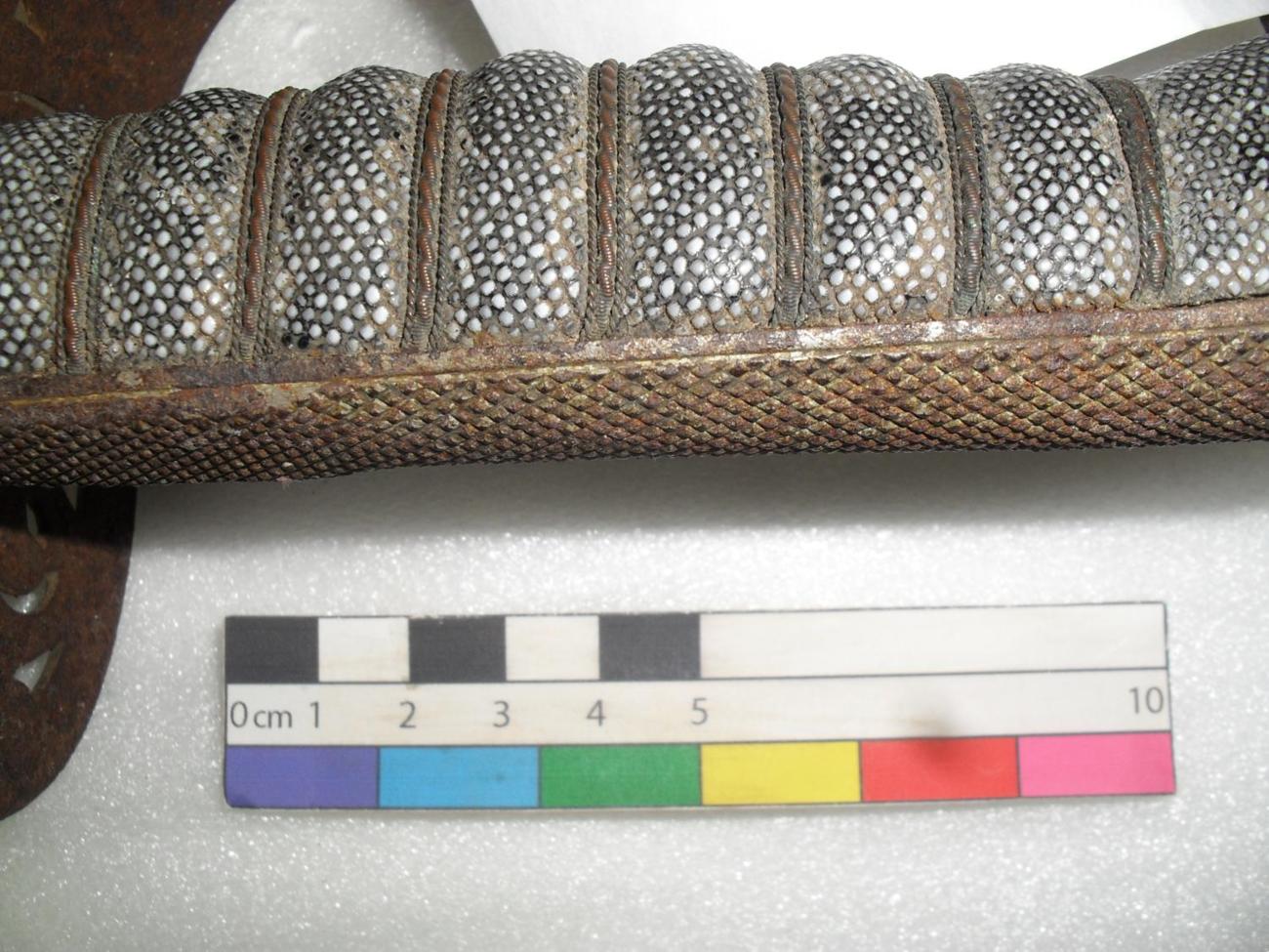

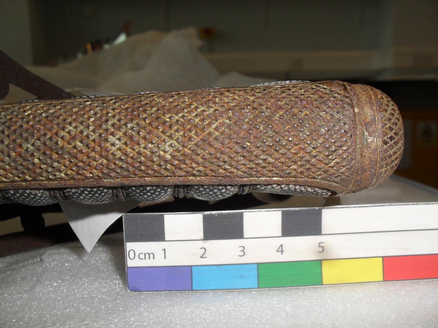

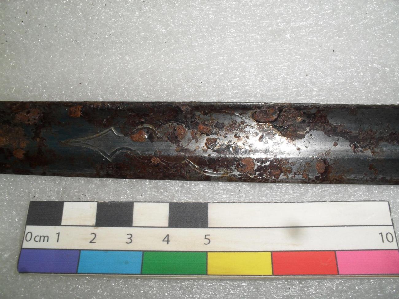

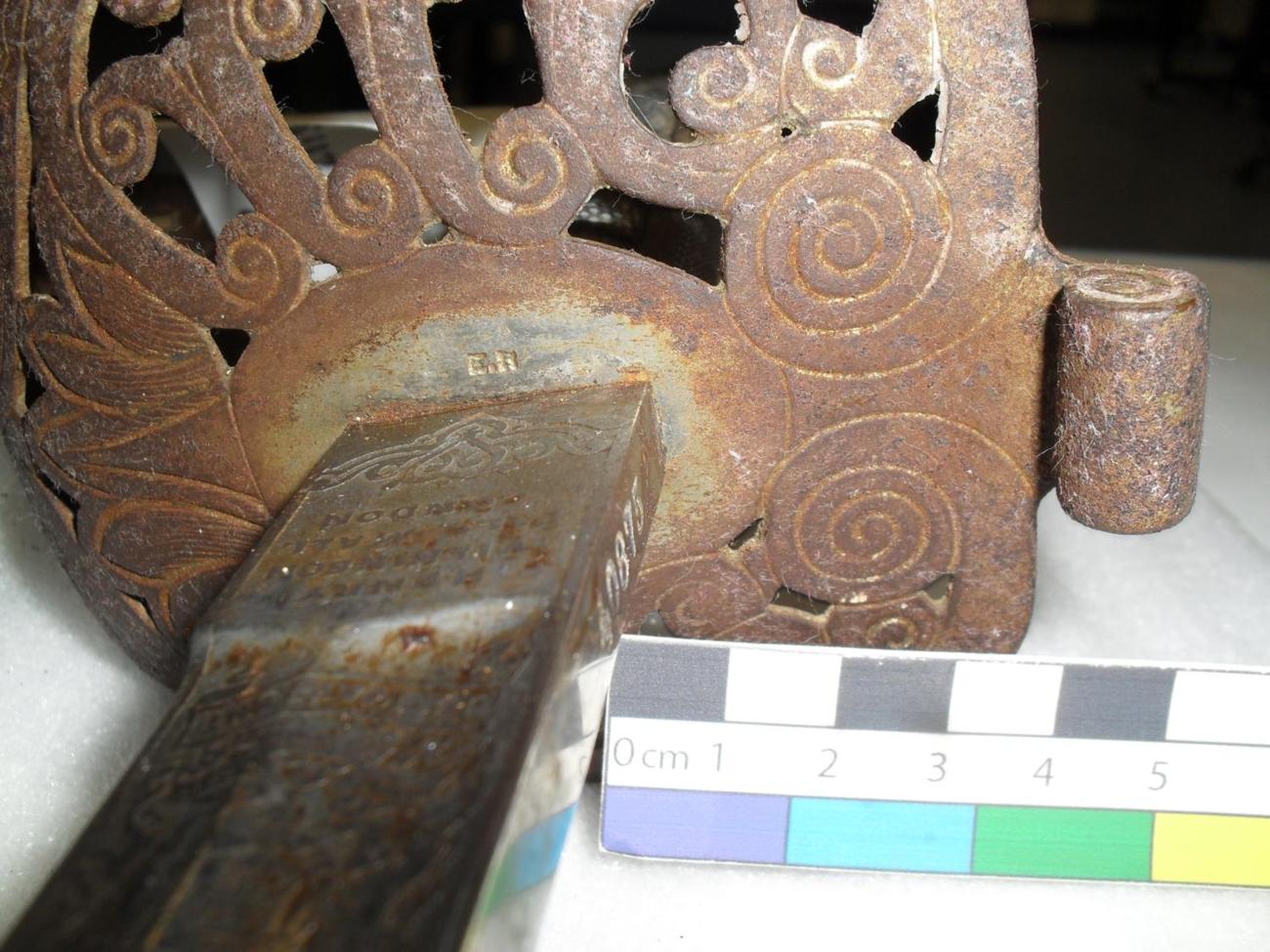

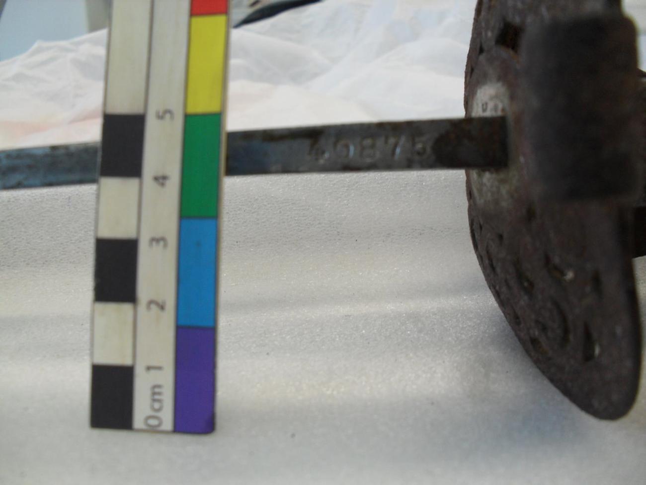

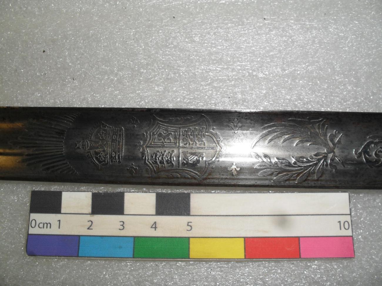

Thanks for your reply. I've attached more photos of the sword.

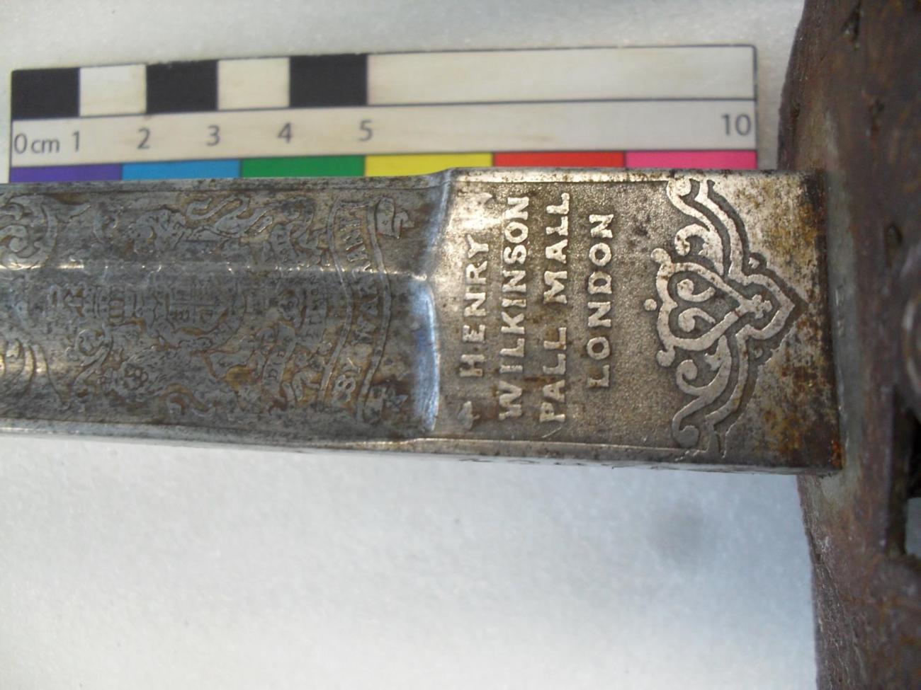

Jonathan Hopkins
PostPosted: Thu 02 Dec, 2010 11:26 am    Post subject:         Reply with quote
Brittany,
How wonderful that it is a Wilkinson! Based on the serial number, 40875, it dates to the early years of the reign of Edward VII (between 1903-1906 according to OldSwords.com). The Wilkinson Proof ledgers still exist, and for a very reasonable fee one may learn the date of manufacture and often who bought the sword. Once the name of the original purchaser is obtained one can then research his career and learn about where the sword may have seen service. I highly recommend contacting www.ArmsResearch.co.uk to see if there is an entry for this sword.
Are you conserving the sword for a museum or for your own personal collection?

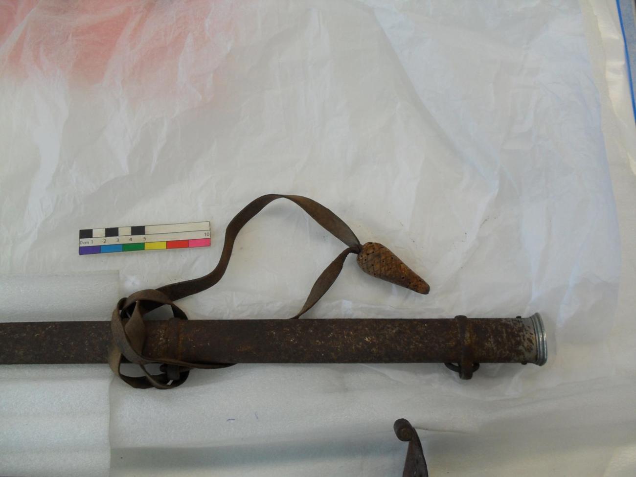

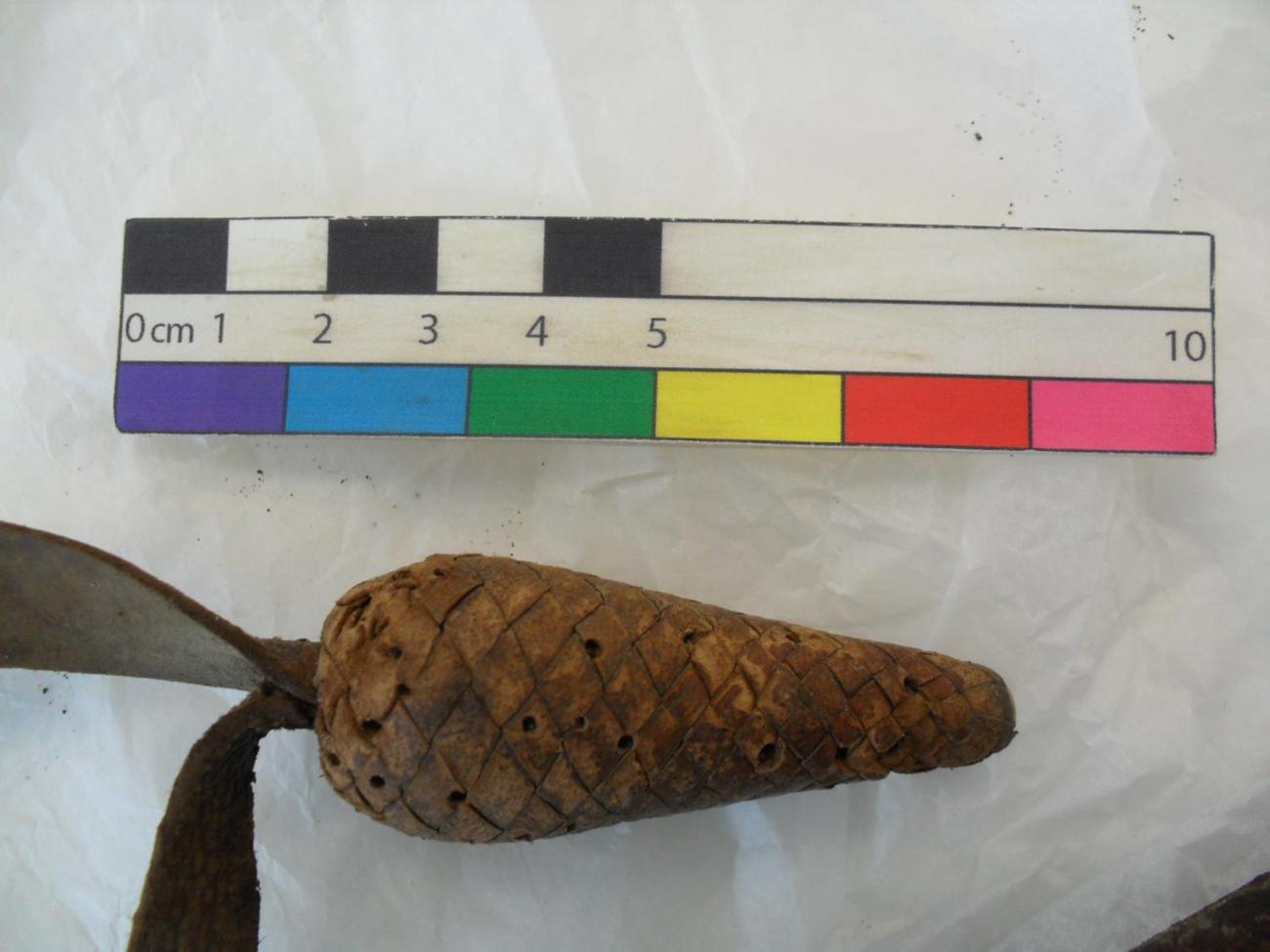

The leather strap is a sword knot and actually belongs on the sword and not the scabbard. Cavalry officers usually let the knot hang straight from the hilt whereas infantry officer would tie it up. For example...

I just got home and had a chance to consult my books--your sword dates to 1906 (serial range 40700-41183).
