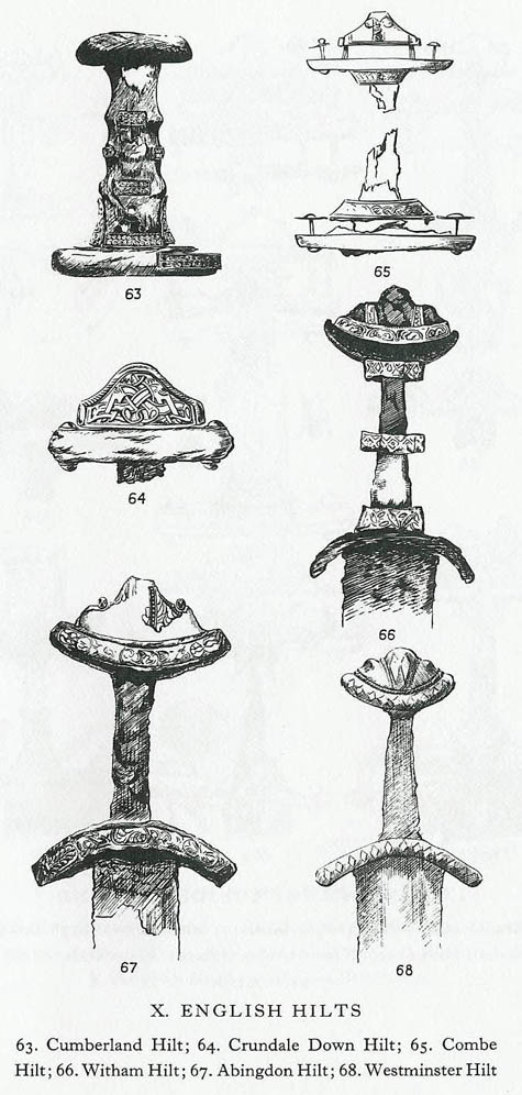

PostPosted: Mon 18 Oct, 2010 9:43 am    Post subject:         Reply with quote
Stephen Curtin wrote:
The above mentioned type I found at Cumberland with filigree and garnet decoration is also mentioned in Oakeshott but there is no picture.
From The Sword in Anglo-Saxon England, by H.R. Ellis Davidson.
 Attachment: 86.62 KB

PostPosted: Mon 18 Oct, 2010 12:16 pm    Post subject:         Reply with quote
Hey Paul thanks for that. I've actually seen this sword in a plate of Osprey's Anglo Saxon Theign. If you've seen this what do you think of their version of it?

PostPosted: Thu 04 Nov, 2010 4:10 am    Post subject:         Reply with quote
Paul Hansen wrote:
Which page? I just leafed through it, but didn't see it...
Plate G no. 11
well at least I think that this is meant to be the cumberland sword
Éirinn go Brách

PostPosted: Wed 04 Jan, 2012 12:50 pm    Post subject:         Reply with quote
Sorry for not replying sooner, but I'm not so keen on the drawing. I think the "pommel" that they drew shouldn't be there. It should be just the upper guard, which is a slab of wood, with maybe a peen block, but no pommel cap, as far as I know.
Also the metal inlays on the Cumberland sword are shown as metal bands, which is not correct.
As a representation of what a "British"/Late Roman Migration Age sword may have looked, then maybe Osprey's drawing is not so bad, with exception of the "pommel", but still given the limited amount of swords found from that period and area, I think it would be wiser to stay as close to the Cumberland sword as possible.

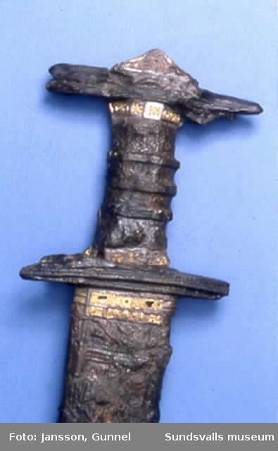

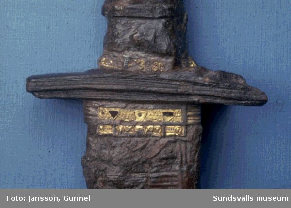

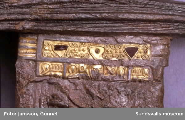

PostPosted: Mon 14 May, 2012 3:20 am    Post subject:         Reply with quote
Hey Kirk, thanks. Do you happen to have any more info about this hilt e.g. date, material its made from, etc? Or better yet a colour picture, if you don't it's ok as knowing where it was found is very helpful, thanks again.
Pictures of the Hogom/Sundersvall sword.
Horn or antler hilt and guards with gilded silver scabbard and hilt fittings. Gold filgree and garnet work on the scabbard mouthband. Some nice foundation moulding and tooled decoration on the scabbard.
Nice little silver gilt pommel cap too, which I'd say dates it to the sixth century; it's a feature you don't see on earlier Behmer Type 1.

Stephen Curtin
Location: Cork, Ireland
Joined: 17 Nov 2007
Likes: 110 pages
Reading list: 18 books
Posts: 1,220
PostPosted: Mon 14 May, 2012 8:36 am    Post subject:         Reply with quote
WOW thanks Mat for the pics, really appreciate it. I agree about sixth century date.
