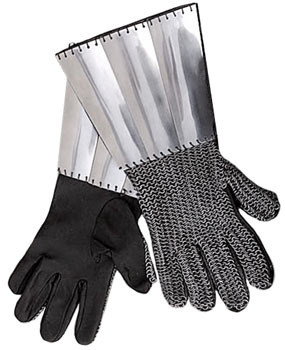

i have found this one on internet, apparently distribuited by a large numbers of different vendors, usually at a low price.

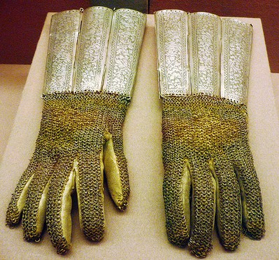

incidentally i have found also a depiction of the original from wich the maker has taken (very loosely) inspiration, even if i don't recall in wich museum they are housed.
my questions are:
someone of you has never used a pair for longsword training? are they reasonably good for this purpose?
from wich period and culture the original are from?

Wow, those are a lot closer to their historical counterpart than I expected!
I've worn a pair of these, and ultimately I don't personally like them. The gloves themselves are very comfortable. I haven't seen an issue with durability, but the leather did not give me an impression of being strong, and it was quite thin. The mail offers some protection to the hand, but really, not much. I still wouldn't want to be hit in the hand wearing it. All of the metal is also heavy. Not super heavy, but heavier than I like, and heavier than say, adding a basket-hilt to a sword. Or at least it feels that way. The kicker for me though was the way the plates on the wrist are set up, they constantly slid down to my wrist joint, and then the edge of the metal dug into my wrist uncomfortably, even through the glove. I have thin wrists for my size, so this may be a factor. The guy who owns the pair I wore never complained about them, and seemed quite happy with them, so YMMV.

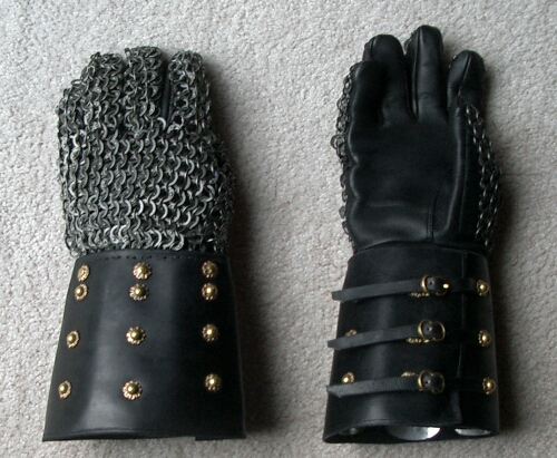

Craig - my friend and student David Teague made a couple pairs of mail gauntlets, along these lines, but much more useful than the Windlass product (those those too could like be modified to work). He started with the padded gloves Revival.us sells, made leather covered, steel plate lined, cuffs, and the overall effect is magnificent:
I'd use them to bout with steel longswords with folks I trust to fight with control. I'm pretty comfortable fighting sword and buckler with them overall.
I wonder if the Windlass ones could have some padding added between the glove and mail to get closer to this idea...

More padding under the mail would make a big difference, and probably wouldn't be that hard to do. The stitching on the gloves is pretty accessible. If I personally were to go that route though, I'd just swap out the entire glove for one with more padding and structure in the cuff. This would make them more durable and help stop the metal cuff from chafing on the wrist.

I was just looking at the pictures again. I think another factor with the windlass ones is that the cuffs flare out quite a bit more than their historical counterparts, so they flop around too much, making the edge of the metal cuff dig into the arm. If it were tighter like the originals, they wouldn't move as much.

looks like if the piece from windlass are not so usable as i have tought, the pair modified by david teague looks more
suitable for WMA purpose, is a good idea. Are the maille that cover the hand, rivetted? it is possible to have a photo that show the leather covered plates, open?

Hi Gabriele,
I made those from scratch. Yes, the maille is riveted, wedge riveted.
Some ideas for making your own.
Buy the dead sexy 6mm maille gloves from Icefalcon Armory for $150. Trash the crap gloves and rebuild it on a set of padded ones.
Buy a set of 9mm riveted maille mittens from Kult of Athena for a mere $42.95 and trash the crap gloves and rebuild it on a set of padded ones by cutting them into fingered maille.
David

I have no idea since I don't practice with steel longswords. But they should stand up to lighter cuts and would look good. The other gauntlets posted here seem more practical though. The plates especialy may chafe at the wrist, depends on how well the gauntlets fit your specific hands since I guess they're not a custom order. Notice how the maille wrist is longer before the plates on the original to clear the wrist?
Also note that butted maille can be far more easily smashed open from hard hits than properly riveted rings, this probably has no serious bearing unless you're intending to perform illegal duels in them, but extended trainign even with lighter blows could wear on them over time. And butted maille tends to slip out of sewn loops of thread over time too, or eat through them.

Obviously eastern europeean, islamic or indian, they all shared a lot of the armour culture and the islamic world exported huge amounts of plated maille to eastern europe during the later middle ages and far into the reneissance even. India had anything you could imagine using, both in weapons and armour and kept producing them into modern times for mostly ceremonial purposes, which meant they often were just butted maille made for show by then.
If I had to really guess I'd say indian and 1800s if the maille is butted. Far earlier medieval or reneissance, and probably islamic export to eastern europe if it's riveted but small fine rings like that.
