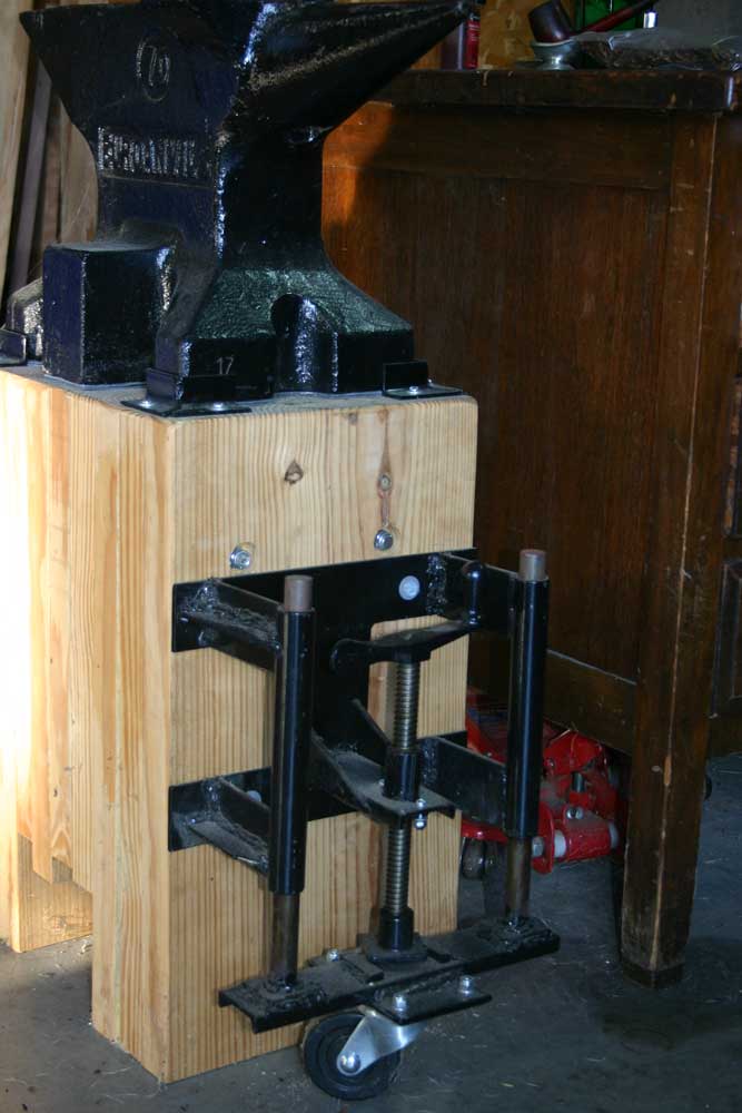

I am really looking forward to hearing how this goes for you. My Diamondback "Knife Maker's model" is sitting here beside me as I type, but I can not open the shipping box yet as it is a "no surprise" birthday present!
If you plan to attempt pattern welding, please comment further as this is my ultimate goal. Alas, a fly press will not be budgeted for another year, and a power hammer will probably not be feasible in my current residence.......
The tri-cycle style anvil stand shown gives excellent portability. My kids can move it out onto the driveway one handed. Oak timber would have been much better, but none was conveniently available at the time. Spring tensioned tie down straps will be added once I can forge some roughly to the shape of the feet. This one is seated on lead. I do not want to wrap a chain around it as this would obstruct access to the upsetting block. The Acme screws are available as veneer presses through woodworking supplies for about $30 each. They are plenty strong even for a 300 lb anvil. I wish my welding skills were better (this was a first welding project.)

The guy I bought the anvil suggected bedding it in sheet metal box filled with sand - this apparently definately cuts down on ring. I'm going to try something like this made with heavy plywood and 4x4's. I'll let you know if it works, I cant see any reason why I can't combine the tricycle with a sandbox.
