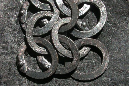

Dan Howard
Posted: Thu 11 Mar, 2010 1:15 pm Post subject: |
Here is a closeup of Erik's German wedge-riveted mail.
Attachment: 67.48 KB

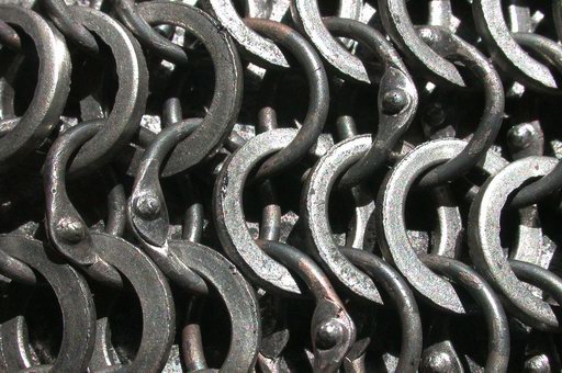

Dan Howard
Posted: Thu 11 Mar, 2010 1:18 pm Post subject: |
Here is his reconstruction of Roman mail (round-sectioned round-riveted, alternating with punched solid links).
Attachment: 57.83 KB
Sander Marechal
Posted: Thu 11 Mar, 2010 1:39 pm Post subject: |
Dan Howard wrote: | Here is a closeup of Erik's German wedge-riveted mail. |
Thanks for the pictures, but are you sure you posted the right picture here? That looks like flat-ring, round-rivet mail to me. Not wedge-rivet.
David Teague
Location: Anchorage, Alaska Joined: 25 Jan 2004
Posts: 409
Posted: Thu 11 Mar, 2010 3:22 pm Post subject: |
Sander Marechal wrote: | Dan Howard wrote: | Here is a closeup of Erik's German wedge-riveted mail. |
Thanks for the pictures, but are you sure you posted the right picture here? That looks like flat-ring, round-rivet mail to me. Not wedge-rivet. |
Sander, Sander, Sander...
You asked for photos showing the "watershed"
Round rivet is historical, the wedge rivet is a later 14th century development (if memory serves me correctly ) and it did not completely replace round rivet mail production in period.
Now for the punch line....
You wear maille with the peaned rivet outward, good wedge rivet peaned looks like round rivet peaned.
The piece in the photo would have to be flipped over the see the wedge.
In closing, don't let Dan drive you nuts, I'm happy with my modern riveted maille as it's lighter than my old butted shirt and looks better. While I do WMA along with Living History , nobody is really trying to kill me with period weapons so the rivets hold just fine, but...
Dan is correct on this issue and it's nice to be able to discuss in a Living History setting on "why" my maille is closer than butted, but nowhere near historically correct. (I've been waiting for years for Dan to offer to buy me a shirt made by Erik so I can be correct, but at this point I've given up hope )
David
