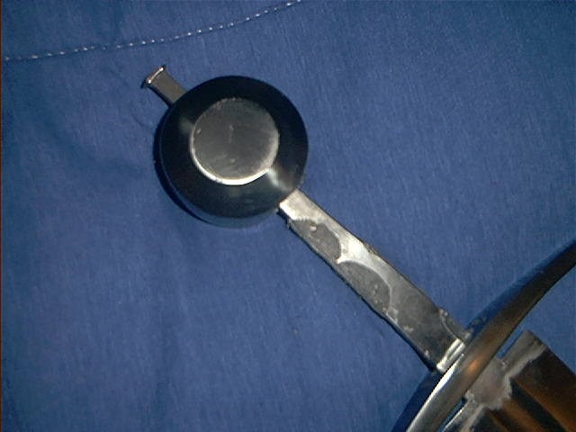

PostPosted: Thu 29 Jul, 2004 11:03 pm    Post subject:         Reply with quote
Okay here are the pics i promised giving some clue as to what is being delt with. I was rather pleased that no rat tail was used, having been burned by those dang things in the past.
 Attachment: 50.03 KB
