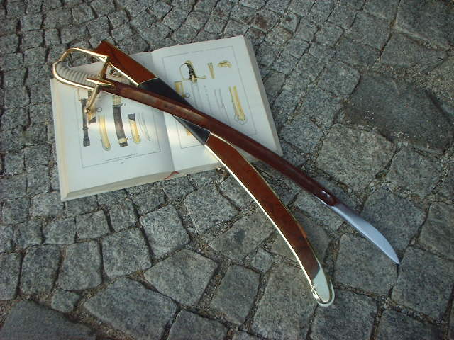

I have a French M1803 Cheval d' Chasseur sword from them - and its...well, interesting. I could also do up something on it. I'll attach an image.. The image frankly shows the sword in a better light than it actually is. This image was taken by Szczepan.
As Russ and I were discussing earlier today, Szczepan's stuff is 'good enough' but no more, and 'good enough' just doesn't cut it in this market place, for custom work.
From a functional standpoint, as a long time sabre user, this sabre is what a sabre is supposed to feel like. however, its got some serious aesthetic issues.

I've heard about this sabre. It has some problems with the leather wrap that have to be seen up close, and I think issues with the blade or hilt components as well.
I had a Studio M sword... the one that was going to be released through SFI's Museum Store, in fact. From a distance, it looked like a nice sword, but up close you could see the problems. Uneven finish on the blade, haphazard fuller with a bad termination, and a spotty leather wrap with poorly aligned risers beneath.

Its a *gorgeous* sword from about 10 feet away. inside about 10 feet, and well..umm... yeah... not so good. part of the problem is that all the photos I got from Szczepan failed to show any of the problems with the sword. oooooops.
I don't want to talk about it too much until I hear something about whether Nathan would want me to do a full write-up, since I know he's not keen on publishing stuff twice. I had a review mostly ready some months back, but law school sort of intervened and killed my free time.

The hell of it is that he probably would have been very successful as a sword *designer,* because he knows what the weapons are supposed to feel like. I've shot my mouth off here and there saying that I've never met a swordsmith who does a good job on both sabres and swords... that's because in my region, there's a feel to the sabres that I've never found in a sabre made here stateside... but Sczepan's blades have them. The fittings, finish, all that, is separate, but the man knows what they're supposed to be like, and in that respect it's a real shame he's moving on in life, because he could have been the next best thing since sliced bread.

Yeah Russ, thats the hell of it. these sabres are *right* 100% in feel. its dead on.. doesn't feel like any other swords I've ever handled. It's a shame - but with all the other issues, well, I'm not surprised. He should have been designing them, and letting someone else do it. the dynamic balance on this blade i have is dead on - something to do with the multiple points of rotation, and the way you transition back and forth through them, I think. My M1860-shashqa-thing has it as well... that 1796 you've got...well, doesn't. bleh!
Its sad, but no shock, considering. I just wish I'd gotten a karabela off of him first.
Nathan: please do send me a template, it should make things much easier for me, and I'll see what I can do about pictures - I dont have much by way of a digicam, but with some luck I should get some decent shots. I'm in the process of working on the edge, along the first third of the blade, so its a little shredded looking, but heck, its an armory grade piece anyway. quite nice, if it was what one was expecting. sigh.
