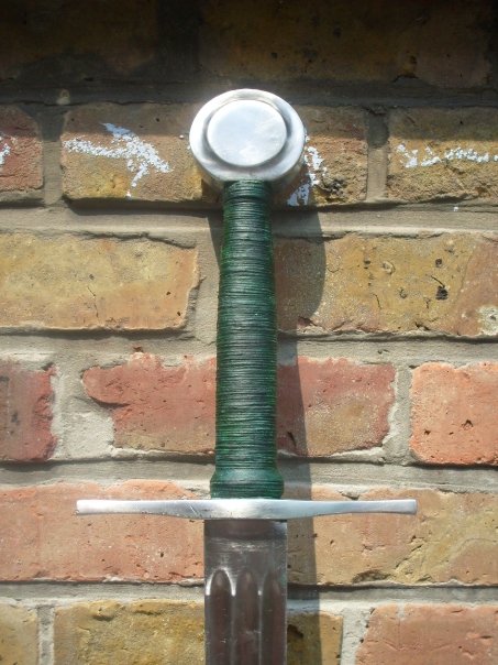

That's a great tutorial Ron, I'll follow your steps on my next wrap. I didn't wet my chamois and it shrinked a lot after dyeing, so much it barely fit the hilt. Your method can prevent this.
Sean,
After reading your posts and Ron's tutorial, I'm beginning to think it's the dye - chamois combination. I'm going to look for feiblings dye. strangely it's hard to find in europe.
both of your work is fantastic, hopefully my second attempt will be better.
I included a pic of my grip. I intentionally used an uneven cord for the cordwrap.
Attachment: 66.94 KB
Sean,
