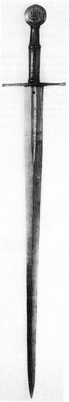

I guess I should have posted more of my sources in the first place. I did take a look at many pictures of historical swords from the period / area. I also looked at period (well, not really, cca 80 years earlier) depictions from the area I want to represent (Illuminated Chronicle, and german trained knights in Hungary). I'll attatch some of these pictures with comments to this post. The grip is the only thing that I based on the modern windlass sword. If it is horribly inaccurate however, I won't hesitate to go with a full leather one. Also, as you can see in my first post, I wasn't really satisfied with the pommel myself. Right now I'm thinking about ditching the whole half wire thing, and going with a grip / pommel similar to the swiss sword that is attatched
I was also aware that the edges were too parallel on the drawing as I tried to explain with "It should probably be more pointy, and narrow a bit more drastically". I'll consider some english courses . The smith I intend to contact is Peter Regenyei (http://armoury.sword.sg18.net/]. He was recommended to me by a reenactor friend, and also the biggest (possibly only?) hungarian sowrd school, the Order of the Sword recommends him on their website. Based on this, and the amount of swords he has made, he should be pretty knowledgable about them. I shouldn't be able to distract him by a not so accurate drawing. I intend to leave the overall weight, hardness of the blade and other stuff that I can't possibly have an idea about up to him.
Frankly I'm somewhat more interested in the handling chatacteristis than the authenticity, my primary goal is to learn the martial art. Do you think a blade with this kind of profile would be floppy, or more rigid? Does anyone has an idea about the squash racket / sword balance comparison?
Attachment: 3.35 KB
Supposedly a swiss late 15th cent. sword, one of the first hits off google. The length of the crossguard and the grip is based on this.
Attachment: 76.5 KB
Some pictures from the Illuminated chronicle show similar fuller length and cross guard shape to what I imagined. The grip / blade length suggests a longsword, but the guy holds a shield with it, so I'm not sure if it's good reference.
Attachment: 35.08 KB
Attachment: 48.85 KB
This is what I based the blade design on. (diamond cross section, fuller cca to 1/3) Supposedly early 1400's Not sure about the origin, the pic comes from a hungarian whitepaper that explains the Oakeshott typology [ Download ]

In several of the pictures that you posted, in particular the Illuminated Chronicle, it appears that there are raingaurds on the sword. Is that something that attracts you? Like Nathan Robinson said, I would look at historical examples. Do some research and I would recommend finding a particular piece that you like and make an accurate replica of it. (Could get expensive though.)
You said that you are interested in handling characteristics, but I have to ask: What would handle better than an original that was designed to be used for this form? If you are planning on learning I:33, I would have to say, "find a sword from the height of the I:33 period and base a replica off of that." Whatever form you are going for, try to get as close to the historical original as you can.
