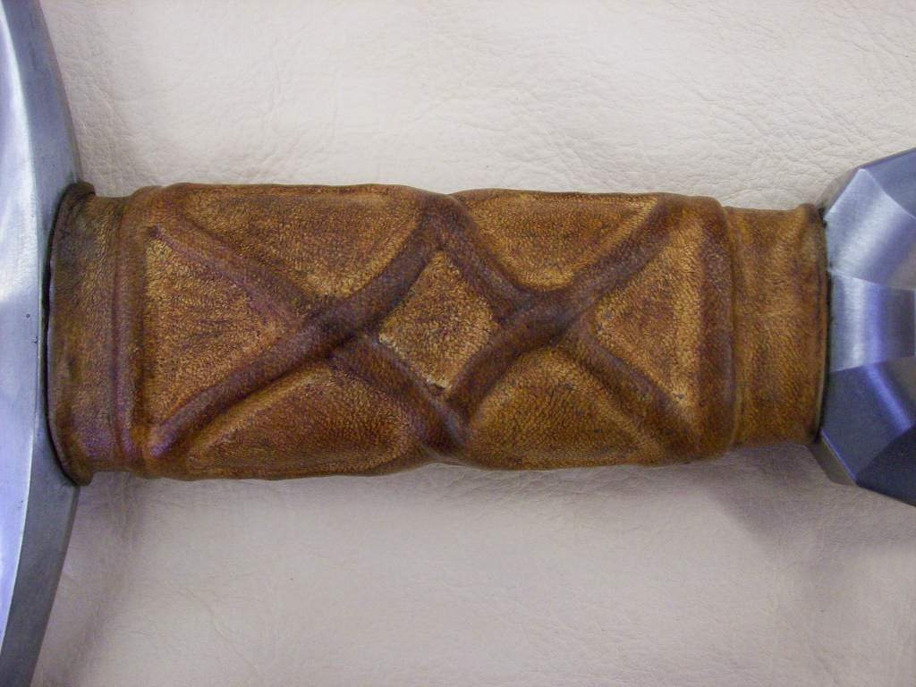

I decided to experiment with doing some nice risers on the handle, I think it turned out really well, all though not being 100% historical. If someone is interested in this blade but wants the grip to be stripped and regripped plain, it can be arranged.

Thanks for all the positive feedback guys. Sorry I wasn't around sooner, I have been finding a good shop rhythm the past couple of days and two 12 hour forging days have sucked me in. I'm glade to hear that my work is getting some recognition, although I think I may be redoing the grip on this one since it appears a little too bulky. I think it feels pretty good in the hand, but visually it competes with the pommel, and it was pointed out to me that a grip being too large will hinder performance. Never too late to make things better!

Might wait for more grip feedback, could save you work. fwiw my vote is it does not take away from pommel. I also liked the similar risers you put on "one of 8 seaxes". As long as could have been done, & (if) works functionally, nice subtle-enough unique addition. But maybe I'm wierd, get more votes? Until a buyer provides trump vote.

Very true Carl, I am going to wait for a bit with doing anything to the grip since I have a couple of things that have priority right now. But in a few weeks when I get caught up and have an open schedual I might consider tweeking out some pieces that are hanging out on the rack that haven't moved.
