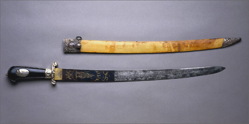

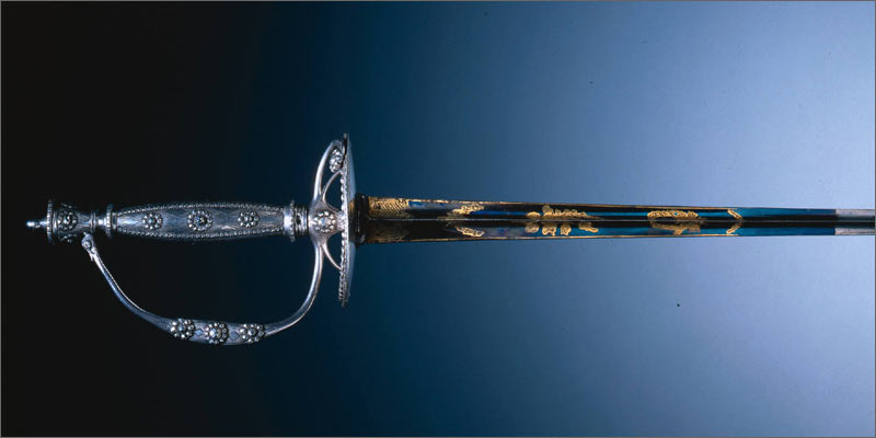

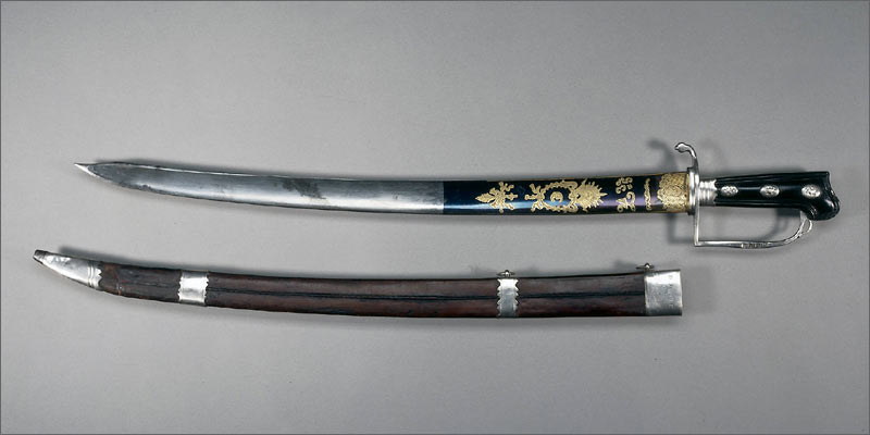

Jeremy V. Krause wrote: | There is no evidence that historical blades would have been created to have this effect. |
Unfortunately, your statement is much too wide-sweeping to be accurate. Many, many sword blades from the historical record can be found having bluing effects. Having said that, it must be noted that a great majority of these items are from a later period than is being discussed here.
Please note these examples.
Attachment: 30.6 KB
![William-Kinman-Hunting-Sword-1778-1779.jpg](files/william-kinman-hunting-sword-1778-1779_211.jpg)
Hunting Sword, circa 1778-1779
Attachment: 28.75 KB
![England,-London-or-Birmingham,-c.-1790-Court-Sword-c.-1790.jpg](files/england_-london-or-birmingham_-c.-1790-court-sword-c.-1790_200.jpg)
Court sword, circa 1790
Attachment: 37.02 KB
![France-(blade-possibly-German),-c.-1780-Hunting-Sword-c.-1780.jpg](files/france-_blade-possibly-german__-c.-1780-hunting-sword-c.-1780_120.jpg)
Hunting sword, France blade-possibly-German) , circa 1780
Jeremy V. Krause
Posted: Thu 21 Aug, 2008 3:54 pm Post subject: |
Yes Nathan,
I did think about editing my post to point toward the swords of the early 16th and later examples, but I felt it might confuse the original question and the direction of the line of inquiry. These beautiful examples you show demonstrate a type of decorative blueing along with gilding on the upper 1/3rd of the blade and are not on the business end. Also I am uncertain if these examples employ blueing on the cutting edge.
Swords prior to 1400 have shown no evidence of purposeful "blueing" though and I really don't believe that the "blue, purple" seen on older blades is related to the "blueing" on later pieces.
In short- you are absolutely right- but maybe this question could be confused by such references,
Jeremy
