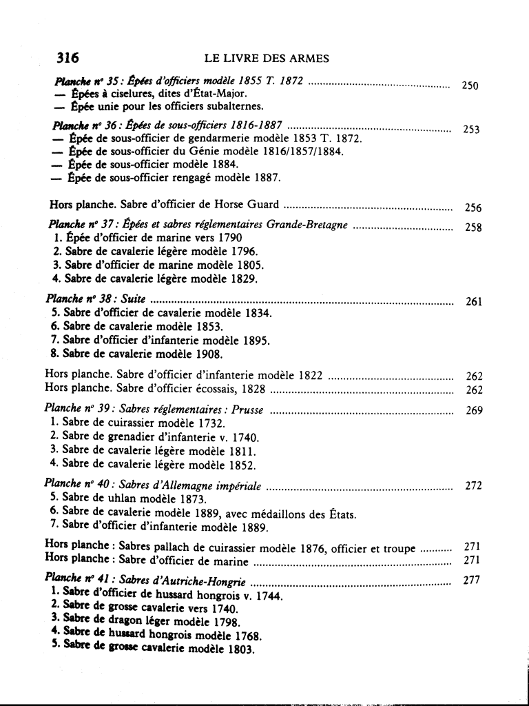

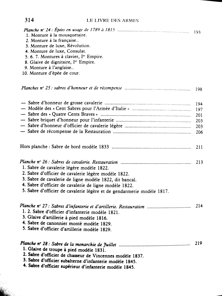

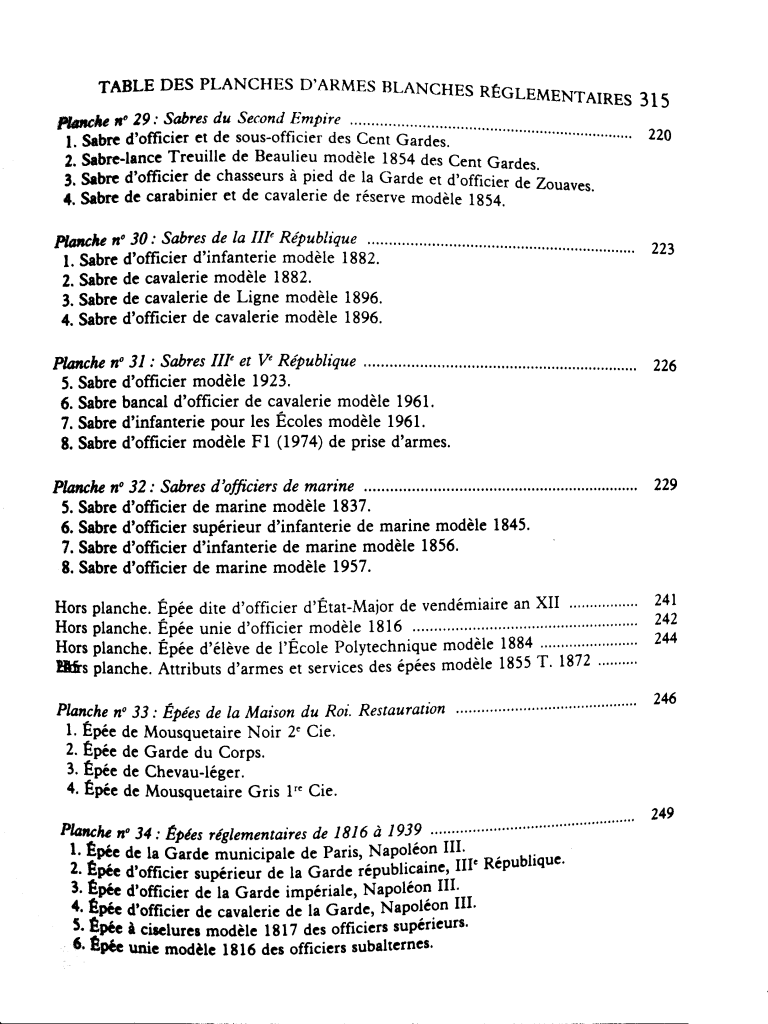

Vincent Le Chevalier
Posted: Mon 28 Jul, 2008 1:35 pm Post subject: |
Hi Gabriele,
Here are scans of the index of the plates I have. For the post Napoleonic period I think you'll be looking at plates 26 to 36. Let me know if there are specific plates you'd like to see in full, or if you have a problem with the language...

Posted: Tue 29 Jul, 2008 1:50 am Post subject: |
Hi Vincent,
great work thanks a lot!
The list is perfect and easy to read. If you can please post some pics of the following patterns:
Marine officer model 1837
Infantry officer model 1845 and 1882
cavalry officer model 1882 and 1896
cavalry trooper model 1882 and 1896
thank you again
gabriele
