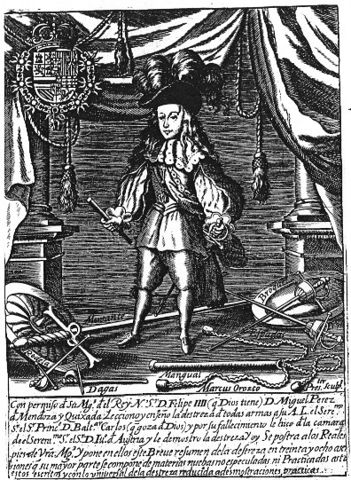

I can give you some specifics from the Iberian material.
In 1675, the Spanish fencing master D. Miguel Pervez de Mendoza y Quixada published a book of commentary on martial arts (Resumen de la verdadera destreza de las armas en treinta y ocho aserciones), which includes a section on the flail. The flail he is referring to is a two handed weapon, with three chains and heads. The heads in the frontispiece picture do not have spikes, but I doubt that affects the use, other than making it safer to practice. He discusses some of the construction and use of the flail. In use, he says that the blows are the same as the two-handed sword (montante), except that you can't thrust (these are overwhelmingly downward angled blows, not rising); keep the hands in front of the body, and use the wrists to the extent possible; stable footwork is *really* important. He also decries the short shrift that two handed weapons have been given by fencing masters, pointing out that even those who do teach or discuss them tend to only do so cursorily. Even though he was the head fencing master for the kingdom, well into the verdadera destreza period, he gives the impression that the two-handed weapons are his favorites, and are what separate the men from the boys.
One of my metal worker students has made several flails for us to practice with, agricultural flails, single mace like head, and a copy of the one described above. The three headed was actually the easiest to use, and I suspect this has to do with mass distribution, using three chains rather than one. Obviously a heavier single chain could be used, but we don't have one of those, so please remember that this theory is only semi-informed conjecture.
In practice, I have found a few other tips. A little practice at keeping the flail in motion goes a long ways - and keep it slow until you are comfortable. Changing direction is hard, but easiest if the path of your blows is more vertical than horizontal. There are two good ways to stop the flail: 1) hit something, adversary, pell (I use an old rusty car), ground, etc; 2) stop in a tail guard. Once you get this far, you won't hit yourself much, and that will mostly just be bounce back after hitting something, and that really doesn't hurt. Well, it might with spikes Eek!. Circling in a constant direction and hitting something over and over is very easy, and produces a huge amount force. We put old armor on a human sized pell, and an unspiked flail just tore off piece after piece of armor.
You will notice that in the picture, the chains are as long as or even longer than the haft. This worried me at first, but in fact the hands seem fairly safe from harm. Most flails and flail records I know of (which aren't many) have longer hafts than chains, though apparently longer chained infantry flails were common in south east Europe. The length of the chain and head relative to the shaft definitely affects the handling. I have some ideas about this, but I don't have enough experience with the shorter chains/heads yet to say much in public about it. Sorry. Any two handed flail is almost certainly a footman's weapon, not a horseman's.
I've attached a copy of the frontispiece picture I mentioned above.
 Attachment: 137.34 KB

Many thanks guys for the great information on the various types of flail and the use of them - absolutely fascinating! I really appreciate it Happy
and thank you Eric for the wonderful info on the Spainish Mangual. Did I hear right that you reconstructed this weapon and tried it out on an old beat up Camero and it's on video? Wow! if so that sounds awesome, is it on Youtube by chance?
Would love to see this weapon in action. Cool
