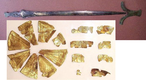

Actually I made two mistakes on this post...
The sword in question was not only Gundlingen (rather than Mendelheim) but it was in Grave 299 rather than 99.
The TOMBA site also has a color image of the sword as well as the gold foil.
The sword is 72.5 cm long and the bronze chape is 14cm wide
It dates from Hallstatt C1b (730-660 B.C.) The grave has a mixture of both male and female grave goods. It is believed that it is a mix of two graves 299 and 295 which is situated directly above.
Grave finds now in Museum of Natural History Vienna Austria
ks
 Attachment: 98.71 KB
HaC1b.730-660.Guendlingen.L73.HallstattAustria.SalzbergGr299.GoldFoilFromPom.Bronze chapeL14.MuseumNaturalHistoryVienna.TOMBA.jpg
Gundlingen sword with gold foil from "mexican hat" pommel. Grave 299 Salzberg. Image source TOMBA

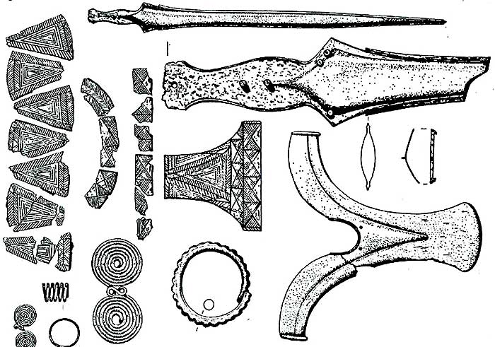

Image from "The Hallstatt Sword of Bronze: on the continent and in Britain" by J.D. Cowen

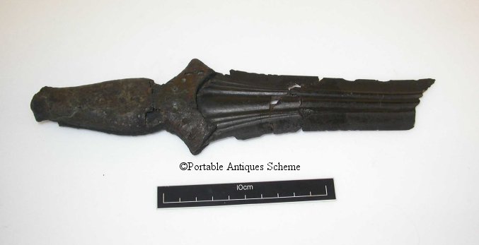

PostPosted: Fri 26 Jan, 2007 10:25 am    Post subject: Mindelheim from the UK!         Reply with quote
Neil Burridge just send me an image of a mindelheim sword found the UK, the first one I've seen so far. It was found as part of the Llyn Fawr hoard, after which the last period of the bronze age was called (Llyn Fawr phase, 800-700BC). The sword is generally described as being iron, and the earliest occurence of iron in the UK. However, Neil noticed that the blade can never be iron, but has to be bronze. And I agree. The blade is far to crisp to be iron, and the patina is also typical for bronze. However, the hilt plates do look like they're iron! That's a pretty unique combination. So far I've seen bronze mindleheims with bronze hilt parts, iron mindelheims with bronze hilt parts and iron mindelheims with iron/bronze hilt parts. The blade looks very nice on this one, very close to the blade on the Kemmathen sword which Neil is selling.
One note: please don't redistribute the image. Neil asked for special permission for me to use it.
