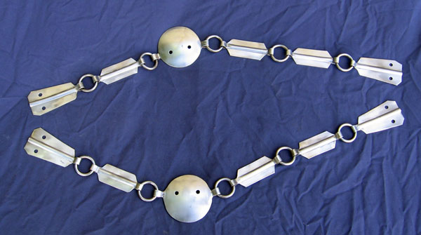

Having just recived a fine set of ' jack chains' from Patrick Thaden
I'm pondering how to attach them a jack. Clearly they should be attached with points as shown in various period images and I'm going to try points of both linnen and hemp to find out which works best. But how were the points themselves attached? I doubt that eyekets were made in 10, 20 or even 30 layers of linnen cloth or through a thick layer of raw cotton. Were the points simply sewn onto the Jack at the best spots?

PostPosted: Sun 16 Dec, 2007 4:34 pm    Post subject:         Reply with quote
Does this picture help at all?
