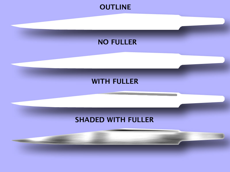

Concept drawing of seax:
Attachment: 67.84 KB
Hugo Voisine
Posted: Mon 03 Sep, 2007 8:46 pm Post subject: |
Jean, you should become a concept artist.
Posted: Mon 03 Sep, 2007 9:20 pm Post subject: |
Hugo Voisine wrote: | Jean, you should become a concept artist.  |
Sometimes I am for my " custom " projects.
Did this one for Étienne but if I decide to have a seax made for myself this could be it !
Although I might make it into a langseax and add a couple of inches to a 20" blade but for a knife sized seax a 17" or 18" blade is long enough.
One thing I've mentioned before on another Topic thread about the seax is how much this type of broken back seax looks like a Bowie Knife.
The main difference being that I don't think the seax had a sharpened clip like most Bowie knives have or at least an uncharpened false edge bevel.
Oh, any style, historic or making advice for Étienne would be appreciated keeping in mind that he has very little cash to play with and only limited access to tools but he is starting out well by doing some serious research and might become one of our industry makers a few years from now.
Peter Johnsson
Posted: Tue 04 Sep, 2007 2:41 am Post subject: |
Some thoughts:
Jean, your rendering has the look of a seax that is 1/2 or 2/3 of the size that is intended. Such dramatic proportions would make a blade of this size strange in handling, I think. You do see broken back seaxes with rather this profile, but my impression is that they are generally smaller.
A broken back seax of this lenght would have less widening towards the "hump": only slightly a very slight widening or even paralell sides and a rather narrow profile.
If you go with paralell sides, and a narrow profile with thicker back (8-10 mm) would be approproate.
A wider profile with moderate widening towards the "hump" might work with a slimmer back thickness (6-7mm?). I am not aware of any historical examples of Anglo-Saxon seaxes of this length with wider and thinner blades. But I may well just have overlooked them.
The cross section will have an influence on the thickness of the back (or the other way around): A more flat and triangular cross section can (and perhaps should) have a thicker back.
The fuller, or groove would typically follow the line of the back (as it is associated by the line of the back, rather than the blade centre or the edge).
Fullering can be a single groove, twin or tripple.
There is not much distal taper, but normally there will be some: a taper from base to crown of clip point, or "hump": perhaps 1,5-2 mm. There is also a natural tapering effect created by the clip point, as the slanting line of the back cuts through the cross section (the trick is often to keep the point from getting too thin!).
The tang length of the broken back seaxes of "Honey Lane" type (the ones that widen more dramatically towards the start of the clip point) are shorter than those found on the "Hurbuck" type, (the type with a more narrow outline and more or less paralell back and edge: also note that the "Hurbuck" type of broken back seaxes might have a concave edge: a downwards curve in the point part where the clip point start).
These are just recommendations in a general way. Each original seax you see would be a variation to this theme. As this blade is perhaps more of a dream come true project, rather than a strict interpretation of the historical material, you might use historical example as much as you think makes sense.
I do think that there is correlation between size, cross section and profile on these weapons. As these blades rely on mass distribution as a result of outline and cross section for their heft and balance, it might be a good idea to glance at the historical conterparts: they worked after all.

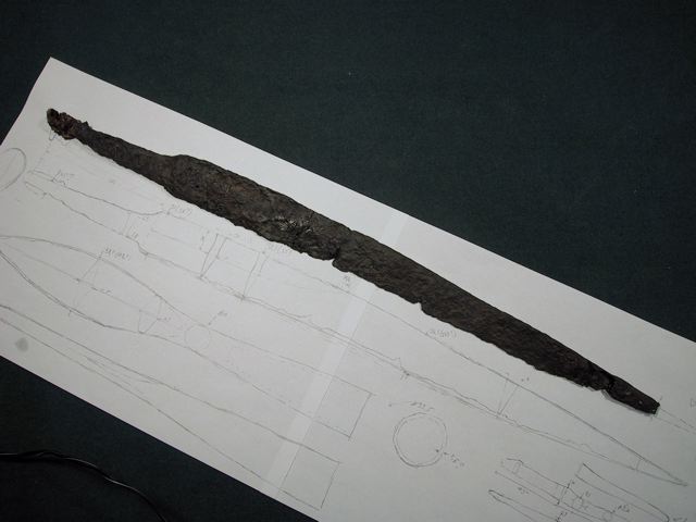

I attach a completely different seax, that I worked with a few years back. It belongs to the early narrow type, but has an unusual cross section and profile. It is fairly long, but still has a grip that only makes room for your hand and little more. We know the grip was short since the end of the tang was folded over the end of the grip. This blade is 10+ mm at the thickest part, right at the start of the "clip point". Notice also the concave curve of the edge: a drop of the point at the start of the clip point. This inverse curve is a natural result of heat treat.
A hefty blade that belies its visual impression: it loks like a narrow skewer, but does deliver a pretty formidable blow while also being a respectable mail link splitter or leather awl.
Attachment: 37.31 KB
Original blade with the tracing
Attachment: 20.9 KB
Reconstruction

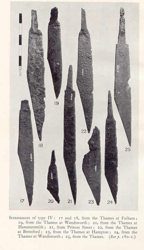

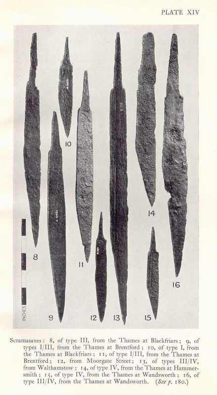

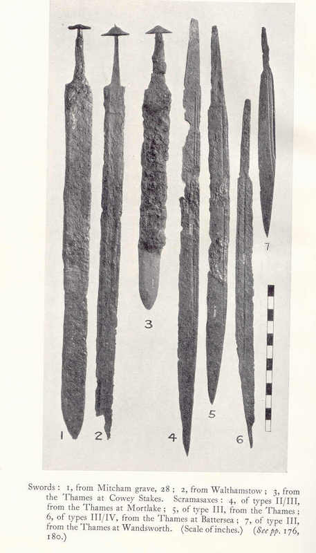

Some additions to Peter's comments: From the examples of broken back saxes I've seen, the width is fairly constant independed of length. Longer saxes are just stretched out lengthwise. I also notice a beveled edge in the drawings. The original broken back saxes had a triangular cross-section, with no additional bevels. The fullers, which aren't very common, generally run parallel to the spine of the blade.
Below are some examples (from my zipfile: http://1501bc.com/files/information_about_saxes.zip)
Attachment: 36.26 KB
Attachment: 39.11 KB
Attachment: 35.61 KB

Peter Johnsson
Posted: Tue 04 Sep, 2007 4:27 am Post subject: |
Jeroen Zuiderwijk wrote: | ...
Thanks Peter! That's quite an unusual sax. Where was it found?
Hi Jeroen,
The seax was found in a warriors grave in Tomteboda, Stockholm. A new central hub complex for the national Post was to be built and the site chose had an old burial ground. One of the graves was that of a warrior: a lance, a seax, a fire steel (of awl type) a buckle and a brooch was found.
The dating is uncertain. The lance was of a type that seems to hint at early Vendel period. The seax is also of unusual shape and is therefore difficult to use for dating the grave.
I got to make reconstructions of all the metal objects in the grave. These are now on display in the entrance of the building. The grave is reconstructed below glass in the floor and the objects on display in cases. An interesting project.
The grip is a guess, of course. We kno only that the wood was probably maple and probably burly maple. It had some kind of element added with two rivets at the end. The rivets were preserved as small hubs of rust. The guess is that a reinforing bad was riveted in place. This is a feature that can be seen on other seaxes. It migh have had some kind of mounting at the blade ond of the grip, but no remains of that was left. The grip could also have been covered with leather, as some of the seaxes from the Vende/Valsgärde find show. There was nothing to support this, so the grip was left bare. It might be *less* authentic because of this, but we wanted to keep guesswork to a minimum. Obviously there was no carved decoration made in the grip. This might have been more or less universal for these weapons, as those that have grips in good enough preservation very often show traces of different kinds of decoration.
As to cross section of seaxe, yes, it is mostly triangular. *But* you will find examples where the trangle is pretty "fat", almost so much so that the cross section looks like a "house" with bulging sides. The "edge bevel" is not marked, but well rounded, so it blends into the cross section. You could describe the cros section like a gothic arch. I have the impression that this is a more common feature on those seaxes that are long and narrow in profile. It makes sense as you might want this extra mass for the narrower blade.
-Or go with an extra thick back.

Oh, thank Peter for all the information as my " rendering " is more what I would like aesthetically than a carefully researched historical seax. Since this is Étienne's project he is the one who has to decide how close to historical he wants to be.
The blade in the drawing may look very wide but it is supposed to be only 2" wide at it's widest and 1 1/2" just before the tang. The fuller being parrallel to the back rather than the the bevel line is a subtlety I wasn't aware about and I could redraw it that way if Étienne need a drawing to visuallyse it. ( I usually can just picture things in my mind without needing a drawing if it's just for me ).
I could reduce the width of the wide part making the blade almost but not quite parralel and have the clip start much earlier on the blade as with the example who have been kind enough to post.
Maybe I' ll wait until I get Étienne's opinion before I draw another modified version with no bevel or a rounded one that blends into the main side of the blade or gothic arch. ( anyway wait a few days or draw it just for the fun of it " sooner " ).
Oh, I also appreciate the respectful way you corrected what are historical " inaccuracies " by not assuming that my design intent was completely historical. Must admit to being " heavily " influenced by " modern " Bowie knives " and what I like and have designed in the past as custom knives i.e. huge scary Bowies 3/8" thick stock.

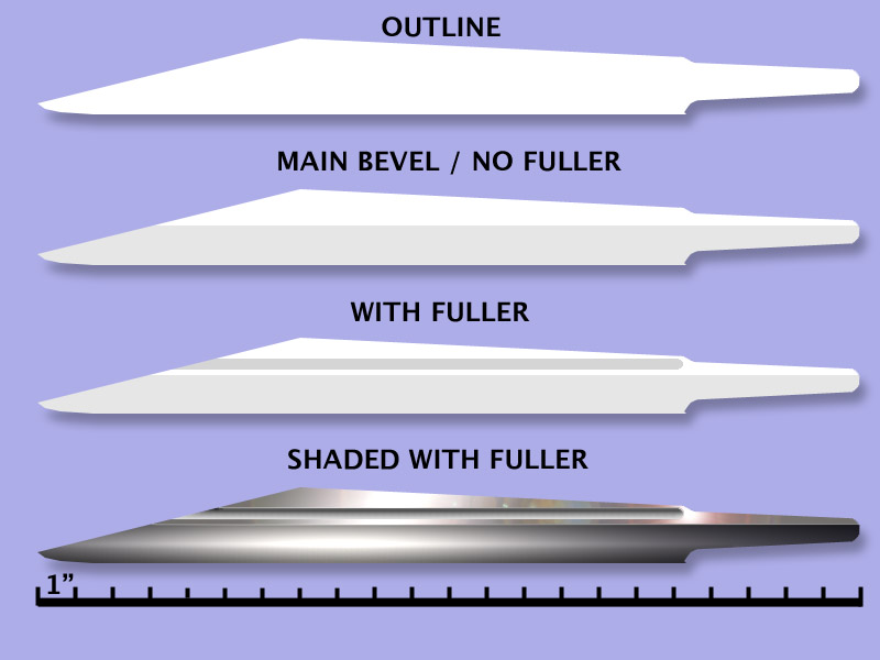

Just did a new drawing using the imput from Peter Johnsson:
Attachment: 66.45 KB
