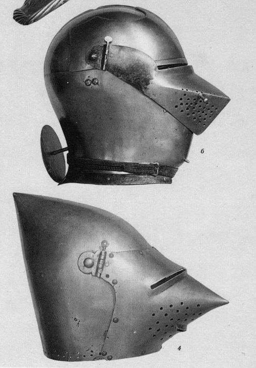

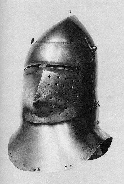

Here are some pictures of helmets from Musée de l'Armée, they are all (1-4) registered as been from the 14th century. I guess number 2 is what you are looking for?
#2 looks more like a great bascinet to me than an early bascinet. #6 and #3 (numbers within the pictures not the actual order) are not basinets, at least according to me (I know you are not saying that they are). #6 is an armet, and #3 is a barbut with a visor.
The last basinet with the sheet metal aventail is a peculaiar example. There is another similar one in the Dodge's palace in Venice.
#4 (item number H21 in the museum inventory) )is a "typical" pig-face bascinet. I really like its the proportions.
thanks for posting these.

Another informative post from Brian Rainey of the ARS
Søren Niedziella,
On the helms you posted, all but one (possibly two) are from well into the
15th century:
1. This helm is a 15th century helm, most likely 1425-1450. It is of
Italian style, but could have possibly been made elsewhere. The visor
does not belong to it and is now displayed as a seperate and distinct
piece.
2. This helm is also of 15th century origin. This would not be the type
of helm that Greyson is looking for... being up to 80 years AFTER the time
frame he mentioned (1440s). While the visor and helm appear to be
authentic, I have doubts as to whether they go together.
3. Ths helm is a 15th century armet... not even close to a style of
bascinet or 14th century helm. I am wondering if the book you refer to
sis not actually classify these as 15th century helms, rather than 14th.
4. This IS a 14th century helm of a fairly standard pig-faced design.
Most likely dated in the 1370-80s. There are some oddities about this
helm... but it is not relevant to the current context.
5. This is a 15th century great bascinet with a pig-faced visor
(1400-1415). The rivetted neck plates would lead me to believe that this
helm was once a standard bascinet that was retrofit to the great bascinet
style. As such, parts of this helm could have been made as early as
1470-80. I also have doubts as to the authenticity of the visor/helm
combination. They may not belong together.
Cheers!
