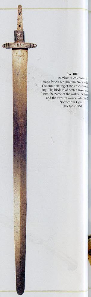

While there are definitely some examples of straight bladed swords with canted hilts (e.g some Sassanid cavalry swords), those examples from the film you posted look like they are based on some of the straight swords attributed to early Muslim figures in the Topkapi, and my understanding is that those are probably old blades that were re-mounted in "modern" fashion during the 16th century.
I've attached another example, but it's missing the (organic?) grip and maybe a pommel cap.
 Attachment: 41.96 KB
Image may be reproduced provided source "Turkish Military Museum Collections" is quoted. [ Download ]

Thanks Adam, I think I had seen that one before (or at least one very similar) but had forgotten about it. I am particularly interested in specimens with a central fuller. That's interesting about the rehilting...I had wondered if that might be the case. However, aren't there examples of straight bladed weapons with canted tangs (palashes though single edged come to mind ). Might some have been made that way originally for a similar purpose?

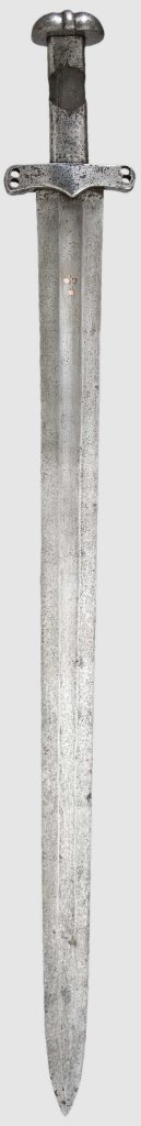

Hermann Historica had a sword for sale a while ago which may be of interest here.
http://www.hermann-historica.de/auktion/hhm56...at56_p.txt
Lot Nr.406
A Mameluke sword
Egypt or Syria, 14th century
Strong double-edged blade with a shallow fuller on both sides and at the base of the blade three copper-inlaid dots, the fuller on one side shows remnants of a rubbed engraving. Iron quillons, the ends each pierced with two holes. Leather-covered grip with long, iron grip sleeves, under the pommel an eyelet with appended, ten-sided ring. Iron pommel. Length 93 cm.
Cf. also two similar examples in the collection of the Furusiyya Art Foundation, exhibition catalogue Paris 2007, no. 11 and 12.
 Attachment: 19.17 KB

PostPosted: Wed 09 Sep, 2009 3:30 pm    Post subject:         Reply with quote
Thanks, that one is very interesting,
Dan

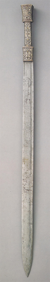

PostPosted: Sat 12 Sep, 2009 8:24 pm    Post subject:         Reply with quote
Here are 2 more swords:
http://www.sothebys.com/app/live/lot/LotDetai...=159270811
http://www.sothebys.com/app/live/lot/LotDetai...=159516681

Thanks Danny, that second one you posted is remarkably similar in pommel shape and general hilt form to the one from HH.
Keep them coming guys!

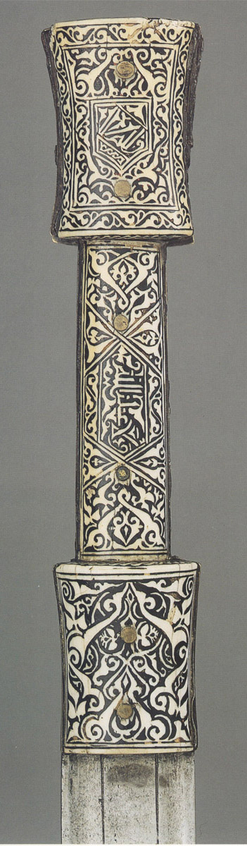

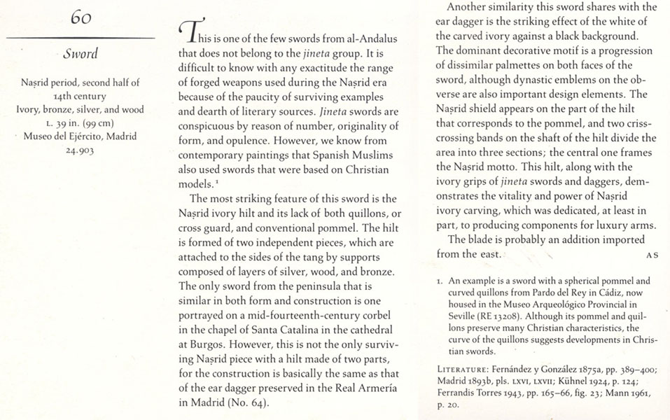

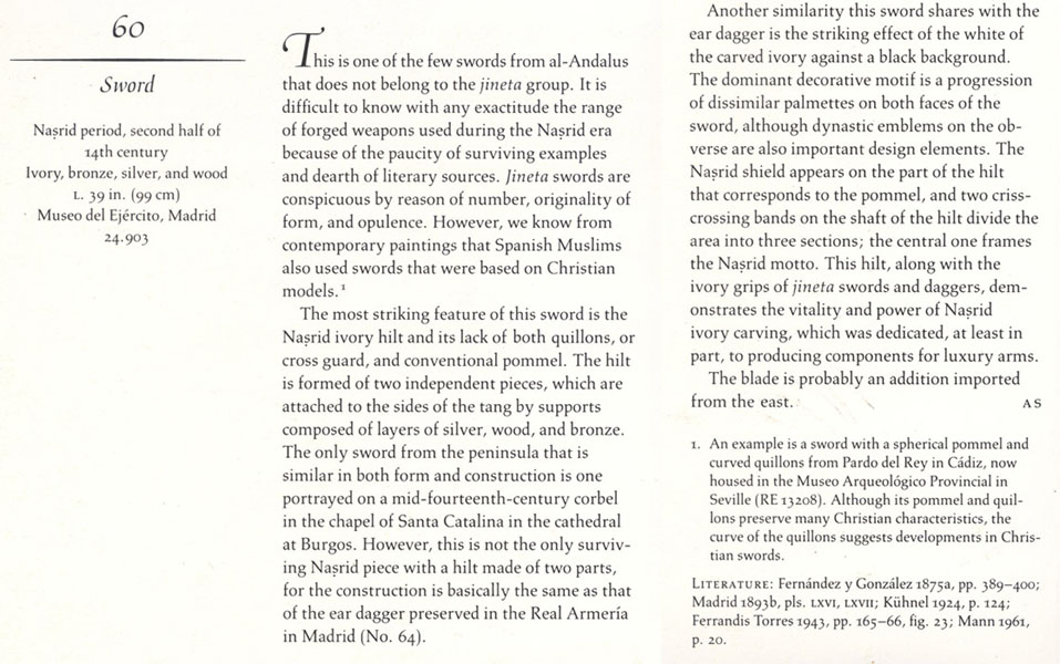

See attached, from the book "Al-Andalus The Art of Islamic Spain" published by the Metropolitan Museum of Art.
Danny
 Attachment: 82.04 KB
 Attachment: 184.87 KB
 Attachment: 177.09 KB

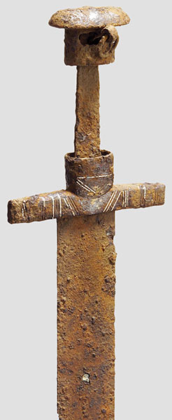

PostPosted: Thu 08 Jun, 2023 10:52 pm    Post subject:         Reply with quote
Ok, I'm reviving the post ...
It seems that, before West developed what Oakeshott and others called the "knightly sword", all the regions somewhat connected to the Roman Empire or close to it had the general idea of a Roman Spatha (btw, that's how "viking swords" were called in Catholic Europe during 8th century and so). That also applies to Arabia, Aegypto, Germania etc
https://www.facebook.com/1495309404114147/posts/ancient-roman-spatha-long-sword-iron-3rd-4th-century-ad-found-in-ratari-village-/2836555973322810/
This pair of 3rd-4th century spathae (78,1cm blade) found in nowadays Serbia put made in an active Roman city of the time, shows a cut-oriented sword that arguably just lacks the fuller we see in Medieval Swords, the earliest I could remember dates from this 6th century Frankish example, with poorly conserved blade:
https://www.metmuseum.org/art/collection/search/33513
The Roman Spathae shown doesn't look much different from the lenticular blades shown here. If we accept the idea that fullers were a Western European invention, then it makes sense for why swords from Levant, Egypt and Arabia were generally not using them until we see some examples of fullered swords, the earliest I can remember was found in Spain during the Islamic Period (which for my is just a re-hilted "viking" sword into a islamic styled hilt):
A discussion about it with other examples:
https://www.facebook.com/groups/444864076083475/permalink/1338755490027658/
I have accepted the theory, so often repeated, that sabers were introduced in Muslim World through the Turks (which also either introduced or gave more popularity to sabers in Byzantine Empire). Even though, as these examples show, they didn't supplanted straight swords immediately or at all.
It seens the Muslims were somewhat conservative in the shape of their blades, cut-oriented, being either fullered or un-fullered lenticular blades, but I have seen here and elsewhere many examples of large blades, by far surpassing the typical wideness of viking swords (mostly 6 cm at base, but we sometimes see 5,7 to 5,9cm, and rarely 5,4; 5,6 and even 5cm wide blades.
Some Iberian-Christian swords have Andalusian influences as well, like the Sword of Saint Ferdinand or Sword of Alfonso X, a 13th century one handed sword with wide blade and short guard (BL 8,8 cm; W. 7,3cm):
https://www.facebook.com/groups/213194419602681/permalink/285043179084471/
Many crossguards also resemble this short (65cm blade) but wide 10th-11th eastern proto-longsword in an auction, whose dimmensions I would like to know better.
https://sword-site.com/thread/922/hander-byzantine-sword?fbclid=IwAR3fl740v1eCJhE57FbcoUmuVdvtuoUSHsWIZf4rKOegzPoMmqKkertTXEk
These hilts were found in places like Romania, Bulgaria and Ukraine or Russia, so it seens the hilting in Byzantine and Muslim worlds were not so different at all.
